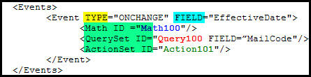

Configure an Event
The events section identifies the type of event that needs to occur to invoke a set of actions. It also identifies the field that is connected to the event.
The available event types that can invoke an action are:
  • ONLOAD: runs the event on the initial load of the screen.
  • ONCHANGE: runs the event when a trigger field is changed. OnChange will recognize a change to the specified field's value but not a change to its currency code.
  • ONSUBMIT: processes the event when the final submission on the screen is selected.

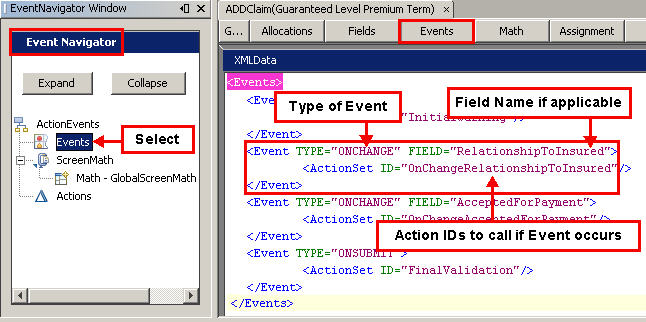

Steps to Configure an Event
Events can be configured directly in the XML using the XML Source pane or they can be configured in the Events pane with the help of visual configuration tools. The Events pane also provides a way to see the individual parts of Events and Actions configuration without the additional transaction XML. Click an Action from the Event Navigator window to the left of the Configuration Area to add the opening tag to the configuration. If configuration already exists for the Action or Event, that configuration will display in the Event pane.
  1. Check-out the transaction, segment or business rule's XML file.
  2. Click the Events tab. The Event Navigator window will open.
  3. Double-click the Events node. The opening tag for Events will display in the Configuration Area.
  4. Configure the event. Identify the event TYPE and, if applicable, the FIELD that the event applies to.
  5. Configure any combination of Math, ActionSets and/or QuerySets. Each action ID attribute must have a matching action.
  6. Check-in the file to save the changes to the database.
Events and Actions XML sample
Events XML
Event XML Sample
Event TYPE, FIELD and IDs

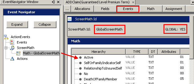

Steps to Configure Screen Math
  3. Right-click the Screen Math node and select New Math Section.
  4. Enter the Section ID, which is the name of the ScreenMath.
  5. Check the Global box if the math being configuring is global math.
  6. Select Finish.
  7. Configure the math section by dragging and dropping math variables from the Palette window.
  8. Check-in the XML file to save the changes to the database.
ScreenMath
Global Screen Math on Events Pane

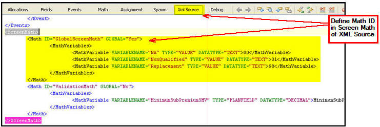

Important: View the ScreenMath XML from the XML Source pane. See image below.
Screen Math Viewed from XML Source Pane
Screen Math XML from XML Source Pane

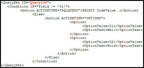

QuerySets
QuerySets allow combo boxes to load with a SQL statement, as well as define a set of hard coded combo box options. <QuerySet> is a sub-element of <Actions> and each <QuerySet> is identified with an ID attribute that the <Event> section uses to locate the correct configuration.
When configuring the change of combo box data, make sure to use the FIELD attribute in the corresponding <Event> section for the trigger field. In the <QuerySet> sub-element use the FIELD attribute for the field that will have its data changed.
Conditional logic can also be written in this section.
  • Compare single values by writing expressions. Please see the V9 XML Configuration topic in this help system for a list of all elements, attributes and values needed for configuration. View Common Elements | Operations Available for Expression Writing.
  • Use available functions.
  • Use Global and Local math (Must use MathID prefix).
  • Compare dates.
QuerySet XML Sample
QuerySet XML
Steps to Configure Action with QuerySets
