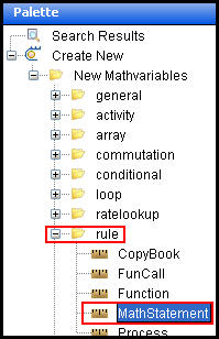

MathStatement
The MathStatement math variable is a type of system function that is similar to the existing type FunctionCall. Unlike business rule functions, functions called by the MathStatement exist in the base code; however, the Rules Palette guides the configuror through the available functions and the required parameters for each function.
MathStatement will not appear in the math tab of the Activity Results screen. Valuation objects created by MathStatements will not write valuation records to the data base.
mathstatement math variable
MathStatement Math Variable in Palette Window

Define the MathStatement
Drag and drop the MathStatement function from the Palette window onto the Math Pane. Enter the following information for the MathStatement.
