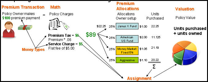

High Level Valuation Steps

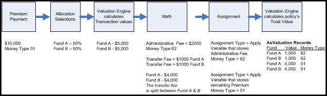

High Level Work Flow Diagram
