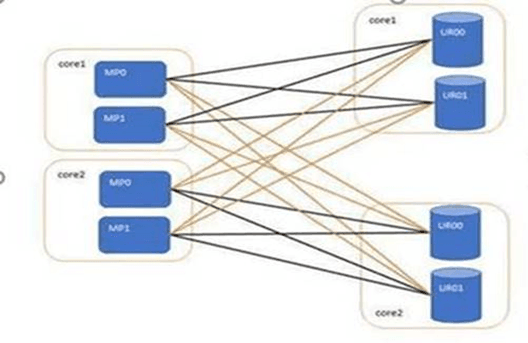

Figure 3-1 Priorities for Connection Group
Operator can add UDR connected with primary route in the highest priority Connection Group. For redundancy, the other UDR can be added in other connection groups.
These priority values are hardcoded through the loader and cannot be modified. If all UDRs are added to the same Connection Group, then the load is shared between these UDRs.

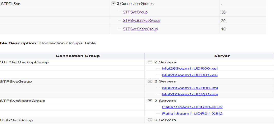

For example:
To configure the IMI as the priority route, the UDR connected with this Interface must be added in STPSvcGroup (highest priority) Connection Group.
The UDR connected with another Interface(XSI2) can be added to another Connection Group (STPSvcBackGroup) for redundancy.
Figure 3-2 IMI as the Priority Route
