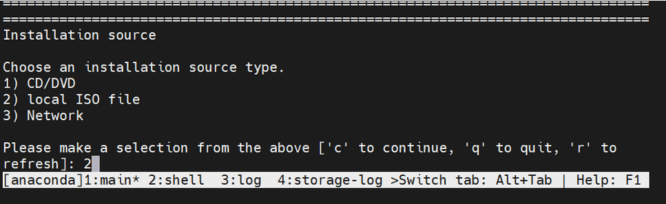

- Select a source type from the following installation sources:
- CD/DVD
- Local ISO file
- Network
Figure 5-2 Installation Source

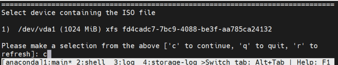

- Select a device containing the ISO file. After selection of ISO file,
the installation process initiates.
Figure 5-3 ISO File

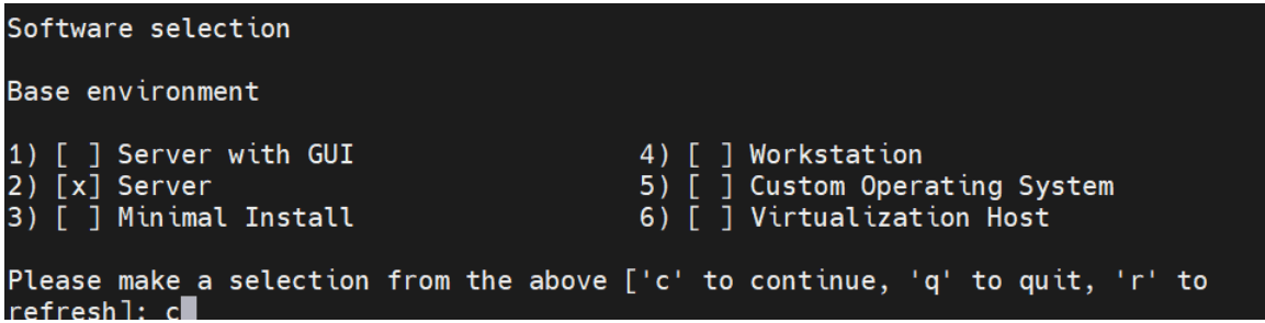

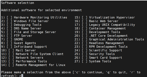

- Select a software from the following base environment:
- Server with GUI
- Server
- Minimal Install
- Workstation
- Custom Operating System
- Virtualization Host
Figure 5-5 Software Selection
- Select Additional Software for the selected
environment:
Figure 5-6 Additional Software

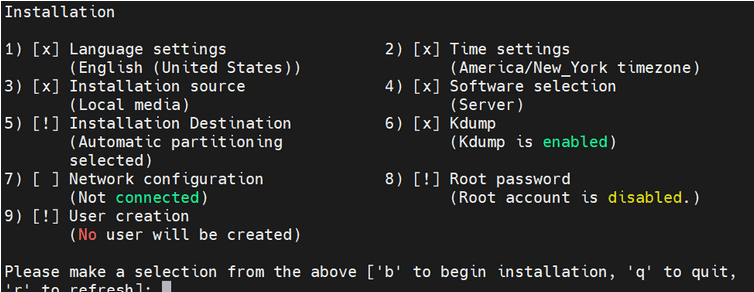

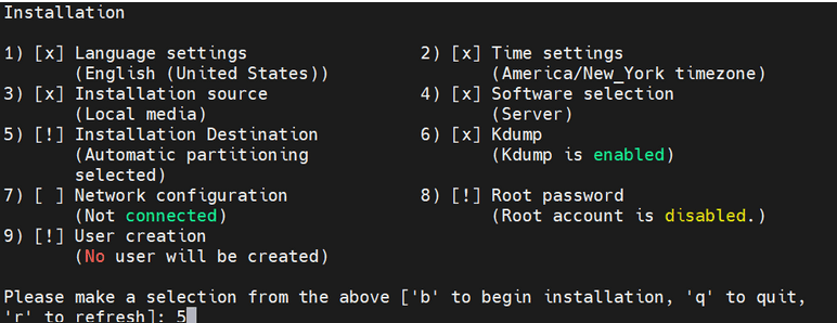

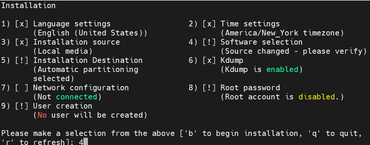

- Wait a moment for the processing to complete, then press "r" to refresh and confirm that step 4 is marked as complete.
Figure 5-7 Installation

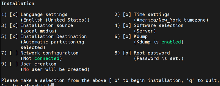

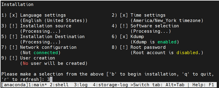

- Proceed with the next steps, and once all the steps are marked with
[x], press "b" to start the installation.
Figure 5-8 Installation

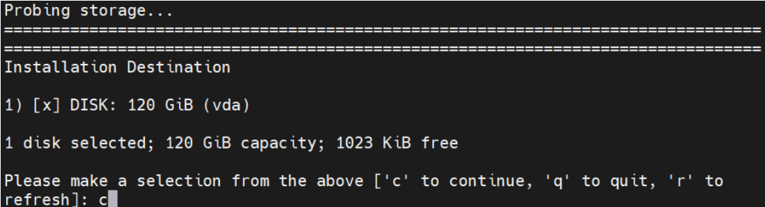

Installation Destination is selected during the probing storage.
Figure 5-9 Probing storage

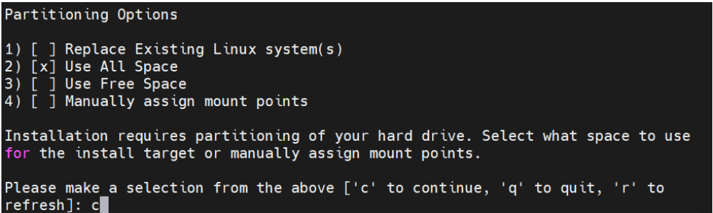

- For partitioning options, select the space to be used for the install
target or manually assign mount points.
Figure 5-10 Partitioning Options

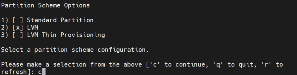

- Select a Partition Scheme Configuration from the following options:
- Standard Partition
- LVM
- LVM Thin Provisioning
Figure 5-11 Partitioning Scheme Options

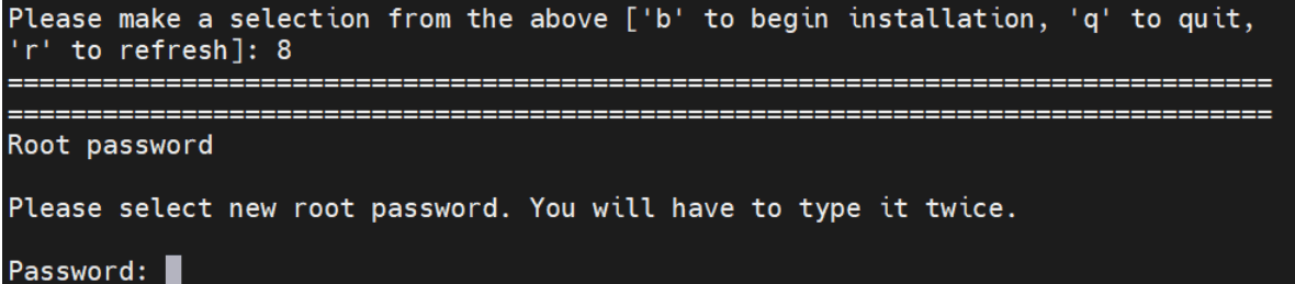

- Set a strong password for the root user and confirm.
Figure 5-12 Set password for root user
After selection of the password, the installation procedure initiates.
Figure 5-13 Begin Installation

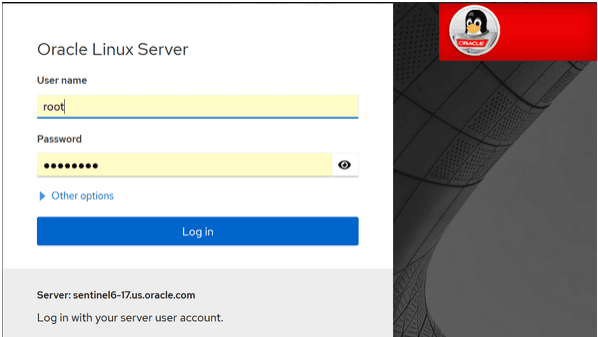

- Log in to the host machine with a valid username and password.
Figure 5-15 Login Page

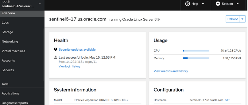

After signing in, the system will automatically open the Overview page.
Figure 5-16 Overview

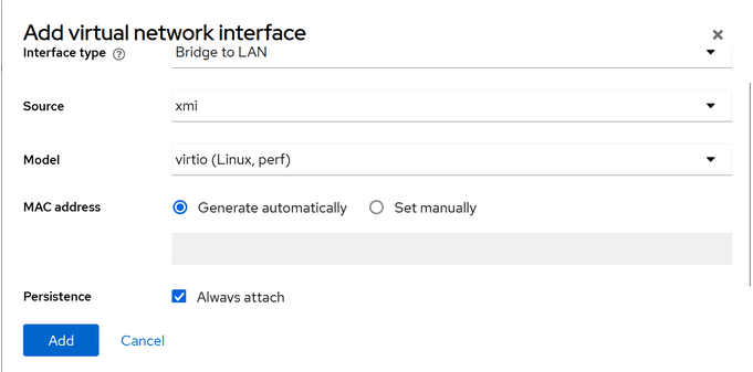

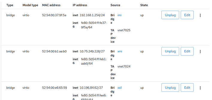

- Click Virtual machines and search for the
idih-mysqlVM. Go to Network interfaces section, click Add Network Interface, select value as shown in the following screenshot, and click Add.Figure 5-17 Add Virtual Network Interface
- Apply the same process to the IMI and XSI interfaces. The following
screenshot displays all the interfaces.
Figure 5-18 Interfaces

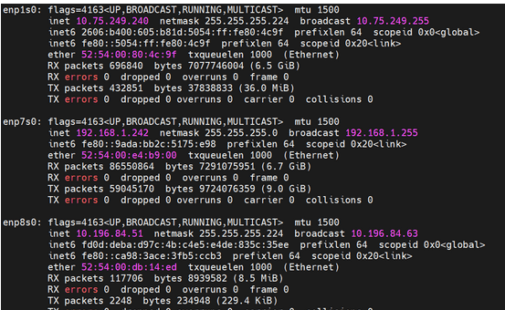

- Run
ifconfigcommand and take a note of device names -enp1s0, enp7s0, and enp8s0. Here, enp1s0 represents xmi, enp7s0 represents imi, and enp8s0 represents xsi. - Run the following command, it will display the status as "disconnected"

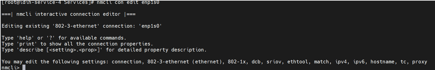

.nmcli dev up enp1s0 - After the device is up, re-run the following command. Prompt must be
visible as shown in the below screenshot:
nmcli con edit enp1s0. nmcliFigure 5-19 Prompt

onboot=yesin the following/etc/sysconfig/network-scripts/ifcfg-enp1s0ile. - Restart the VM and check if IP addresses are assigned with help of
ifconfig.Figure 5-20 ifconfig

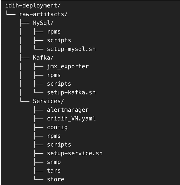

The installation TAR file can be downloaded on any of the three VMs. After downloaded, extract (untar) the TAR file.
Directory Structure
After extraction, the directory structure will appear as follows:
Figure 5-21 Directory Structure
Deployment of Components Across VMs
Distribute the extracted directories to their respective VMs as follows:
- Copy the MySql directory to the MySQL VM at any preferred location.
- Copy the Kafka directory to the Kafka VM at any preferred location.
- Copy the Services directory to the Services VM at any preferred location.
