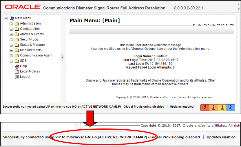

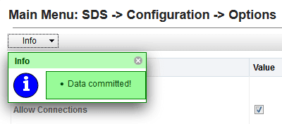

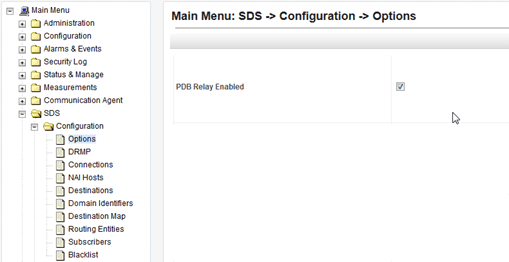

4.3 Enabling Global Provisioning Perform the following steps on Primary NOAM VIP to enable Global Provisioning at the newly promoted Primary NOAM GUI. Launch an HTML5 compliant browser and connect to the XMI Virtual IP address (VIP) assigned to Primary Active NOAM site.If a Certificate Error is received, click on Continue to this website (not recommended) link. Figure 4-9 Certificate Error The login screen appears. Log in to the GUI using a user account with administrator privileges. Figure 4-10 Login Screen The Product Main Menu appears. Verify that the message shown across the bottom of the panel indicates that the browser is using the VIP to connect to the ACTIVE NETWORK OAM&P. Figure 4-11 Main Menu Go to Main Menu, and then Status & Manage. Then, select Database. Figure 4-12 Main Menu - Database Select Enable Provisioning at the bottom of the right panel. Click OK on the pop-up confirmation box. Verify that the dialogue button located at the bottom of the right panel changes text to Disable Provisioning. To enable PDB Relay, go to Main Menu, then Configurations, and then Options. Then, check the PDB Relay Enabled option box. Click Apply. The following confirmation message is displayed. Note:Post completion of this procedure, return to Figure 2-1.
