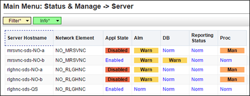

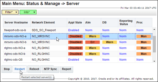

Site_1 = Primary_NOAM (Active) = _________________________ Site_1 = Primary_NOAM (Standby) = _________________________ Site_2 = DR_NOAM (Active) = _________________________ Site_2 = DR_NOAM (Standby) = _________________________ - Go to Main Menu, and then Status & Manage, and then Server.
Based on the information recorded in Step 10 of this procedure, perform the below sub-steps on the newly promoted Primary NOAM Active Server (Site_2).
- Select the Server in the right panel (highlight will occur) and
click Restart in the right
panel.
Click OK in the pop-up confirmation box.
- After the screen refresh, verify that the server now shows an
Appl State value of
Enabled and a Proc value of
Norm.
