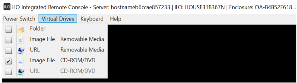

  1. Mount virtual media contains Oracle Linux OS software.
    Follow steps defined in Mounting Virtual Media on Blade:
    • Open the ILO.
    • Attach the OEL 7.7 ISO in ILOs virtual drives->Image File CD/DVD ROM.
    To mount the Oracle Linux OS software ISO from ILO GUI:
    • Navigate to Virtual drives, and then Menu.
    • Click on Image File, then select image from folder.
      Virtual

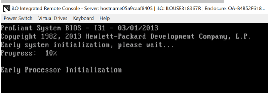

  2. Reboot host, log in to Blade Server ILo GUI browser page and launch remote console.
    To reboot host:
    Click Power Switch and select Reset from the dropdown menu.
    Reboot
    The remote console window displays that the host is rebooting.
    Remote console
    Wait for a couple of minutes for reboot to complete.

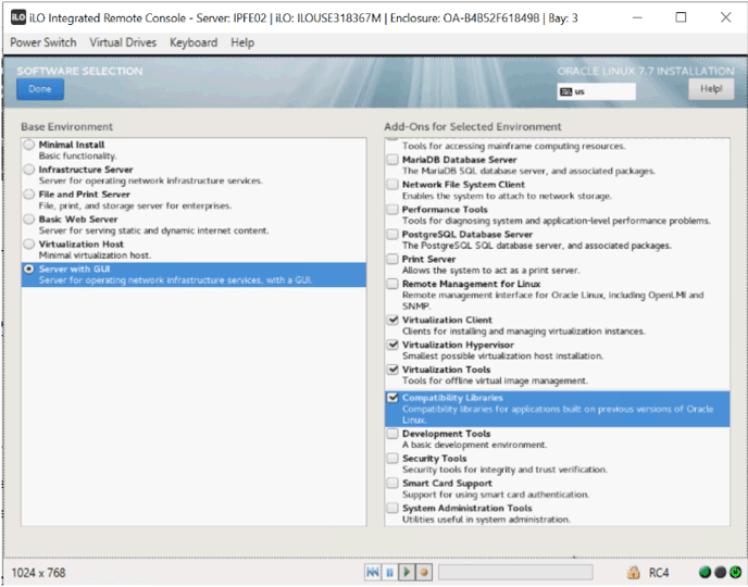

  6. Setup installation base environment.
    Click SOFTWARE SELECTION options in the SOFTWARE area. Select Server with GUI from the Base Environment area, and ensure that the following add-ons are selected:
    • Virtualization Client
    • Virtualization Hypervisor
    • Virtualization Tools
    • Compatibility Libraries
    selection
    Click Done to save the changes and go back to the main configuration page.

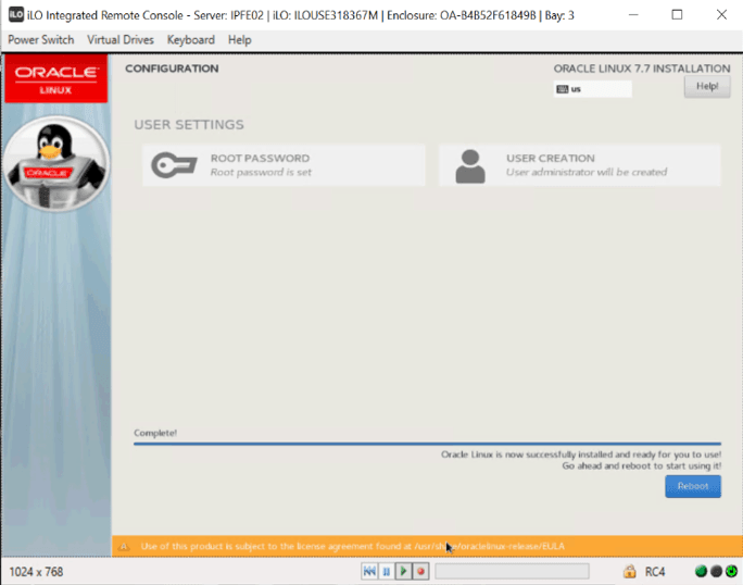

  10. Reboot host after installation completed.
    Wait for the installation to complete, until the following screen appears.
    Reboot
    Click Reboot button to reboot.

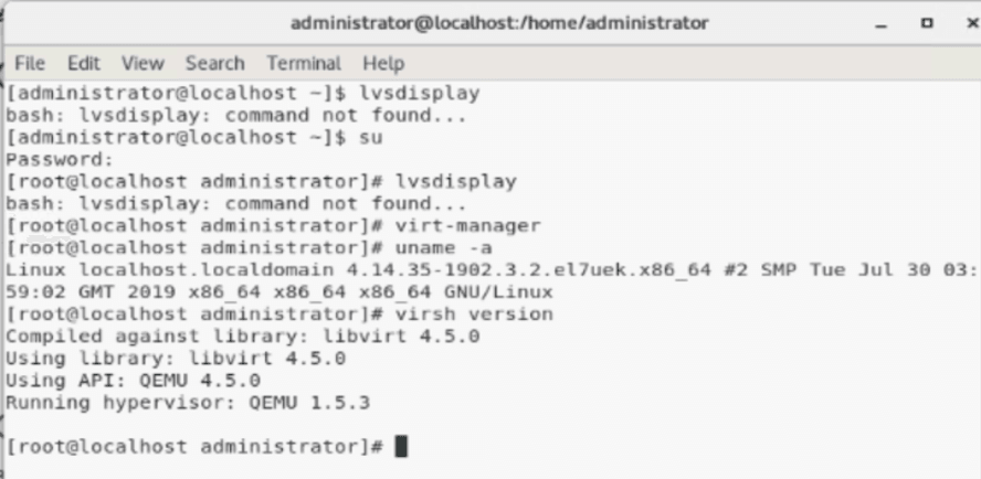

  12. Verify kernel version and KVM version.
    Open SSH console window and check following:
    SSH console

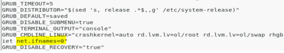

  13. Change network interface name pattern to ethx.
    Edit /etc/default/grub to append 'net.ifnames=0' with option GRUB_CMDLINE_LINUX:
    [root@localhost ~]# cat /etc/default/grub
    command
    Recreate the grub2 config file by running:
    grub2-mkconfig -o /boot/grub2/grub.cfg
    Restart host and verify that the network interfaces have ethx name pattern, by running:
    shutdown –r

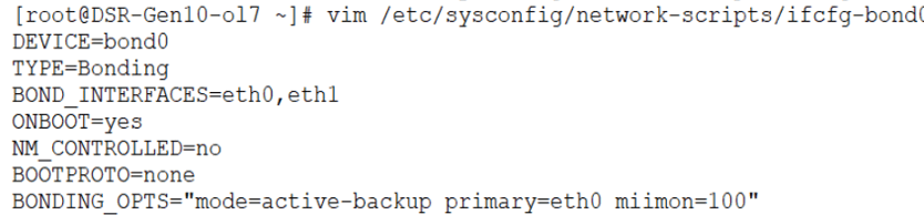

  14. Create bond0 device.
    1. Create device bond0 configuration file:
      vim /etc/sysconfig/network-scripts/ifcfg-bond0
      command
      Save the file and exit.

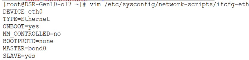

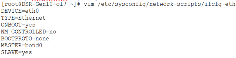

    2. Create device eth0 configuration file.
      vim /etc/sysconfig/network-scripts/ifcfg-eth0
      command

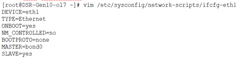

    3. Create device eth1 configuration file.
      vim /etc/sysconfig/network-scripts/ifcfg-eth1
      command

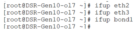

    4. Bring up devices into services.
      command

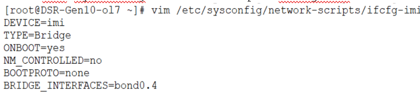

    2. Create imi device configuration file.
      vim /etc/sysconfig/network-scripts/ifcfg-imi
      command
      command

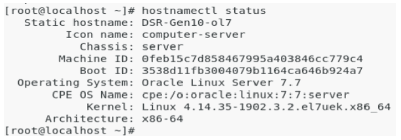

  19. Set host name.
    1. Rename host by modifying /etc/hostname file.
      cmd
    2. Review host name change with following command.
      cmd

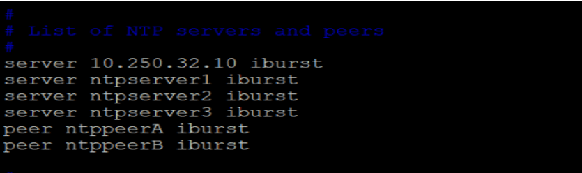

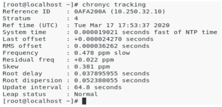

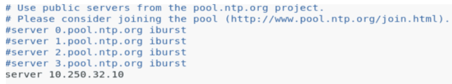

  20. Set NTP service.
    1. Modify /etc/chrony.conf, comment out all server * entries and append your NTP server IP to the list with prepending 'server ' text:
      cmd
    2. Force ntp to sync with newly added server:
      • $ ntpdate 10.250.32.10
      • $ timedatectl
      • $ chronyc tracking
    3. Verify time synced.
      cmd

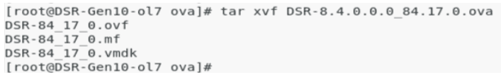

  23. Untar the ova file.
    cmd

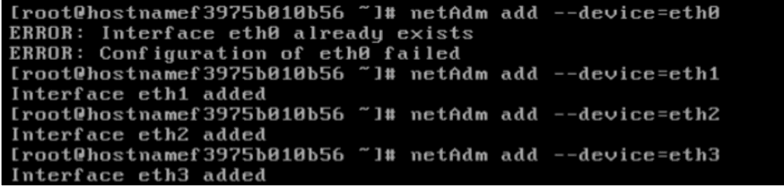

  33. Add the network device.
    Login to each VM created and add the network devices:
    NO:
    • netAdm add –device=eth0
    • netAdm add –device=eth1
    SO:
    MP:
    • netAdm add –device=eth2
    • netAdm add –device=eth3
    For example:
    cmd
    • eth0 is XMI
    • eth1 is IMI
    • eth2 is XSI1
    • eth3 is XSI2 (create eth3 if XSI2 is required)

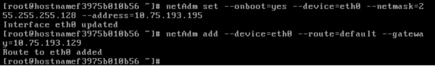

  34. Configure XMI network address.
    Set XMI network address for each DSR VM:
    netAdm set --device=eth0 --onboot=yes --netmask=<XMI_netmask> --address=<XMI_network_address>
    netAdm add --device=eth0 --route=default --gateway=<XMI_gateway>
    For example:
    cmd

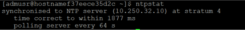

    4. Verify ntp status.
      cmd
