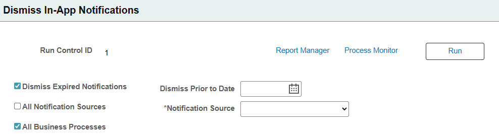

The system delivers the Dismiss In-App Application Engine (AE) process (EONC_DISMISS) that can be used to remove users' in-app notifications from both the Notifications panel and landing page sections as needed.
On the Dismiss In-App Notifications Page, administrators can run the AE process to delete in-app notifications that were sent before a specified date or those that have reached their expiration date (if an expiration date is available). They can set the AE process to remove notifications by notification source and business process specifically as well.
The AE process can be scheduled to run periodically using Process Scheduler to clean up expired or unwanted in-app notifications if necessary.
EONC_DISMISS_RC
Specify process parameters for clearing users' in-app notifications.

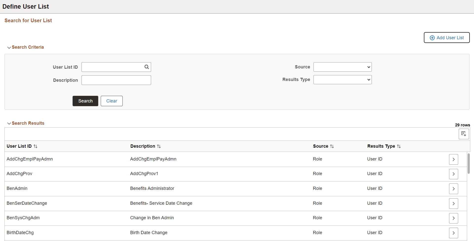

Use the Define User List page (EONC_UL_SRCH_FL) to maintain user lists and add new lists. User lists can be used to define notification recipients.
Navigation:
Enterprise Components > Notification Composer > Define User List > Define User List
This example illustrates the fields and controls on the Define User List page.
Field or Control
Description
Add User List
Select this button to access the Add New User List Page and create a new user list.
Search Criteria
Enter search criteria to find existing user lists. You can search by User List ID, Source, Description, and Results Type.
Search Results
The Search Results displays existing user lists based on your search criteria. For an understanding of each column, see field definitions for the Add New User List Page.
Select a user list row to view or edit user list details on the User List Details page.
Note: The User List Details page (EONC_UL_EDIT_SCF) and Add New User List Page layouts are almost identical. The only difference is that the User List Details page also includes the last updated date and time, and updated by information of the user list.

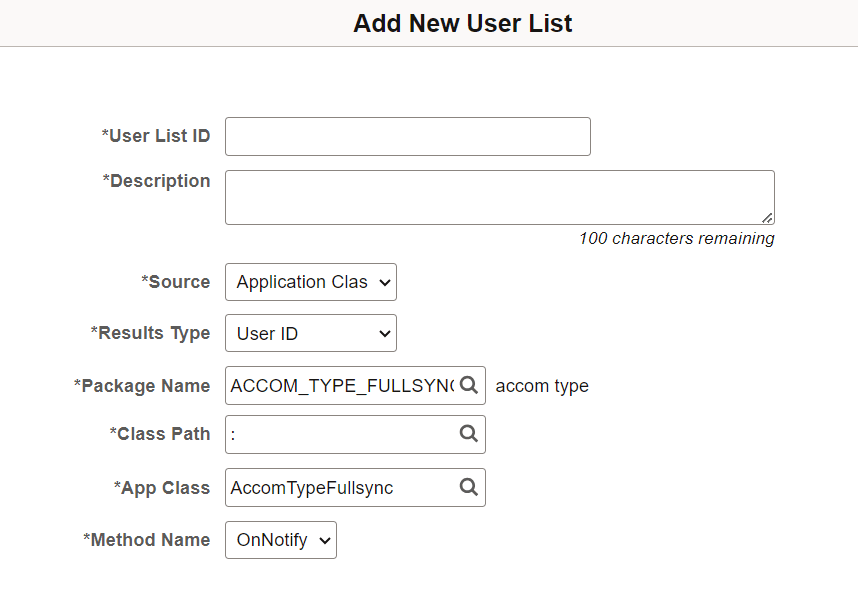

Use the Add New User List page (EONC_UL_ADD_SCF) to create user lists that can be used to define notification recipients. Some fields on the page are generated dynamically based on the Source field value.
Navigation:
Select the Add User List button on the Define User List page.
This example illustrates the fields and controls on the Add New User List page.
Field or Control
Description
User List ID and Description
Enter a short and long description for the user list.
Source
Select a source from which you will create the user list. Supported sources are:
  • Application Class
  • Role
  • Role Query
  • SQL Definition
When you select a source value, the fields on the page change dynamically. See the sections that follow to view the additional fields that appear with each Source option.
Results Type
Select a results type for the user list. The results type determines the type of contact information the source returns:
  • Email Address
  • Phone Number
  • User ID
Note: If you select Role or Role Query from the Source field, only User ID result type can be used.
Source: Application Class
The page displays these fields when you select Application Class for the Source value:
Field or Control
Description
Package Name
Enter the package (container) associated with the PeopleTools Application Class that is the source for the user list.
Class Path
Enter the directory path that defines the location of the PeopleTools Application Class that is the source for the user list.
App Class (Application Class)
Enter the PeopleTools Application Class to be used as a source for the user list.
Method Name
Enter the method (function) associated with the PeopleTools Application Class that has the logic to identify the recipients.

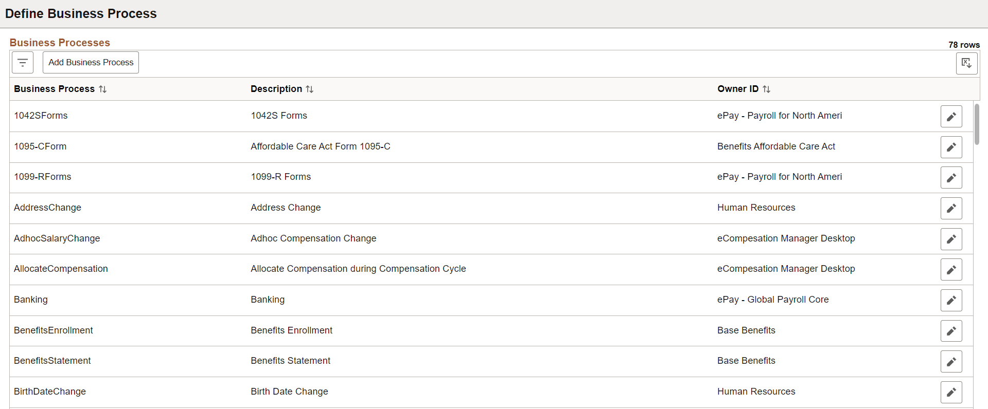

Use the Define Business Process page (EONC_BUS_PROC_FL) to maintain business process definitions and add new processes for Notification Composer. Business processes represent logical grouping of Notification Events.
Navigation:
Enterprise Components > Notification Composer > Define Business Process > Define Business Process
This example illustrates the fields and controls on the Define Business Processes page.
Field or Control
Description
Filters button (Business Process page)
Select this button to access the Filters page and enter parameters used to filter the list by a given business process, description, or object owner ID.
Add Business Process
Select this button to access the Add Business Process Page and add additional business processes for your Notification Composer configuration.
Edit button
Select this button to access the Edit Business Process page (EONC_BP_EDIT_SCF) and edit an existing business process definition.
Note: The Edit Business Process page and Add Business Process Page layouts are almost identical. The only difference is that the Edit Business Process page also includes the last updated date and time, and updated by information of the business process.
Delete
Select this button to delete the business process.
This button is available only for those business processes you created. You cannot delete a delivered system data event.

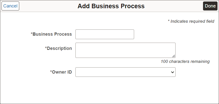

Use the Add Business Process page (EONC_BP_ADD_SCF) to add additional business processes for your Notification Composer configuration. Business processes represent logical grouping of Notification Events.
Navigation:
Select the Add Business Process button on the Define Business Processes Page.
This example illustrates the fields and controls on the Add Business Process page.
Field or Control
Description
Business Process and Description
Enter a short and long description for the business process.
Owner ID
Enter the application owner for the business process.
Done
Select this button to add and save the business process.
See the Define Notification Event Page.

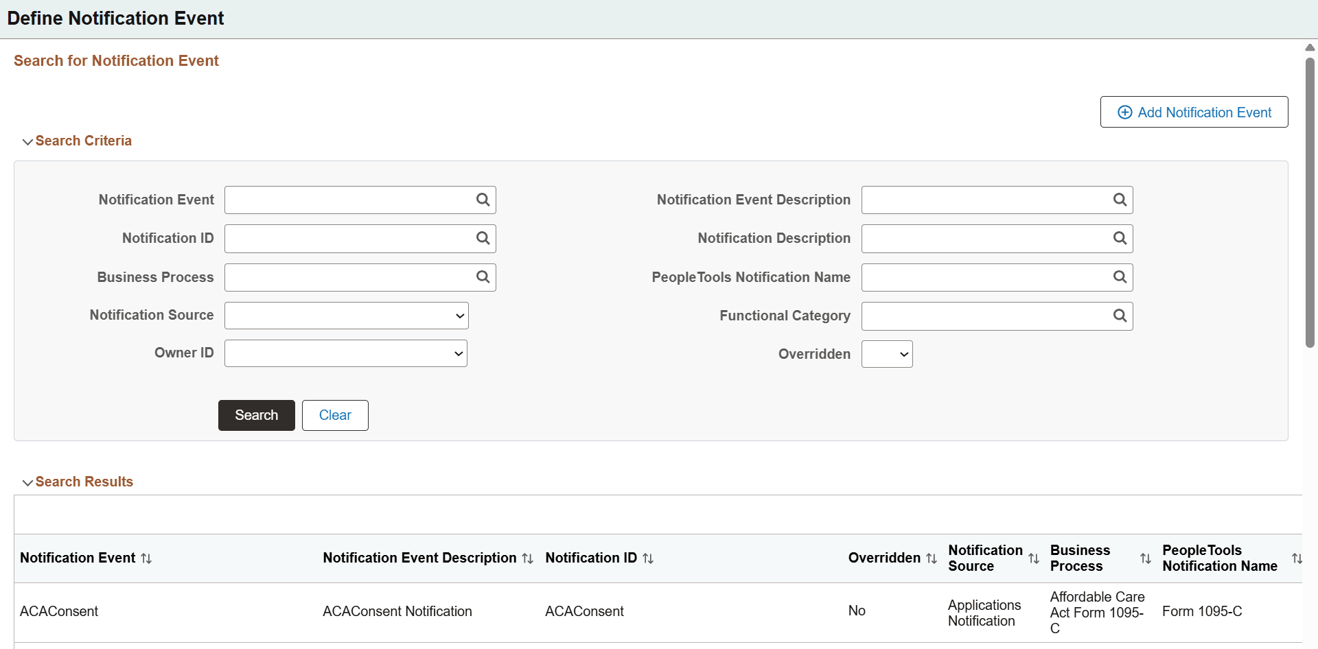

Use the Define Notification Event page (EONC_XREF_DEFN_FL) to manage existing notification events and create new events. Notification Events are events that occur within the context of a PeopleSoft application that trigger notifications, such as hiring an employee or adopting a baby. Notification Events map to theNotification ID, PeopleTools Notification Name, Functional Category, and Business Process.
Navigation:
Enterprise Components > Notification Composer > Define Notification Event > Define Notification Event
This example illustrates the fields and controls on the Define Notification Event page.
Field or Control
Description
Add Notification Event
Select this button to access the Add Notification Event Page and create a new notification event.
Search Criteria
Enter search criteria to find existing Notification Events. You can search by Notification ID, Business Process, Owner ID, PeopleTools Notification Name, and so forth.
Search Results
The Search Results displays existing Notification Events based on your search criteria. For an understanding of each column, see field definitions for the Add Notification Event Page.
Field or Control
Description
Overridden
Indicates whether the delivered Notification ID has been overridden with a new value.

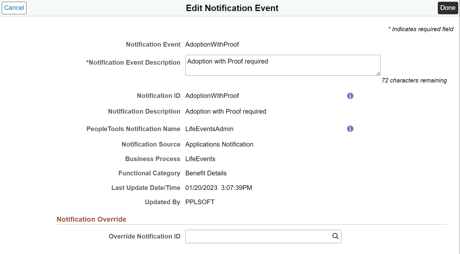

You can override the delivered Notification ID using the Edit Notification Event Page.
Edit button
Select this button to access the Edit Notification Event Page and edit an existing notification event.
Delete
Select this button to delete the Notification Event.
This button is available only for those notification events you created. You cannot delete a delivered system data event.

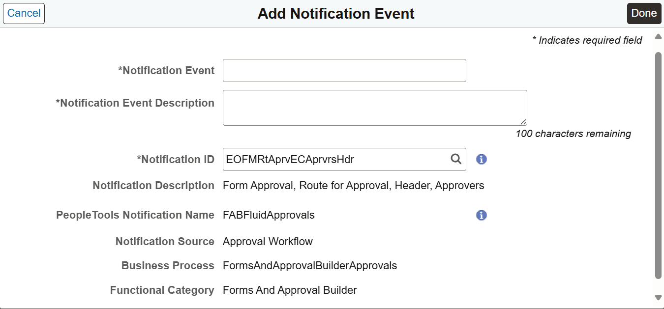

Use the Add Notification Event page (EONC_XREF_ADD_SCF) to create a notification event. Notification Events are events that occur within the context of a PeopleSoft application that trigger notifications, such as hiring an employee or adopting a baby. Notification Events map to the Notification ID.
Navigation:
Select the Add Notification Event button on the Define Notification Event page.
This example illustrates the fields and controls on the Add Notification Event page.
Field or Control
Description
Notification Event
Enter the notification event. This information is used as the Notification Event ID.
Notification Event Description
Enter a description for the notification event.
Notification ID
Enter a Notification ID for the event. The Notification ID helps identify the corresponding PeopleTools Notification, Notification Source, Business Process, and Functional Category.
After you enter the Notification ID, the corresponding PeopleTools Notification and Business Process fields display below.
You can select the adjacent blue Information icon to access the Notification Details page and view notification details, such as in-app, email, and text.
See Notification Details Page.
Notification Description
Displays the description of the notification.
Displays the PeopleTools notification name associated with this event. PeopleTools notification name is defined within PeopleTools Push Notification Framework.
You can select the adjacent blue Information icon to access the PeopleTools Notification Name Details page and view details specific to the PeopleTools notification name, such as delivery channel preferences and personalization authorization.
Notification Source
Displays the Notification Source associated with this event.
Business Process
Displays the Business Process associated with this event.
Business process is a logical grouping of Notification Events.
Functional Category
Displays the Functional Category associated with the PeopleTools Notification.

Use the Edit Notification Event page (EONC_XREF_EDIT_SCF) to modify an existing notification event.
Navigation:
Select the Edit Notification Event button on the Define Notification Event page.
This example illustrates the fields and controls on the Edit Notification Event page.
Use this page to modify the Notification Event Description or Override Notification ID values. For example, if you have cloned and modified a delivered Notification ID, use the Override Notification ID field to map to the cloned Notification ID.
Use the blue Information icons to access notification details.
Use the Dismiss In-App Notifications page (EONC_DISMISS_RC) to specify process parameters for clearing users' in-app notifications.
Navigation:
Enterprise Components > Notification Composer > Dismiss In-App Notifications > Dismiss In-App Notifications
This example illustrates the fields and controls on the Dismiss In-App Notifications page.
Field or Control
Description
Dismiss Expired Notifications
Select to dismiss in-app notifications (those with an expiration or end date) for all or specific notification sources and business processes that have already passed their expiration or end date.
Dismiss Prior to Date
Specify the date the process uses to determine which in-app notifications of all or selected notification sources and business processes to dismiss.
The process dismisses in-app notifications that were sent before this date.
All Notification Sources and Notification Source
(Default) Select to dismiss in-app notifications of all notification sources.
Clear this option to dismiss in-app notifications of a specific notification source that you select in the Notification Source field that appears.
All Business Processes, Business Process, and Business Process Description
(Default) Select to dismiss in-app notifications of all business processes.
Clear this option to dismiss in-app notifications of a specific business process that you select in the Business Process field that appears. Description of the selected business process is displayed in the Business Process Description field.
