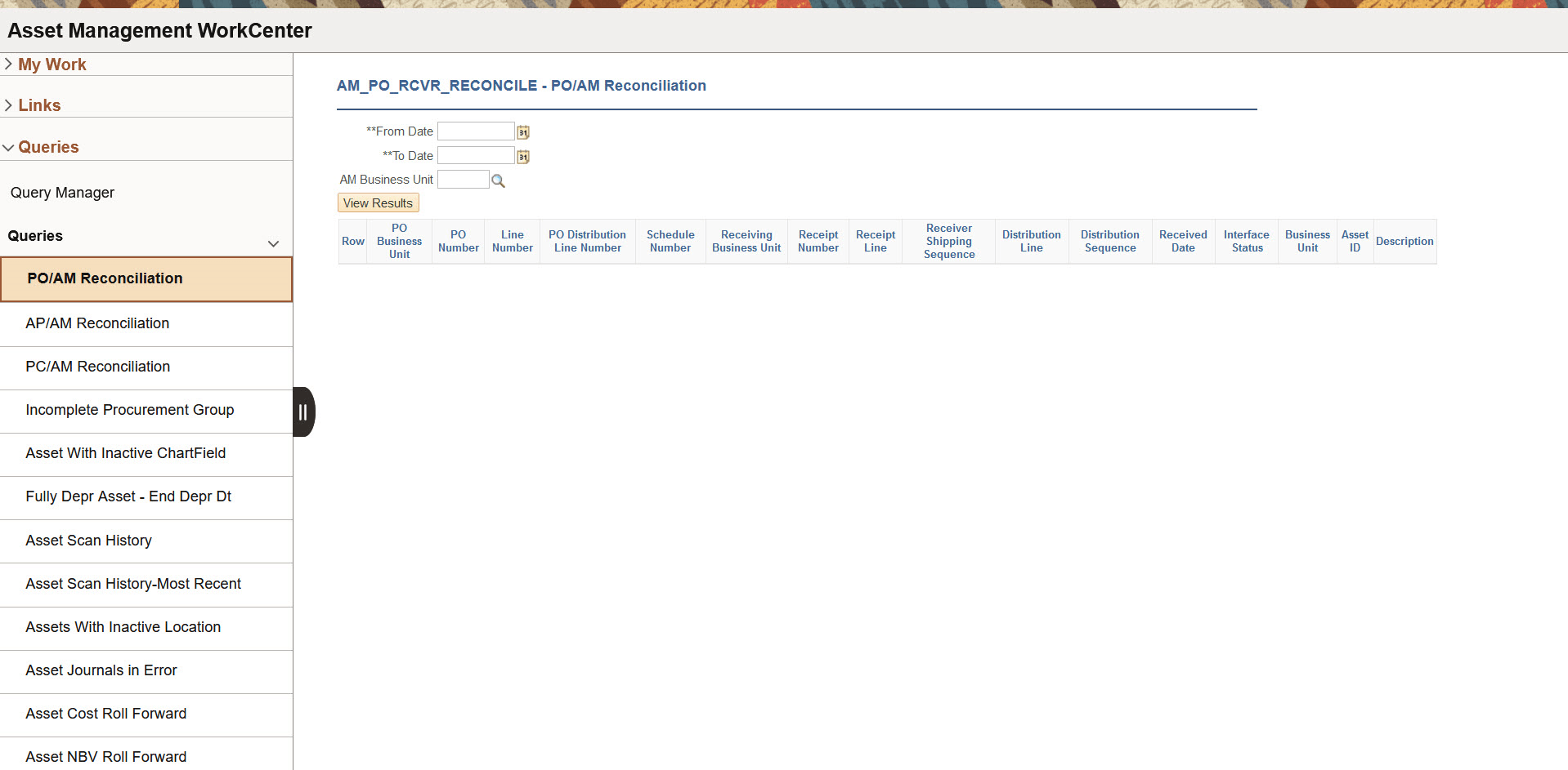

This example illustrates the fields and controls on the Queries Pagelet.
The Queries group includes links to the following queries:
Field or Control |
Description |
PO/AM Reconciliation |
Displays a purchase order or receiver related asset, that is not an asset in AM yet. |
AP/AM Reconciliation |
Displays a voucher related asset, that is not an asset in AM yet. |
PC/AM Reconciliation |
Displays a project related asset, that is not an asset in AM yet. |
Incomplete Procurement Group |
Displays pre-interface transactions already existing in the pre-AM table longer than the number of days entered as the procurement group is incomplete. |
Asset With Inactive ChartField |
Displays assets with inactive chartfields based on the date entered. |
Fully Depr Asset - End Depr Dt |
Displays fully depreciated assets based on the date entered and the asset’s end depreciation date. |
Asset Scan History |
Displays the entire scan history for assets, by business unit. |
Asset Scan History-Most Recent |
Displays the most recent scan history for assets, by business unit. |
Assets With Inactive Location |
Displays assets that are assigned to locations that are no longer active in PeopleSoft. Inactive locations can impact both physical inventory and maintenance. |
Asset Journals in Error |
Displays the list AM journals that are in error in GL. |
Asset Cost Roll Forward |
Displays roll forward asset data to assist with financial statements and tax reporting. The cost activity will be summarized by asset category. |
Asset NBV Roll Forward |
Displays the breakdown of asset net book value by category. |
