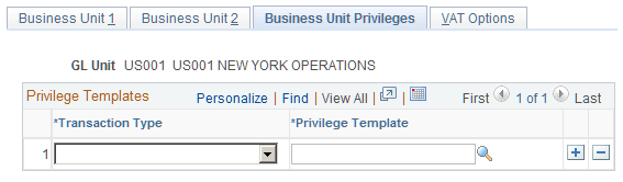

Business Unit Privileges Page
EX_BU_PRIV
Assign privilege templates to a business unit.

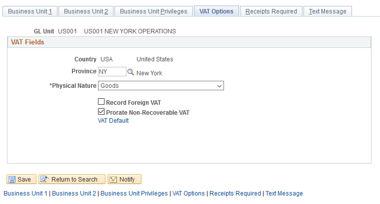

Expenses Definition - VAT Options Page
BUS_UNIT_TBL_EX3
Establish VAT parameters for the business unit.

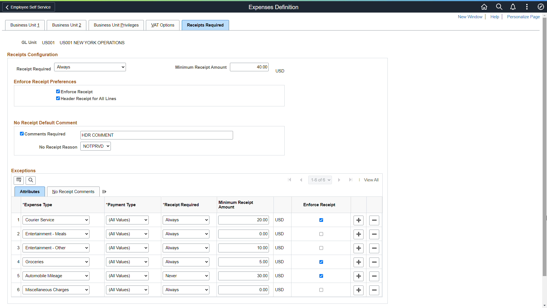

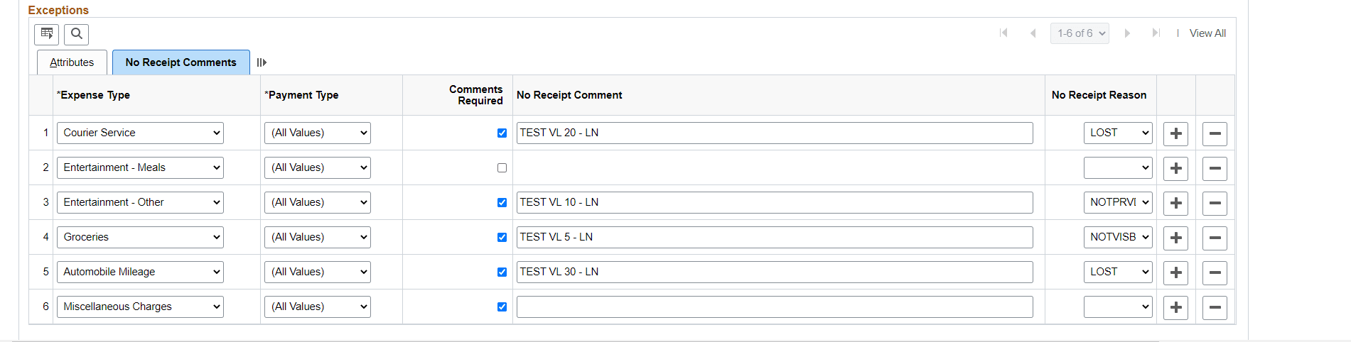

Receipts Required Page
BUS_UNIT_TBL_EX4
Determine expense receipt requirements for the business unit.

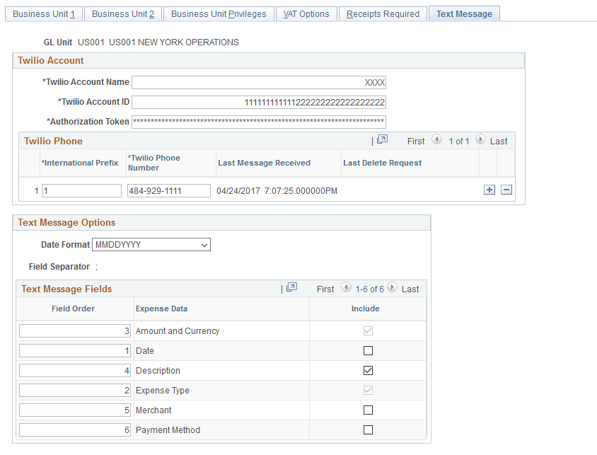

Expenses Definition - Text Message Page
BUS_UNIT_TBL_EX5
Allow organizations to setup a Twilio account and the text message format that should be used to send to Twilio.

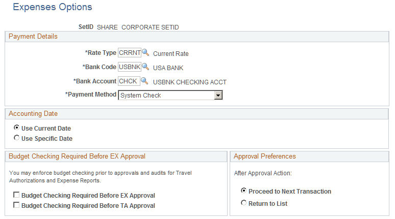

Expenses Options Page
BUS_UNIT_OPT_EX
Establish payment defaults, Commitment Control options, and approval preferences for a SetID.

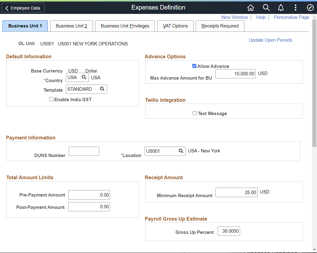

Use the Expenses Definition - Business Unit 1 page (BUS_UNIT_TBL_EX1) to define a PeopleSoft Expenses business unit.
Navigation:
Set Up Financials/Supply Chain > Business Unit Related > Expenses > Expenses Definition
This example illustrates the fields and controls on the Expenses Definition - Business Unit 1 page. You can find definitions for the fields and controls later on this page.
Expense Definition - Business Unit 1 (1of2)
Expense Definition - Business Unit 1 (2of2)
Field or Control
Description
Update Open Periods
Click to display the Open Period Update (OPEN_PERIOD_SINGLE) page and define open period beginning and ending dates for PeopleSoft Expenses that are different from open period date ranges in PeopleSoft General Ledger. This feature enables you to control the transactions created and submitted with a specific accounting date. The accounting date of the transaction is checked against the begin and end dates of the open period defined for the fiscal year to verify whether the transaction is eligible for submission.
Default Information
Field or Control
Description
Base Currency
Displays the primary currency for a general ledger business unit, which can have only one base currency.
Country
Select a country for PeopleSoft Expenses to use as the default country for the general ledger business unit. PeopleSoft Expenses refers to this field for VAT and distance rates.
Template
Select an accounting entry template that specifies what ChartFields to charge for accounting entries from your expense system.
Enable India GST
Select this check box to enable India GST for a Business Unit in Expenses. Once selected, all the Expenses functionality for India GST will be available to the users belonging to the business unit.
Advance Options
Field or Control
Description
Allow Advance
Select if this business unit uses cash advances. If this option is selected, enter a value in the Max Advance Amount for BU (maximum advance amount for the business unit) field. If you do not select the Allow Advance check box, the system prevents employees in this business unit from creating cash advances.
If you change the Allow Advance or Max Advance Amount for BU field, PeopleSoft Expenses automatically updates the employee profiles.
Twilio Integration
Field or Control
Description
Text Message
Select to allow an employee belonging to the business unit to send text message via Twilio.
If this check box is not selected, the Text Message tab will not be displayed on the Business Unit 1 page.
For more information on Twilio, see https://www.twilio.com
Payment Information
Field or Control
Description
DUNS Number
Dun & Bradstreet assigns this optional field for tracking purposes.
See .Obtaining D and B Credit Reports
Location
Select a business unit address to print on payment forms.
Total Amount Limits
Field or Control
Description
Prepayment Amount and Post-Payment Amount
Enter a maximum amount for an expense report. If the Amount Exceeded refinement is selected on the Approval Refinement Template page, PeopleSoft Expenses directs expense reports that exceed this amount to the auditor.
The prepayment amount applies to all approvers types before payment.
The system default is 0 for both fields, which means that no limits are placed on these values.
Change Expense Type from My Wallet Download
Field or Control
Description
Allow Changes to Expense Type
Select this check box to allow changing the expense type on the expense report for expense entries imported from My Wallet.
Require a Reason Code
Select this check box to set the requirement to enter a reason code on the expense report whenever an expense type is modified on expense entries imported from My Wallet.
Receipt Amount
Field or Control
Description
Minimum Receipt Amount
Specify the minimum expense amount for which a receipt is required. For example, if you enter 75 EUR, employees from this business unit must provide receipts for expenses over 75 EUR.
Note: This filed may be hidden if you are using the Receipts Required feature. For information about the Receipts Required feature, see Understanding Receipt Options for Expense Reports.

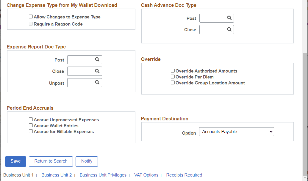

Expense Report Doc Type (Expense Report Document Type)
Field or Control
Description
Post, Unpost, and Close
If you use document sequencing, select a document type to generate document numbers for expense reports. If you do not require various sets of document numbers, use the same document type for all three processes.
Cash Advance Doc Type (Cash Advance Document Type)
Field or Control
Description
Post and Close
If you use document sequencing, select a document type to generate document numbers for cash advances. If you do not require various sets of document numbers, use the same document type for both processes.
Period End Accruals
Field or Control
Description
Accrue Unprocessed Expenses
Select to enable period end accrual processing for expense sheets.
Note: A journal generator template for period end accruals must be established on the Expenses Definition - Business Unit 2 page to enable this functionality.
Accrue Wallet Entries
Select to enable period end accrual processing for My Wallet transactions.
Accrue for Billable Expenses
Select to enable period end accrual processing for billable expenses.
Commitment Control for Accrual
Select to enable commitment control for accrual processing. When this option is selected, expense and encumbrance relief entries are created during the Period End Accruals process for PeopleSoft Expenses.
See Understanding Period End Accrual Processing for PeopleSoft Expenses.
Override
Field or Control
Description
Override Authorized Amounts
Select to allow anyone in this business unit to ignore location amounts associated with expense types.
If this option is not selected, employees in this business unit can enter amounts up to the authorized amount plus the benchmark tolerance for any expense type. If employees enter amounts above the authorized amount plus the benchmark tolerance, the system requires them to enter an exception comment.
Override Per Diem
Select to allow an employee in this business unit to enter any amount for an expense type that is a per diem expense type. If he or she exceeds the authorized amount plus the benchmark tolerance, the system requires the employee to enter an exception comment.
If this option is not selected, employees in this business unit can enter an amount up to the authorized amount plus the benchmark tolerance for an expense type that is a per diem expense type. If an employee tries to enter an amount above the authorized amount plus the benchmark tolerance, the system displays an error message.
Override Loc Amt Group
Select to allow anyone in this business unit to ignore location amounts associated with an expense type group. If this check box is not selected, employees in this business unit can enter amounts up to the authorized amount for any expense type group. If employees enter amounts above the authorized amount, the system requires them to enter an exception comment.
Disable DCAA (disable Defense Contract Audit Agency)
Select to disable the requirement to enforce DCAA audit requirements for a general ledger business unit.
Note: PeopleSoft Expenses displays this check box if DCAA Enabled is selected on the Installation Options - Expenses page.
Payment Destination
Field or Control
Description
Option
Select one of these options, which is used during the Stage Payments process:
For more information about the Stage Payments process, see Staging Payments.

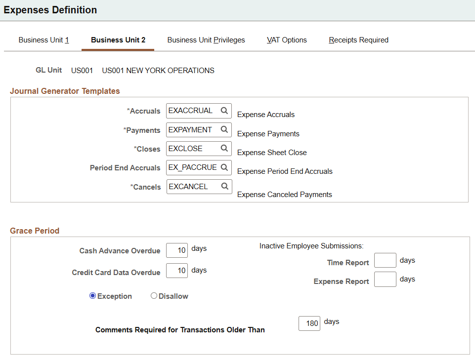

Use the Expenses Definition - Business Unit 2 page (BUS_UNIT_TBL_EX2) to designate business unit specifications for journal templates, time reporting, automatic approval thresholds, project time options, and grace periods.
Navigation:
Set Up Financials/Supply Chain > Business Unit Related > Expenses > Expenses Definition. Select Business Unit 2.
This example illustrates the fields and controls on the Expenses Definition - Business Unit 2 page (1 of 2). You can find definitions for the fields and controls later on this page.
Expenses Definition - Business Unit 2 (1 of 2)
This example illustrates the fields and controls on the Expenses Definition - Business Unit 2 page (2 of 2). You can find definitions for the fields and controls later on this page.
Expenses Definition - Business Unit 2 (2 of 2)
Journal Generator Templates
Select the templates for the business unit to use for accruals, payments, closes, period end accruals, and cancels. Your system may have different templates if you use different accounting entry journals for PeopleSoft Expenses. Use the Journal Generator Template - Defaults Page to define journal generator templates.
Note: The template that is selected for the Period End Accruals field cannot create reversal entries.
Grace Period
Establish the number of days after which employees must submit expense transactions for processing:
Field or Control
Description
Cash Advance Overdue
The default is 90 days. This number applies to cash advances that have not been processed and reconciled.
Credit Card Data Overdue
The default is 30 days. This number applies to credit card data loaded into the expenses system but not processed in an expense report.
Inactive Employee SubmissionsTime Report and Expense Report
Enter the number of days to allow an authorized employee to enter time reports or expense reports on behalf of an inactive employee. The number of days refers to the time since the employee became inactive (using employee status and action date). At submit time, PeopleSoft Expenses checks the employee status and action date. If the employee is inactive, PeopleSoft Expenses verifies whether the grace period has been exceeded and, if so, issues an error message to prevent further processing of the expense transaction.
Exception Comments Required for Transactions Older Than number of days
Select to indicate that transaction that are older than the number of days specified in the days field require the employee to enter a comment. The comment should explain why the expense transaction is being submitted after the number of days specified. If you leave the days field blank, then system does not check for this feature and does not require a comment, regardless of how long it has been since the transaction occurred. For more information about entering Exception Comments on Expense Reports, see Common Elements Used to Create or Modify Expense Reports
Disallow Transactions Older Than number of days
Select to indicate that your organization does not accept expense transactions that are older than the number of days specified in the days field. If you leave the days field blank, then system does not check for this feature regardless of how long it has been since the transaction occurred.

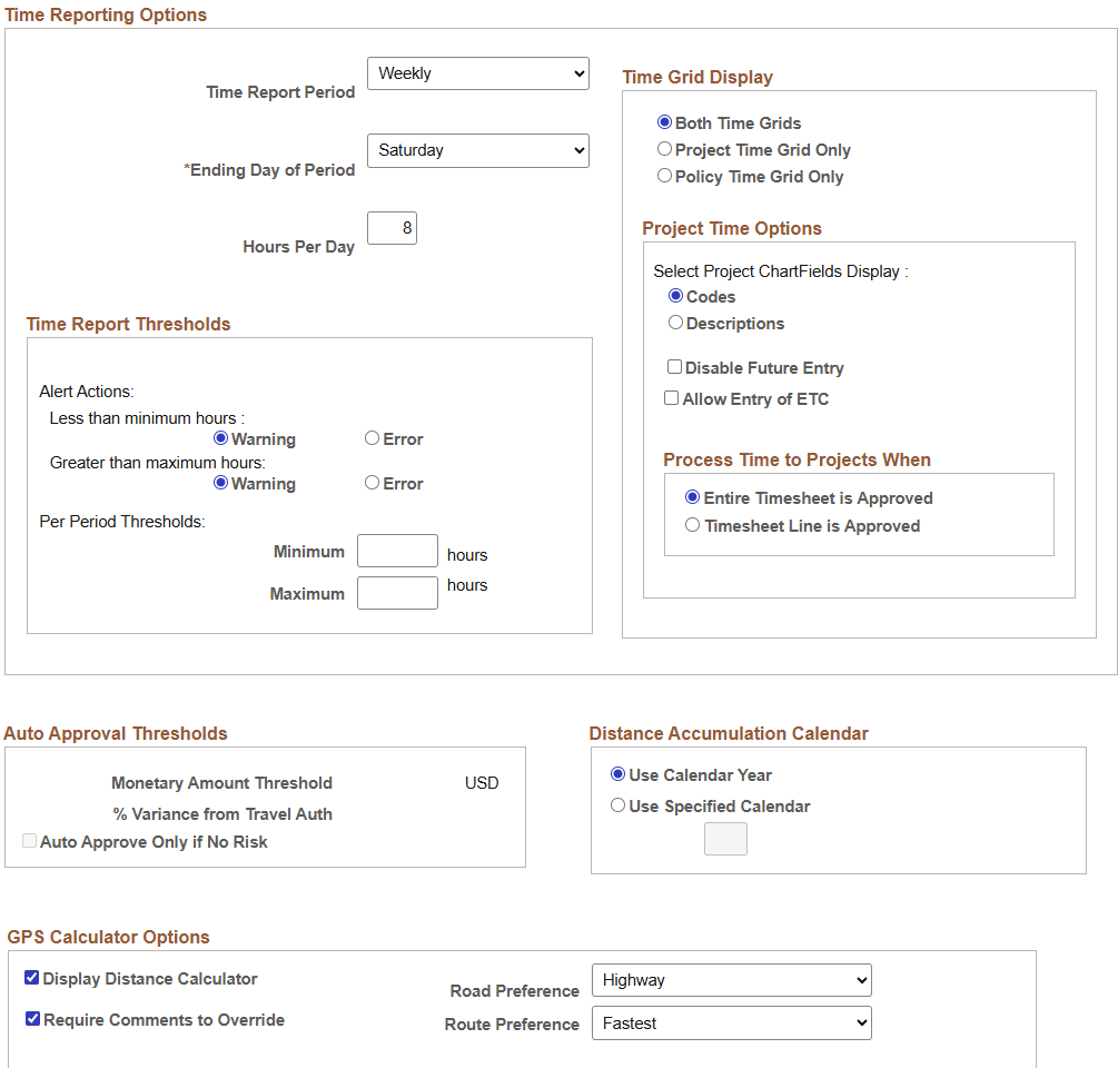

Time Reporting Options
Field or Control
Description
Time Report Period
Select the frequency with which employees in this business unit report their work hours. This parameter is used for time reports to determine the number of days to display for time entry. The default is Weekly; you can also select Daily, Bi-Weekly, or Semi-Monthly.
Ending Day of Period
The default is Friday. This field signifies the ending day for the time reporting period. This field applies only to weekly and biweekly time collection frequencies.
Note: If you use PeopleSoft Forecast Collection, the forecast collection ending day on the Forecast Configuration page must match this ending day.
Hours Per Day
Enter the number of hours that make up a work day for the business unit. The default value is eight, but the value can be overridden to enter a longer or shorter work day. When an employee enters his or her time on the Time Report Summary page, the system uses the value entered in this field to calculate the employee's overtime each day.
Time Grid Display
Select to display the project grid, the policy grid, or both on time reports. If you select to display the project or policy grid, PeopleSoft Expenses hides the other grid and the totals and functionality in the hidden grid will be inaccessible on time reports.
Project Time Options
Field or Control
Description
Select Project ChartFields Display
Select to display PeopleSoft Project Costing ChartField codes or descriptions on time reports.
Disable Future Entry
Select to prohibit employees in the general ledger business unit from entering time against projects on a time report that has not yet been worked.
Allow Entry of ETC (estimate to complete)
PeopleSoft Expenses displays this check box if PeopleSoft Program Management is installed. Select to enable employees in the general ledger business unit to view remaining work hours for their projects and enter a new estimate of hours to complete projects on their time reports.
If you do not select the check box, PeopleSoft Expenses does not display the Remaining Work and New Estimate fields on the Time Report Summary page.
Time Report Thresholds
Establish thresholds for PeopleSoft Expenses to issue warnings or error messages if employees submit time reports over or under the required number of hours for a time reporting period. You can set time reporting thresholds by general ledger business unit or by employee.
See Maintaining Employee Organizational Data.
Field or Control
Description
Alert Actions
Select to issue warnings or errors for employees who submit time reports that are less than the minimum number of hours or greater than the maximum number of hours for a time reporting period.
Per Period Thresholds
Enter the minimum and maximum number of hours for a time reporting period for PeopleSoft Expenses to use to issue warnings or errors.
Process Time to Project When
Use this section to indicate when time sheets can be sent to Project Costing when the Stage Time to Project Costing option is selected on the Expense Processes page.
Field or Control
Description
Entire Timesheet is Approved
Select to indicate that the system can send timesheets to Project Costing only when the timesheet is approved.
Entire Line is Approved
Select to indicate that the system can send timesheet lines to Project costing when an individual timesheet line is approved.
Note: If a timesheet line is approved and sent to Project Costing, the line will not be available to edit if the timesheet is sent back to the employee by a different approver.
If a timesheet line is approved and sent to Project Costing, and an approver tries to deny the timesheet report, then a message is displayed indicating that some lines have been sent to Project Costing and those lines cannot be denied.
For more information about expense processes, see Running Expense Transaction Processes

% Variance from Travel Auth (percent variance from travel authorization)
Enter a variance percentage for PeopleSoft Expenses to automatically approve expense reports created from travel authorizations. PeopleSoft Expenses calculates the difference between the expense report total amount and the travel authorization total amount as a percentage. If the percent difference is less than or equal to the percent variance, PeopleSoft Expenses automatically approves the expense report.
If you do not enter a percent variance, PeopleSoft Expenses does not automatically approve expense reports based on its variance from the travel authorization, even if you enabled the automatic approval functionality. If the amount of the expense transaction exceeds the variance, but is within the monetary amount threshold, PeopleSoft Expenses automatically approves the expense report.
Note: If PeopleSoft Commitment Control is enabled, PeopleSoft Expenses does not automatically approve expense reports if the option to require a valid budget checking status prior to approval is enforced and the budget status is set to require budget checking.
The Monetary Amount Threshold and % Variance from Travel Auth fields are not available if you disable automatic approval for all transaction types.
Field or Control
Description
Auto Approve Only If No Risk
Select to indicate that transactions can be approved automatically only when no risk is involved. The use of this option depends upon whether your business unit uses risk templates and you must enter a value in the Monetary Amount Threshold field.
See Setting Up Risk Templates for PeopleSoft Expenses.
Distance Accumulation Calendar
PeopleSoft Expenses enables you to accumulate automobile distance based on a fiscal or calendar year. When employees enter an automobile mileage expense on an expense report and specify the distance traveled, PeopleSoft Expenses looks at the calendar specified for the employees' business unit to determine which year to add the distance to.
When employees enter an expense date for an automobile mileage expense on expense reports and the distance rate is variable, PeopleSoft Expenses validates the date against the calendar that you establish on the Expenses Definition - Business Unit 2 page and updates the accumulated distance for the appropriate year.
Field or Control
Description
Use Calendar Year
Select to use the calendar year (January through December) to accumulate automobile distance.
Use Specified Calendar
Select to specify a detail calendar defined on the Calendar Periods page (DETAIL_CALENDAR1). The calendar that you specify determines how PeopleSoft Expenses accumulates automobile distance for employees within the business unit.
Warning! If you change options and employees in the business unit have accumulated miles or kilometers, PeopleSoft Expenses displays a warning that the change could invalidate the existing accumulated distance data.
GPS Calculator Options
GPS Calculator allows you to set the options to automatically calculate distance by capturing the starting and ending points for a trip. Once the distance is calculated, the trip is associated to a mileage reimbursement rate based upon mapping rules, and the amount is then calculated and the relevant expense line details are populated.
GPS Calculator uses Oracle Maps and eLocation Services to calculate mileage distance.
Field or Control
Description
Display Distance Calculator
Select to display the GPS Distance calculator in the Expense Entry Page and My Wallet page to automatically calculate the distance for mileage reimbursements.
Require Comments to Override
Select to indicate if comments are required when expense users makes changes to the calculated GPS distance in the Expense Entry Page.
Road Preference
Select an option to set the road preference. The option that is set here will be used by the GPS Distance calculator to calculate the distance.
Route Preference
Select an option to set the route preference. The option that is set here will be used by the GPS Distance calculator to calculate the distance.
Use the Expenses Definition - Business Unit Privileges page (EX_BU_PRIV) to assign privilege templates to a business unit.
Navigation:
Set Up Financials/Supply Chain > Business Unit Related > Expenses > Expenses Definition. Select Business Unit Privileges.
This example illustrates the fields and controls on the Business Unit Privileges page. You can find definitions for the fields and controls later on this page.
Use this page to assign a privilege template to a business unit for each transaction type.
Field or Control
Description
Transaction Type
Select a transaction. Options include Expense Report, Time Report, and Travel Authorization.
Privilege Template
Select a template for the transaction. This template is used as the default template for all employees in the business unit.
See Employee Privilege Template Page.
See Maintaining Employee Privilege Templates.
Use the Expenses Definition - VAT Options page (BUS_UNIT_TBL_EX3) to establish VAT parameters for the business unit.
Navigation:
Set Up Financials/Supply Chain > Business Unit Related > Expenses > Expenses Definition. Select VAT Options.
This example illustrates the fields and controls on the Expenses Definition - VAT Options page. You can find definitions for the fields and controls later on this page.
VAT Fields
Field or Control
Description
Physical Nature
Select Goods or Services for VAT treatment.
Record Foreign VAT (record foreign value-added tax)
Select to record foreign VAT on expense sheets, regardless of whether you enabled VAT at the business unit level. This is for customers who want to record and reclaim foreign VAT.
Prorate Non-Recoverable VAT (prorate nonrecoverable value-added tax)
PeopleSoft Expenses generates an accounting line for nonrecoverable VAT. If this check box is deselected, nonrecoverable VAT is charged to the nonrecoverable VAT account designated in the VAT code definition. When this option is selected, nonrecoverable VAT is charged as an expense to the general ledger ChartFields that are indicated in the expense report accounting detail page.
Allocate Non-Recoverable VAT (allocate nonrecoverable value-added tax)
If this option is selected, the accounting comes from the VAT template. If deselected, the accounting comes from the VAT accounting template.
Note: The Allocate Non-Recoverable VAT check box is active only if the Prorate Non-Recoverable VAT check box is deselected.
VAT Default
Click to access the VAT Defaults Setup page.
The VAT Default Setup page is a common page used to set up VAT defaulting for all PeopleSoft applications that are processing VAT transactions. On this page you can define the PeopleSoft Expenses business unit defaults, as applicable.
See Understanding VAT

This example illustrates the fields and controls on the Receipts Required page.
Receipts Required
This example illustrates the fields and controls on the Receipts Required page, No Receipt Comments tab.
Receipts Required - No Receipt Comments tab
Use this page to determine the minimum receipt requirements for the business unit, or for a combination of business unit, expense type, payment type, receipt required, and minimum receipt amount.
For additional information about receipt options, see Understanding Receipt Options for Expense Reports.
Note: The fields and sections that are available on this page are determine by the values selected in the Receipts Configuration section of the Installation Options - Expenses Page.
Receipts Configuration Section
Use this section to determine whether receipts are required for all expense reports at the header and line levels. If receipts are required, then enter the general rule to be used when requiring receipts. This should be the required parameters that apply to most expense lines for your organization.
Field or Control
Description
Receipt Required
Select an option that determines whether receipts are required for all expense reports in the business unit. This field appears when Header Level, Line Level, or Header and Line is selected in the Attachment Location field of the Installation Options - Expenses Page.
Options include:
  • Always: Select to indicate that a receipt is required for all transactions in this business unit.
  • Never: Select to indicate that receipts are not required for any transaction for this business unit.
    In addition, there are no receipt links on the Expense Entry page.
  • No Exc CC (no except for credit card feeds): Select to indicate that a receipt is not required unless the transaction is from a credit card feed.
  • Yes Exc CC (yes except for credit card feeds): Select to indicate that a receipt is required, but not if the transaction is from a credit card feed.
Enter an amount that determines the minimum amount that a receipt is required for each line.
If the amount of an expense line is greater than or equal to this amount, the system may require a receipt depending on the value selected in the Receipt Required field. Any amount that is less than this amount, does not require a receipt.
If a line amount exceeds this amount and a receipt is required, the system displays an error on the Expense Entry Page. See Understanding Expense Report Errors in PeopleSoft Fluid.
When the Receipt Required field is:
  • No Exc CC, then the Minimum Receipt Amount field only applies to expense lines that come from credit card feeds. If an expense line is entered manually, then the system does not require a receipt regardless of this amount value.
  • Yes Exc CC, then the Minimum Receipt Amount field only applies to expense lines that are entered manually. If an expense line comes from a credit card feed, then the system does not require a receipt regardless of this amount value.
  • Never, then this field is automatically set to zero and is not available to be changed.
The currency that appears next to this field comes from the base currency determine on the Expenses Definition - Business Unit 1 Page.
Enforce Receipt Preferences Section
This section appears only when Header Level or Header and Line is selected in the Attachment Location field of the Installation Options - Expenses Page.
Field or Control
Description
Enforce Receipt
Select to indicate that receipts MUST be attached to all expense reports when the Receipt Required value is Always. If a receipt is not attached, you can add a comment to explain why. If you do not attach a receipt or enter a comment, the system displays an error and you cannot submit the expense report.
Header Receipt for All Lines
Select to indicate that one or more receipts must be attached at the header level and optional at the line level.
No Receipt Default Comment Section
This section is active only when Header and Line is selected in the Attachment Location field of the Installation Options - Expenses Page.
Field or Control
Description
Comments Required (check box)
Select this check box to indicate that the employee must enter a comment if they don’t have a receipt for an expense line that requires a receipt.
When this option is selected, a user must enter a comment in the Exception Comments section on the Expense Entry page. If no comment is entered, the system provides an error.
Deselect when receipts are required but comments are not required from employees.
As an alternative, you can enter default text in the Comments Required field, which can be pulled into the Exception Comments section by the user. Exception Comments field for the system to pull in the default Comment (entered in the next, open text field) into the transaction. After viewing the default comment and selecting Done the error goes away.
Comments Required (open text field)
Enter default text that appears in the No Receipt Comment field of the Expense Entry Page. This text appears when the Comments Required check box is selected above, and an employee does not attach a document to an expense line.
When entering an expense report that requires a receipt, you must select the comment field, in the Exception Comments section to activate this comment.
No Receipt Reason
Select a pre-defined Reason Code that appears by default in the No Receipt Reason field on the Expense Entry Page. This value appears when receipts are required but no receipt is attached at the header or line levels. The user can change the reason code if needed.
This field is active only when the Attachment Location is Header and Line on the Installation Options - Expenses Page.
Exceptions - Attributes
Use this section to enter exceptions to the general rule that is entered in the Receipts Configuration section of this page. This section allows you to determine receipt requirements based on the combination of fields selected.
This section appears only when Line Level or Header and Line is selected in the Attachment Location field of the Installation Options - Expenses Page
Field or Control
Description
Expense Type
Select an expense type for the exception row. See Setting Up Expense Types.
Payment Type
Select a payment type for the exception row. See Payment Type Page.
Receipt Required
Select an option that determines whether receipts are required for the combination of the expense type and payment type that is indicated on the exception line. Options include:
  • Always: Select to indicate that a receipt is required for all transactions.
  • Never: Select to indicate that a receipt is not required for all transactions.
  • No Exc CC (no except for credit card feeds): Select to indicate that a receipt is not required unless the transaction source is from a credit card feed.
  • Yes Exc CC (yes except for credit card feeds): Select to indicate that a receipt is required unless the transaction source is from a credit card feed.
Enter an amount that determines the minimum amount that a receipt is required for the expense type and payment type combination.
If the line amount is greater than this value, the system displays an error on the Expense Entry Page.
  • No Exc CC, then the Minimum Receipt Amount field only applies to expense lines that come from a credit card feed. If an expense line is entered manually, then the system does not require a receipt regardless of this amount value.
The hierarchy is to check the value entered in the Minimum Receipt Amount field at the top of this page first, then the value entered in this field.
The currency that appears next to this field comes from the base currency of the Expenses business unit.
Enforce Receipt
Select to indicate that a receipt is required for this exception combination.
Exceptions - No Receipt Comments
Field or Control
Description
Comments Required
Select this check box to indicate that the employee must enter a comment if they don’t have a receipt for an expense that requires a receipt.
No Receipt Comment
Enter a general comment, which appears by default on all expense lines that require a comment, in the No Receipt Comment field when an employee creates an expense report.
No Receipt Reason
Select a reason code that appears by default when a receipt is required, but no document is attached to the line that has this combination. The reason code appears by default on the Expense Entry page and the Approval Line Detail page.
Use the Expenses Definition - Text Message Page (BUS_UNIT_TBL_EX5) page to allow organizations to setup a Twilio account and the text message format that should be used to send to Twilio.
This Text Message page is displayed only if you have selected the Text Message check box on the Business Unit 1 page.
Navigation:
Set Up Financials/Supply Chain > Business Unit Related > Expenses > Expenses Definition > Text Message
This example illustrates the fields and controls on the Text Message page. You can find definitions for the fields and controls later on this page.
Text Message Page
Twilio Account
Use this section to setup account information with Twilio.
Field or Control
Description
Twilio Account Name
Displays the account name in Twilio.
Twilio Account ID
Displays the account ID in Twilio. This acts as a user name.
Authorization Token
Displays the Authentication Token ID provided by Twilio. This acts as a password and is used to verify the integration with Twilio.
Twilio Phone
Use this section to record Twilio phone number(s) used by employees to send the text message. Depending on how the Twilio account has been setup, there can be multiple Twilio phone numbers assigned. Organization may choose to assign one or more numbers to be used for the business unit.
The system uses the Business Unit, Twilio Account ID and Twilio phone number combination to extract the text message data from Twilio.
If the same account with the same phone number is used for multiple Business Units, when one Business Unit runs a process, all messages will be retrieved from Twilio. Messages will be processed for all Business Units having the same account and phone number.
Field or Control
Description
International Prefix
Enter the prefix number for a phone number.
Twilio Phone Number
Enter the phone number including the area code.
The E.164 number formatting must be used. This format is an internationally standardized format for all phone numbers. E.164 numbers have a maximum of fifteen digits and are usually written as: [+][country code][subscriber number including area code].
Last Message Received
Displays the date and time of the last message received from Twilio.
Last Delete Request
Displays the date time of the last message deleted from Twilio.
Text Message Options/Fields
Use this section for organizations to specify if the expense data should be entered as a text message, and which expense data elements must included in the message.
Field or Control
Description
Date Format
Select a date format.
Field Separator
Separates the messages sent by an employee.
Field Order
Enter number in a sequence to organize the fields on the message.
Expense Data
Select the Expense data elements. The following expense data elements are accepted:
  • Date
  • Expense Type.
  • Amount and Currency.
  • Description
  • Payment Method
  • Merchant
Include
Select a check box to include an expense data elements in the message.
You skip the data elements in the text message. If the data elements needs to be entered prior to the expense type and amount, the field separator needs to be included. If the data elements are entered after expense type and amount, no field separator required.
Note: The data elements Expense Type and Amount are selected by default, and cannot be deselected.
Here is a sample text message when one or more options in the Text Message Options/Fields are selected. The following text messages are acceptable:
These sample data elements includes date, expense type, amount and description.
  • 4/15/2017; Dinner; 50 USD; Dinner with client
  • ; Dinner; 50 (If date is not included, the current date will be used. If currency is not included, the employee's base currency will be used).
Use the Expenses Options page (BUS_UNIT_OPT_EX) to establish payment defaults, Commitment Control options, and approval preferences for a SetID.
Navigation:
Set Up Financials/Supply Chain > Business Unit Related > Expenses > Expenses Options
This example illustrates the fields and controls on the Expenses Options page. You can find definitions for the fields and controls later on this page.
Payment Details
Select a rate type to perform exchange rate calculations.
If a business unit associated with this SetID makes expense payments to employees, the Bank Code, Bank Account, and Payment Method fields establish defaults.
Accounting Date
Select Use Current Date as your accounting date or select Use Specific Date to open a field and enter a date.
Budget Checking Required Before EX Approval
These options apply to Fluid and Classic (+) expense reports and travel authorizations.
Field or Control
Description
Require budget checking prior to approval for Expense Reports
If this option is selected, you cannot approve expense reports until you budget check the transactions and they pass with a valid budget status. If multiple approvers exist, only the first approver is required to budget check successfully prior to approval. If an approver modifies any of the accounting details, budget checking is required again to reflect the changes. This option applies only to business units that are enabled for commitment control.
Require budget checking prior to approval for Travel Authorizations
If this option is selected, you cannot approve travel authorizations until you budget check the transactions and they pass with a valid budget status. This option applies only to business units that are enabled for commitment control.
Approval Preferences
Note: This feature applies to Classic(+) only.
Select a preference for how you want PeopleSoft Expenses to behave when approving expense transactions. Although approvers can approve transactions at a summary level, they can also drill down to individual transactions to perform their approval actions. The approval preference determines the behavior of the system after approvers perform their approval actions.
Field or Control
Description
After Approval Action
Select Proceed to Next Transaction to access the next expense transaction that is available for approval action, or select Return to List to return the approver to the Summary Approvals page from which he or she drilled down.
