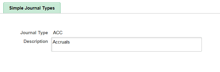

Use the Simple Journal Types page (SJ_JOURNAL_TYPE) to create different journal types that can be used to group the journal templates.
Navigation:
Set Up Financials/Supply Chain > Common Definitions > Journals > Simple Journal Types
This example illustrates the fields and controls on the Simple Journal Types page. You can find definitions for the fields and controls later on this page.
Field or Control
Description
Journal Type
Enter suitable name for the journal type.

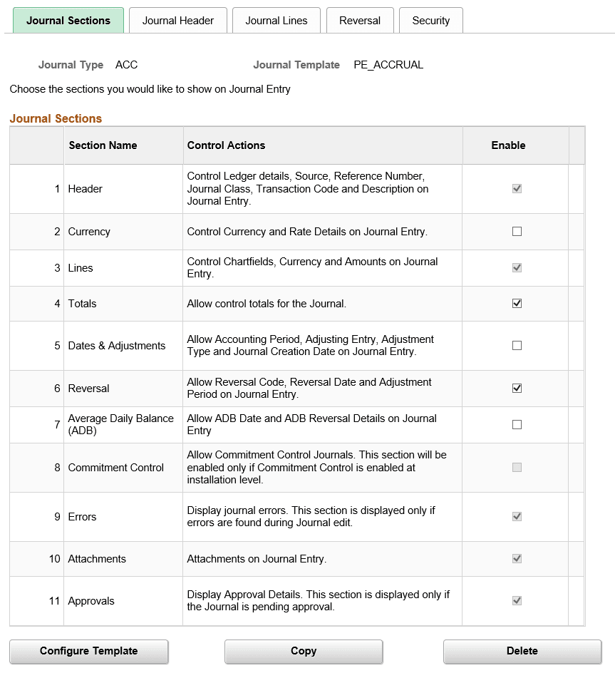

Use the Simple Journal Template page (SJ_TMPL_SECTIONS) to create journal templates for different journal types.
Navigation:
Set Up Financials/Supply Chain > Common Definitions > Journals > Configure Simple Jrnl Template
This example illustrates the fields and controls on the Simple Journal Template page. You can find definitions for the fields and controls later on this page.
Journal Sections page
This example illustrates the fields and controls on the Copy Template page. You can find definitions for the fields and controls later on this page.
Copy Template page
Field or Control
Description
Enable
Select required sections that will be displayed for users to enter details during journal entry. However, following mandatory sections are selected by default and cannot be changed by the administrator:
  • Header — is always displayed on the Journal Entry page.
  • Lines — is always displayed on the Journal Entry page.
  • Attachments — is always displayed on the Journal Entry page.
  • Errors — is displayed only if the journal has Edit errors. If all the errors are fixed and the journal status is Valid, this section is hidden on the Journal Entry page.
  • Approvals — is displayed only after the journal is submitted for approval. This section is not displayed on the Journal Entry page if Approvals is not configured.
Note: Commitment Control section will be available for enabling only if it is selected for general ledger during installation.
Configure Template
Click to enable configuration of the selected sections in the Journal Sections grid. Based on the selected sections, additional tabs will be populated for those sections.
Copy
Click to make a copy of the simple journal template with a new template name. In the Copy Template modal window that opens, enter template name for the new template. The copied template will be saved within the same journal type, hence it’s template name should not be same as that of the source template. However, it can be same across different journal types.
Delete
Click to delete the simple journal template. Only unused templates can be deleted.

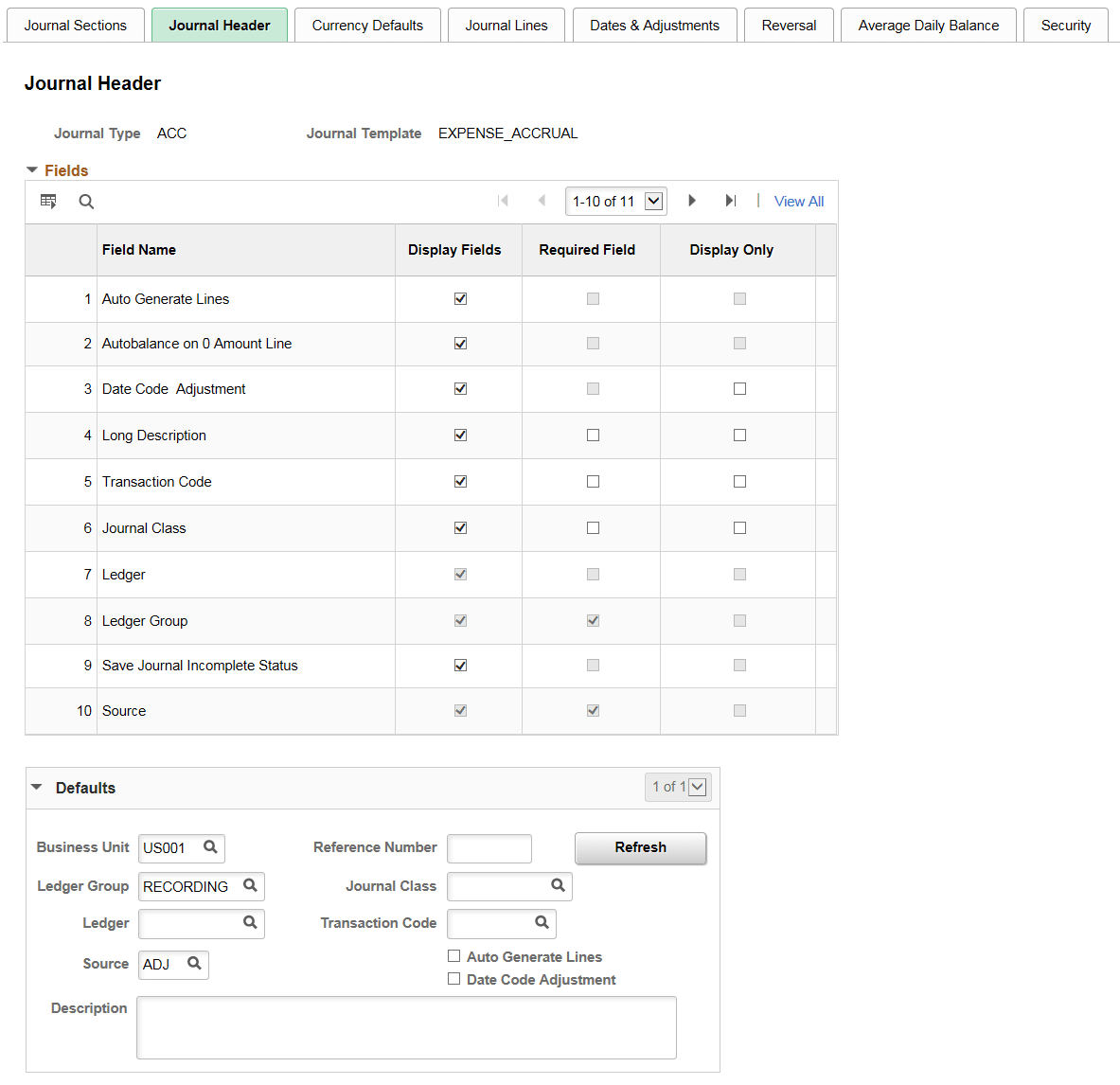

Use the Journal Header page (SJ_TMPL_JRNL_HDR) to configure the fields and default values that are to be available for journal entry.
Navigation:
Set Up Financials/Supply Chain > Common Definitions > Journals > Simple Journal Template > Journal Header
This example illustrates the fields and controls on the Journal Header. You can find definitions for the fields and controls later on this page.
Journal Header page
Fields
Select required fields to be displayed for journal entry. Fields can be configured as Required, Display Only or both. However, mandatory fields such as Ledger and Source cannot be modified.
Defaults
Enter default values for the given fields that will appear in the journal entry.

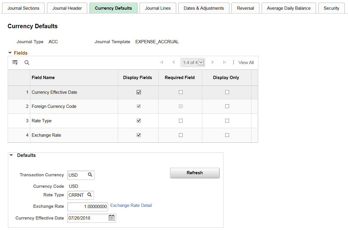

Use the Currency Defaults page (SJ_TMPL_JRNL_CURR) to configure the display of currency and exchange rate fields for journal entry.
Navigation:
Set Up Financials/Supply Chain > Common Definitions > Journals > Simple Journal Template > Currency Defaults
This example illustrates the fields and controls on the Currency Defaults. You can find definitions for the fields and controls later on this page.
Field or Control
Description
Fields
Select required fields to be displayed for journal entry. Fields can be configured as Required, Display Only or both. However some fields such as Foreign Currency Code is mandatory. For fields that are Display Only, default value must be specified.
Defaults
Refresh
Click to update the changes that were made in the Fields section. Fields that are not selected for display will be hidden.

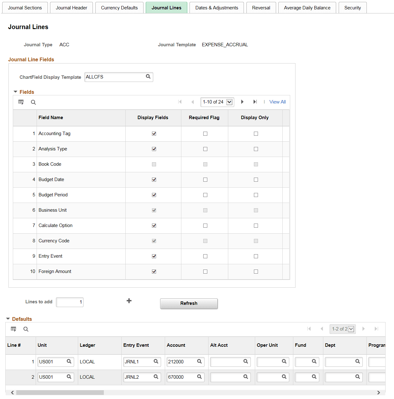

Use the Journal Lines page (SJ_TMPL_JRNL_LINE) to configure journal line fields for journal entry.
Navigation:
Set Up Financials/Supply Chain > Common Definitions > Journals > Configure Simple Jrnl Template. Select the Journal Lines tab.
This example illustrates the fields and controls on the Journal Lines. You can find definitions for the fields and controls later on this page.
Journal Lines page
Business Unit and Currency Code fields are selected by default and are mandatory.
Field or Control
Description
ChartField Display Template
Click the prompt to select suitable ChartField Display Template. Based on the template, display of the ChartFields will be controlled for the journal line during journal entry.
Field Name
Select required fields to be displayed for journal entry. Fields can be configured as Required, Display Only or both. However some fields are mandatory. For fields that are Display Only, a default value must be specified.
Note: As of FSCM 9.2, Update Image 55, the Line Long Description and five Reference fields are available to configure. After applying this update, these fields appear when creating a new template. You must select the Display Fields check box for the fields to appear on the Simple Journal - Lines Page, Miscellaneous tab.
Lines to add
Enter number of lines to insert for the Defaults.
Defaults
Enter a default value for the given fields that will appear in the journal entry.
Refresh

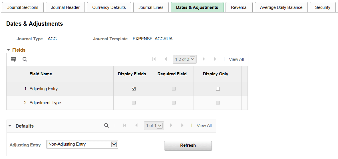

Use the Dates & Adjustments page (SJ_TMPL_JRNL_DTADJ) to configure values pertaining to dates and adjustments that are available for journal entry.
Navigation:
Set Up Financials/Supply Chain > Common Definitions > Journals > Simple Journal Template > Dates & Adjustments
This example illustrates the fields and controls on the Dates & Adjustments. You can find definitions for the fields and controls later on this page.
&Dates & Adjustments page
Field or Control
Description
Fields
Select required fields to be displayed for journal entry. Fields can be configured as Required, Display Only or both. For fields that are Display Only, default value must be specified.
Defaults
Enter default value for the given field that will appear in the journal entry.
Refresh

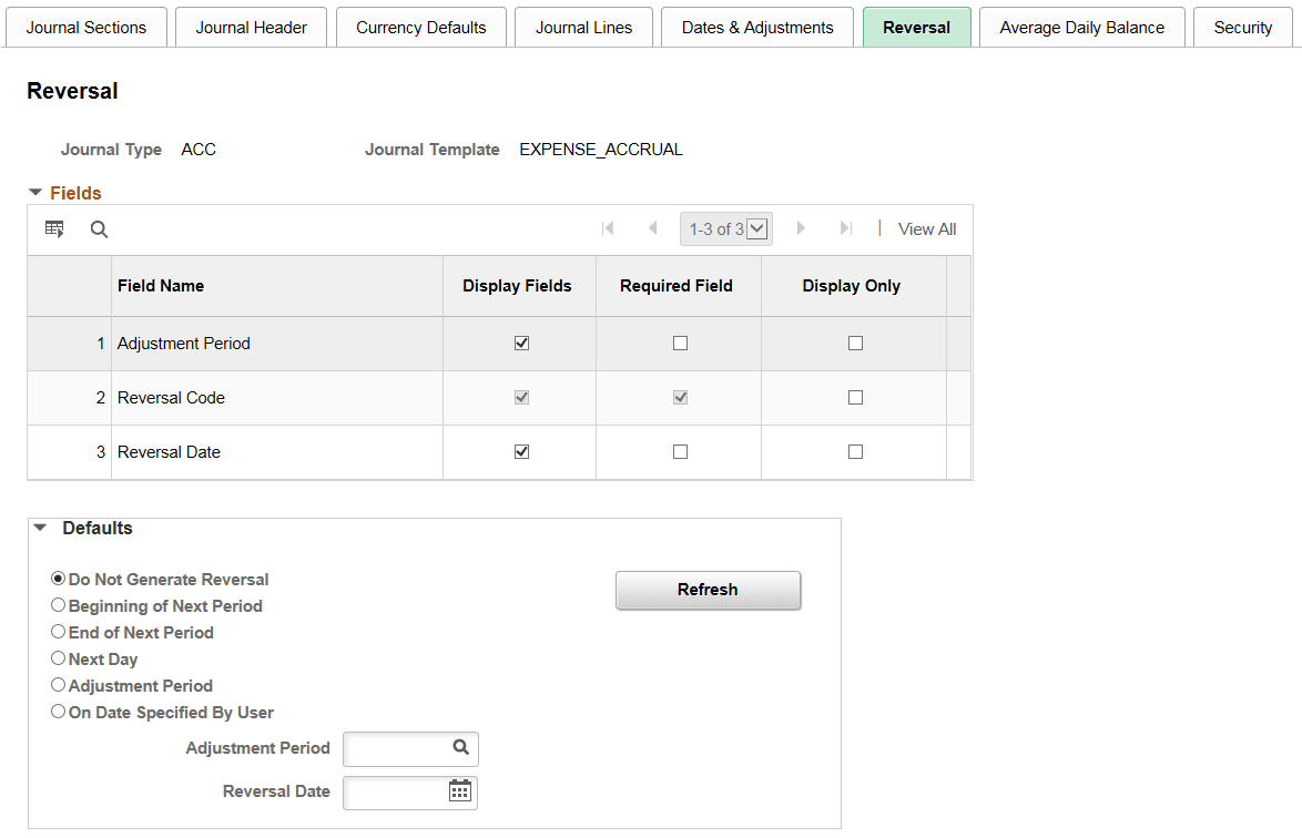

Use the Reversal page (SJ_TMPL_JRNL_RVRSL) to configure fields for the Reversal page that are to be displayed for simple journal entry.
Navigation:
Set Up Financials/Supply Chain > Common Definitions > Journals > Simple Journal Template > Reversal
This example illustrates the fields and controls on the Reversal. You can find definitions for the fields and controls later on this page.
Reversal page
Field or Control
Description
Fields
Defaults
Refresh

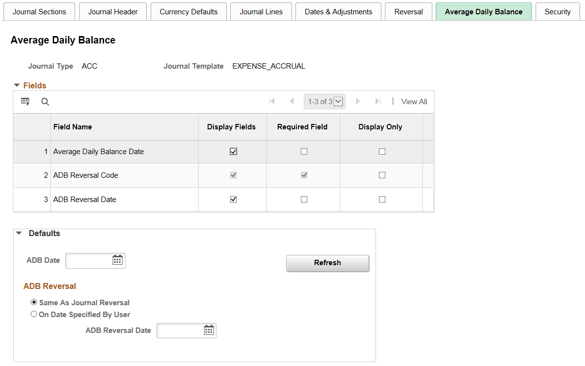

Use the Average Daily Balance page (SJ_TMPL_JRNL_ADB) to configure fields for the Average Daily Balance page that are to be displayed for simple journal entry.
Navigation:
Set Up Financials/Supply Chain > Common Definitions > Journals > Simple Journal Template > Average Daily Balance
This example illustrates the fields and controls on the Average Daily Balance. You can find definitions for the fields and controls later on this page.
Field or Control
Description
Fields
Defaults
Refresh

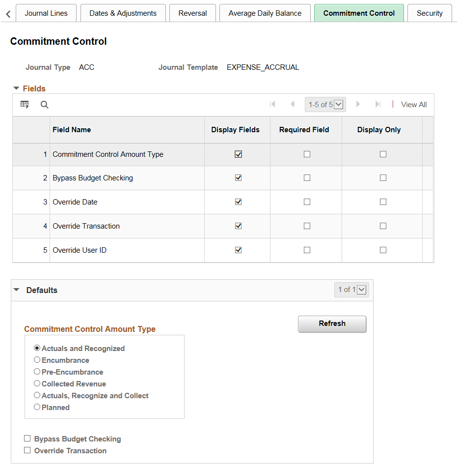

Use the Commitment Control page (SJ_TMPL_JRNL_KK) to configure fields for the Commitment Control page that are to be displayed for simple journal entry.
Navigation:
Set Up Financials/Supply Chain > Common Definitions > Journals > Simple Journal Template > Commitment Control
Note: This tab appears only when you have enabled Commitment Control for General Ledger on the Installation Options - Products Page, and the Commitment Control section is enabled on the Simple Journal Template - Journal Sections Page.
This example illustrates the fields and controls on the Commitment Control. You can find definitions for the fields and controls later on this page.
Field or Control
Description
Fields
Defaults
Refresh

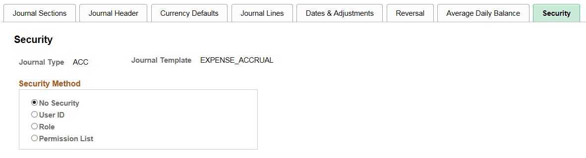

Use the Security page (SJ_JRNL_TMPL_SEC) to define access for the journal template.
Navigation:
Set Up Financials/Supply Chain > Common Definitions > Journals > Simple Journal Template > Security
This example illustrates the fields and controls on the Security. You can find definitions for the fields and controls later on this page.
Security page
Field or Control
Description
Security Method
Select appropriate security method. Available options are:
  • No Security - Select to give access to all users.
  • User ID, Role, Permission List - Select to give access based on User ID, Role, or Permission List
Note: When selecting User ID or Role, the system displays an option field, which is filtered based on the business unit and source entered on the Simple Journal Template - Journal Header Page.

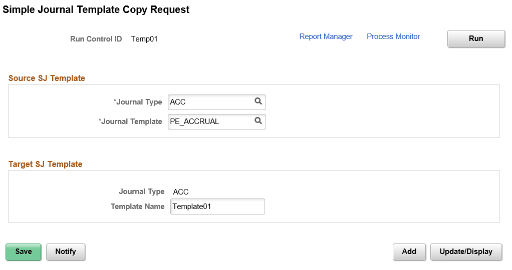

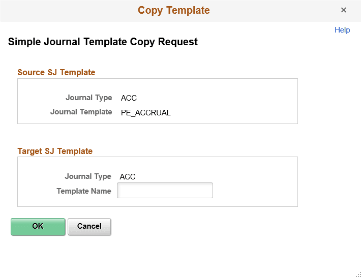

Use the Simple Journal Template page (SJ_TMPLT_CPY) to copy simple journal templates in batch.
Navigation:
Set Up Financials/Supply Chain > Common Definitions > Journals > Copy Simple Journal Template
This example illustrates the fields and controls on the Simple Journal Template Copy Request page. You can find definitions for the fields and controls later on this page.
New templates can be created by copying templates within a particular journal type or across different journal types. The new journals created can be used to copy, and will appear on the Copy Journal Request page for viewing or modifying.
Field or Control
Description
Source SJ Template
Select Journal Type and Journal Template for the simple journal template that has to be copied.
Target SJ Template
Enter Template Name for the new template that will be created. It will have the same Journal Type as that of the Source SJ Template.
Run
Click to review the process list and execute the process request.
