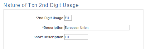

Use the Nature of Transaction 2nd Digit Usage page (NATURE_TXN2_USE) to create a 2nd digit usage identifier for the purpose of identifying a new set of 2nd digit values if you must use other than the delivered EU and United Kingdom sets of values for Intrastat reporting.
Navigation:
This example illustrates the fields and controls on the Nature of Txn 2nd Digit Usage page. You can find definitions for the fields and controls later on this page.
You can define the name for a new set of 2nd digit usage identifiers and the system stores that name in the Nature of Transaction 2nd Digit Usage table. This prompt table is used by the system to enable you to choose the appropriate 2nd digit usage identifier for a particular country in the EU, when a value is required for this field on various Intrastat related pages.
Field or Control |
Description |
2nd Digit Use |
Enter the name for a new 2nd Digit Use identifier. |
Description |
Enter a description of the new 2nd Digit Use identifier. This value will be displayed when prompted elsewhere for the Nature of Transaction 2nd Digit Use Identifier. |
