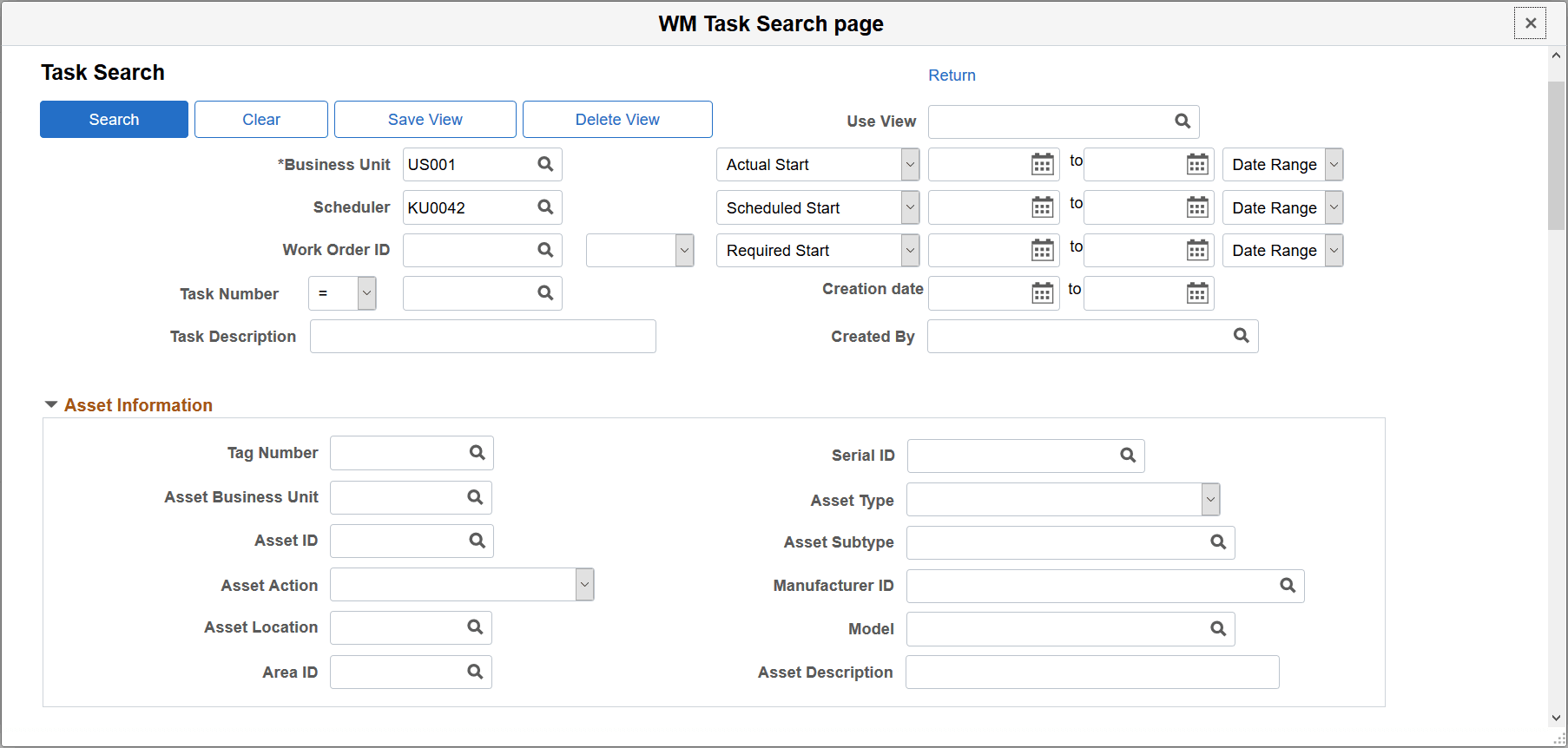

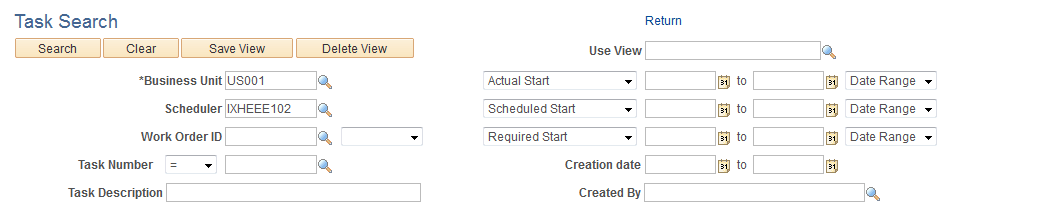

Use the Work Order Workbench - Task Search page (WM_TSK_SRCH_SEC) to create a set of search criteria for work order tasks and save it as a view.
Navigation:
Click the View button on the Work Order Workbench page.
This example illustrates the fields and controls on the Work Order Workbench - Task Search page. You can find definitions for the fields and controls later on this page.
Work Order Workbench - Task Search page (1 of 5)
Work Order Workbench - Task Search page (2 of 5)
Work Order Workbench - Task Search page (3 of 5)
Work Order Workbench - Task Search page (4 of 5)
Work Order Workbench - Task Search page (5 of 5)

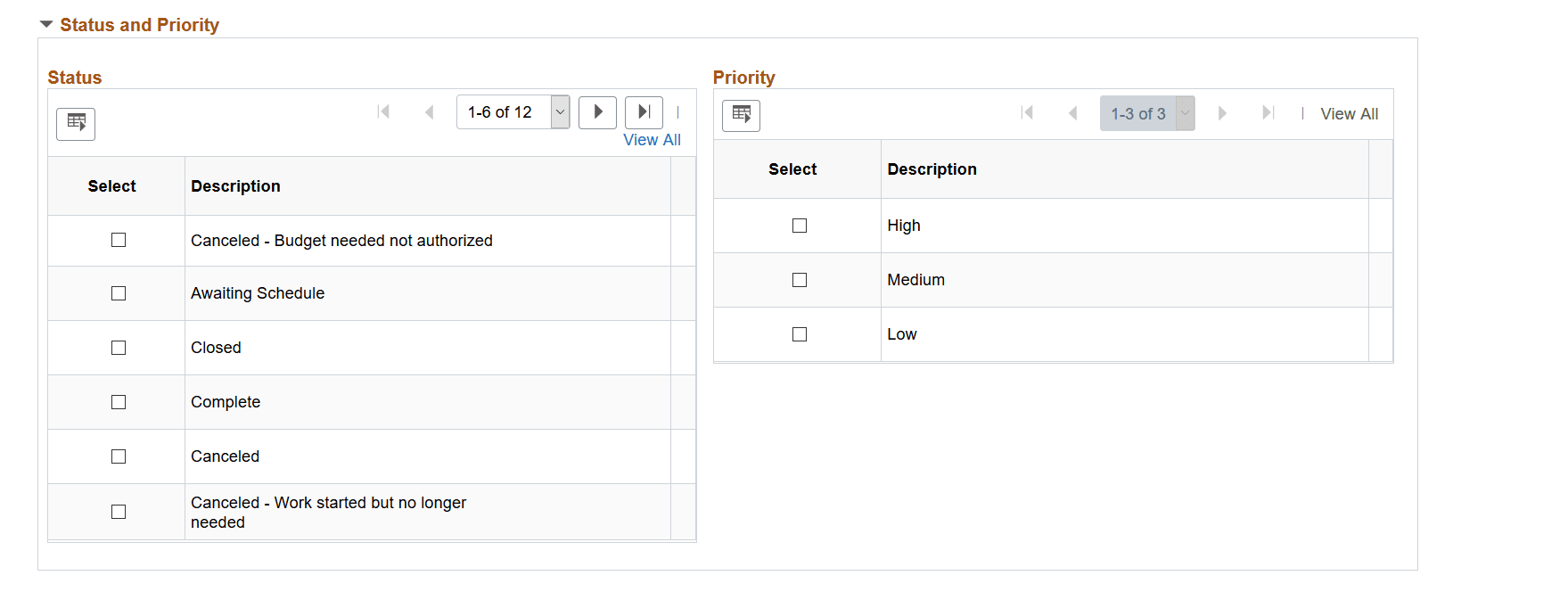

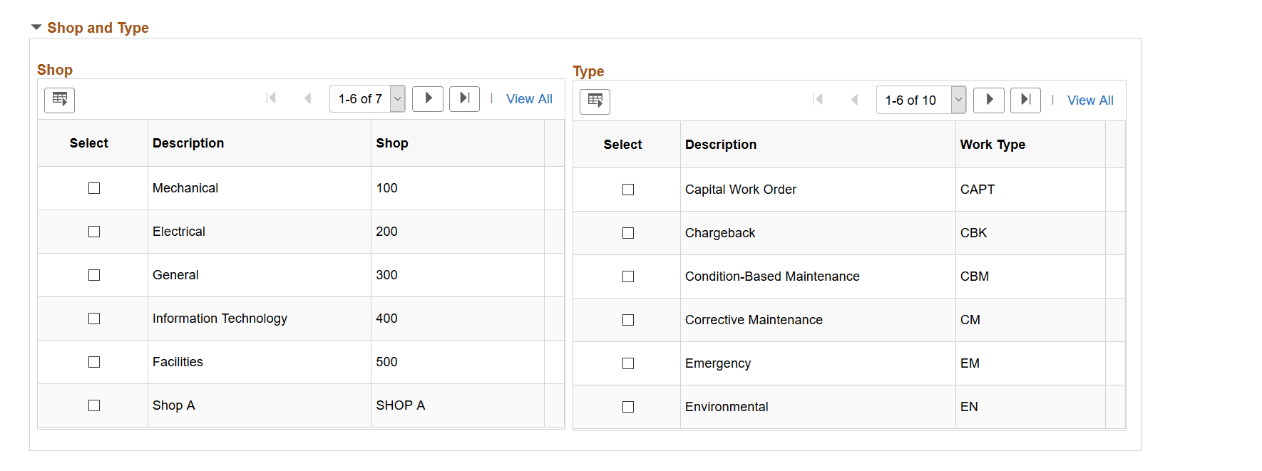

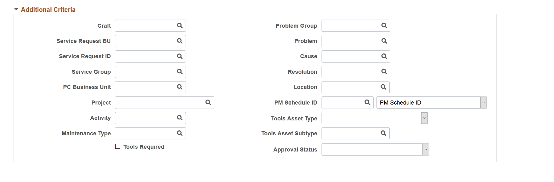

You select or enter the search criteria for a view. You can set up numerous views, which reduces the amount of time it takes to locate work orders and work order tasks having specific characteristics.
Field or Control
Description
Use View
Enter a name for the view that you want to save, after selecting the search criteria on the page. If you access this page by selecting a previously saved view on the Work Order Workbench Search page, then that view's name appears in this field.
Save View
Click this button to save the search criteria entered on this page. You must first enter a name for the view in the Use View field.
Business Unit
Override the default work order business unit, if necessary. Select or enter information in any of the remaining fields to narrow your search for work order tasks.
Note: Business Unit is not required for searches.
Actual Start
Select the date the task actually started or the work order task's actual start date.
Note: This search goes against the actual task start date on the Work Order Workbench and Work Progress tracking. However, on the Technician Workbench Search page, this date refers to the date the scheduled labor line's actual start date.
Scheduled Start andScheduled End
Select either the scheduled start date for the task or the scheduled end date for the task.
Note: This search goes against the scheduled task start or end dates on the Work Order Workbench and Work Progress tracking. However, on the Technician Workbench Search page, this date refers to the labor line's (task row) scheduled start or end date.

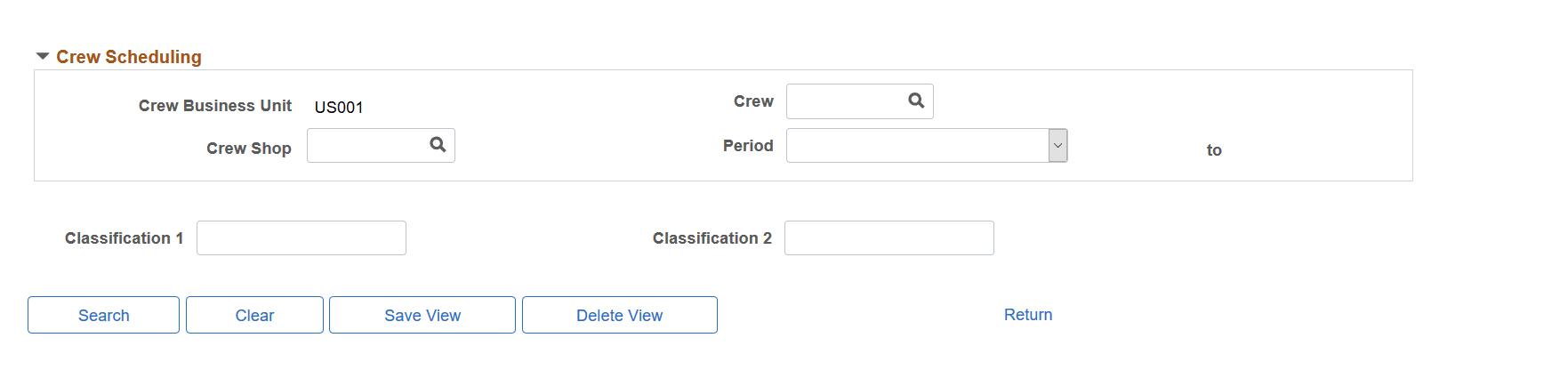

Crew Scheduling
Select a specific Crew, Shop, and Schedule Period to narrow your search to only work order tasks whose requirements are assigned to the specified crew and schedule period.
Classification 1:
The classification fields appear based on supplemental data that can be set up for a work order task.
Search
Click this button to search for the work order tasks that meet the selected criteria on the Task Search page.

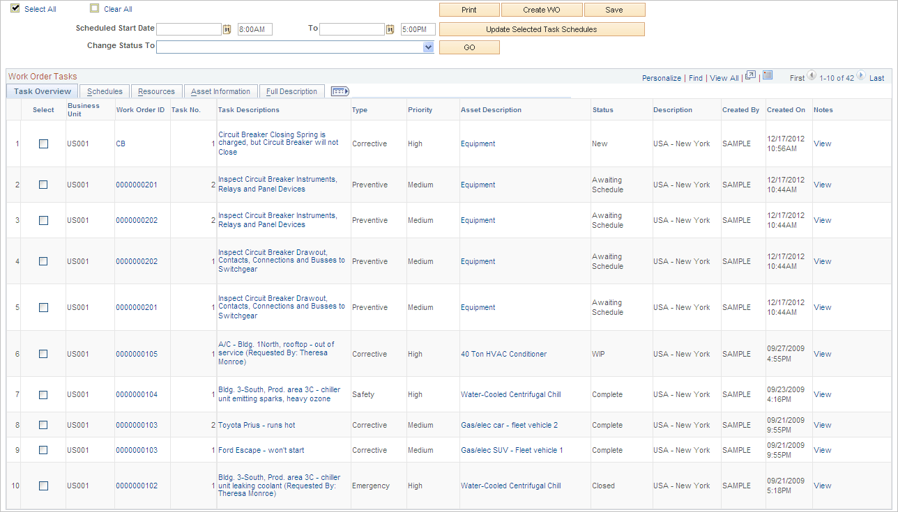

Navigation:
Select the Task Overview tab on the Work Order Workbench page
This example illustrates the fields and controls on the Work Order Workbench page - Task Overview tab. You can find definitions for the fields and controls later on this page.
Field or Control
Description
Select All
Click this check box to indicate that you want to select all of the listed work order tasks listed in the workbench to print.
Clear All
Click this button to unselect all of the work order tasks listed in the workbench.
Print
Click this button to access the Work Order Task Detail Report options. You select print reports for the selected tasks, which include:
  • Labor Assignment Report
  • Material Assignment Report
  • Purchase/On-Hand Report
  • Tool Assignment Report
  • Instruction Report
  • Checklist Report
  • Work Order Notes Report
  • Work Order Task Notes Report
  • Equipment Parts List Report
Note: You can also click the Bar Code check box to include bar codes on the reports to enable bar code scanning.
Change Status To
Select one or more tasks for which you want to transition the status, select the target status, and select the Go button.
Map Selected Tasks
Select the tasks in the Work Order Tasks grid that you want to locate on an ESRI map and click the Map Selected Tasks button to view the task locations on a map. Each task marker on the map contains the following information about the task:
  • Work order business unit, which appears as part of the map marker.
  • Work order ID, which appears as part of the map marker.
  • Work order task ID, which appears as part of the map marker.
  • Description
  • Service Group
  • Priority
  • Work order type secondary page.
  • Task status
Note: The integration with ESRI ARCGIS (Geographic Information System) and Asset Lifecycle Management is no longer supported as of FSCM Update Image 9.2.055.
Create Work Order
Click this button to access the Work Order search page, where you can add a new work order.
Save
Click this button to save any changes to the Work Order Workbench.
Work Order ID
Click this link to access the actual work order.
Task Descriptions
Click this link to review a description of the task.
Asset Descriptions
Click this link to access the Asset Information page and review basic information about the target asset being repaired or maintained in the task.
Notes
Click the View link to review any existing notes for this work order task, to add a new note, and to select different notes by checking the blank check box next to the Subject field to send to a scheduler or service request requester.

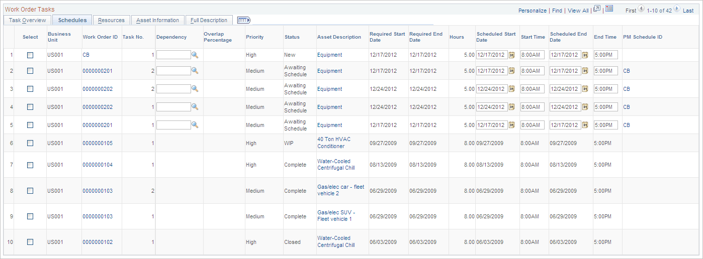

Navigation:
Select the Schedules tab on the Work Order Workbench page
This example illustrates the fields and controls on the Work Order Workbench page - Schedules tab. You can find definitions for the fields and controls later on this page.
Field or Control
Description
Required Start Date and Required End Date
Displays required dates specified in the work order.
Scheduled Start Date and Start Time
Modify the scheduled start date and time as necessary for each task. Validations of these schedule dates and times occur when the page is saved. The validations that take place for these fields on the Schedules page of the work order are also enforced on the Work Order Workbench.
Scheduled End Data and End Time
Modify the scheduled end date and time as necessary.

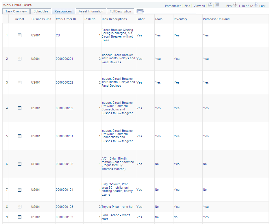

Navigation:
Select the Resources tab on the Work Order Workbench page.
This example illustrates the fields and controls on the Work Order Workbench page - Resources tab. You can find definitions for the fields and controls later on this page.
Field or Control
Description
Labor
Click the link to access the Labor Schedules grid on the work order's Schedules page, where you can modify the schedule depending on the status of the work order.
Displays Yes if labor resources are scheduled for this task and No if labor resources are not scheduled for this task.
Tools
Click the link to access the Tool Schedules grid on the work order's Schedules page, where you can modify the schedule depending on the status of the work order.
Displays Yes if tool resources are scheduled for this task and No if tool resources are not scheduled for this task.
Inventory
Click the link to access the Inventory Schedules grid on the work order's Schedules page, where you can modify the schedule depending on the status of the work order.
Displays Yes if inventory resources are scheduled for this task and No if inventory resources are not scheduled for this task.
Purchase/On-Hand
Click the link to access the Purchase/On-Hand Schedules grid on the work order's Schedules page, where you can modify the schedule depending on the status of the work order.
Displays Yes if Purchase/On-Hand resources are scheduled for this task and No if Purchase/On-Hand resources are not scheduled for this task.

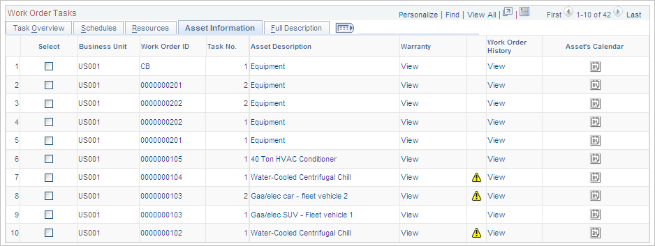

Navigation:
Select the Asset Information tab on the Work Order Workbench page.
This example illustrates the fields and controls on the Work Order Workbench - Asset Information tab. You can find definitions for the fields and controls later on this page.
Field or Control
Description
Warranty
Click this link to view or add warranty information for the work order task's asset on the Asset Warranties page.
Warranty
Click this icon to access active warranties associated with this asset. This icon will only display if there are warranties associated with the asset.
Hazard
Displays this icon if the asset being maintained is categorized as hazardous.
Work Order History
Click this link to access the Work Order Task History page for this asset. You can override the asset ID on the page and search for and display the task history for a different asset.
Asset's Calendar
Click this link to access the Asset Monthly Schedule page, where you can review existing commitments for the asset.
