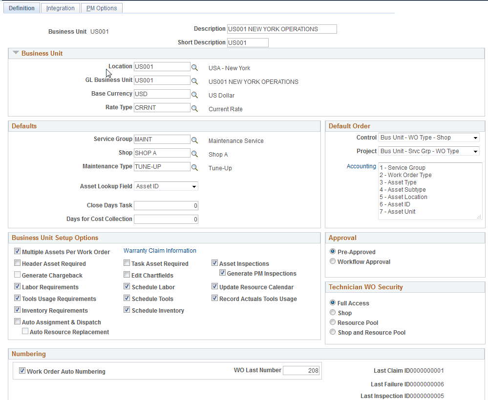

Work Order - Definition Page
BUS_UNIT_TBL_WM1
Enables users to define a work order business unit as a work center for an organization, set up accounting parameters including integration with the GL business unit, identify specific PeopleSoft Maintenance Management setup options, establish default values for the work order and work order task, and set up auto-numbering of work orders.

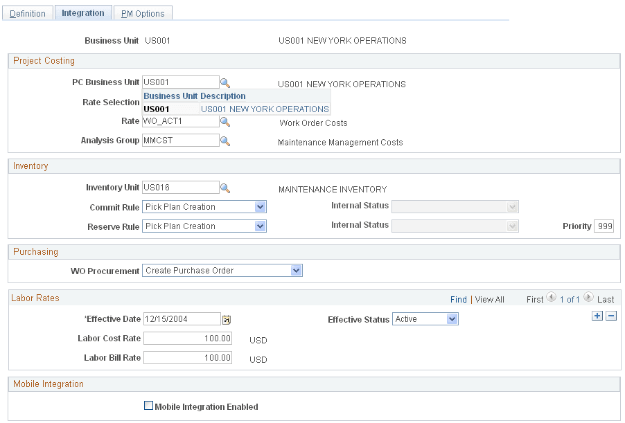

Work Order - Integration Page
BUS_UNIT_TBL_WM2
Identify Project Costing, Inventory, and PeopleSoft Purchasing integration parameters.

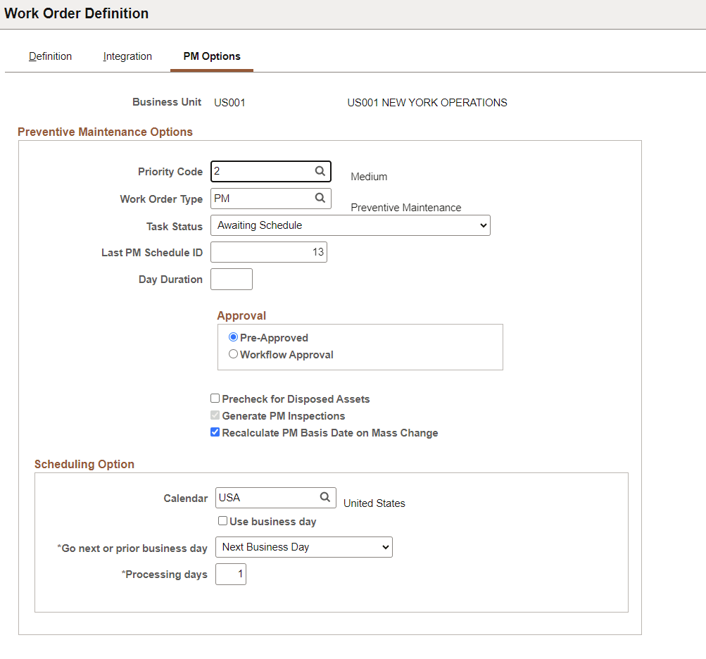

PM Options Page
BUS_UNIT_TBL_WM3
Identify parameters specific to Preventative Maintenance Work Orders.

  • The Definition page in which you define information unique to this business unit, set up work order workflow approval and work order access security, select specific set up options and warranty claim information, define default values and default hierarchies, specify work order numbering characteristics, and track last Warranty Claim and Failure Tracking IDs.
    The required fields on this page are Location, GL Business Unit, Base Currency, Rate Type, Service Group, and Accounting Default Order.
  • The Integration page in which you identify specific options that enable a business unit to integrate with Project Costing, PeopleSoft Inventory, PeopleSoft Purchasing, and PeopleSoft eProcurement, define default labor rates for resources, and enable mobile integration.
    The Project Costing Business Unit is a required field.
    Note: The Inventory business unit and commit rule are only required if you plan to integrate and use PeopleSoft Inventory with PeopleSoft Maintenance Management.
  • The PM Options page defines specific options that enable you to use this business unit to enter and process preventive maintenance work orders.
    The required fields on this page are Priority Code, Work Order Type, and Task Status.

You set up specific options in the Integration page of the work order business unit for Project Costing, PeopleSoft Inventory, and PeopleSoft Purchasing.
You can also set up labor cost and bill rates that serve as default values in the labor requirements or labor schedule for a work order created with this business unit. You can override these labor rates in the shop.
Work Order Business Unit and Project Costing Integration Options
You must indicate the Project Costing business unit that will be used to create both work order managed and project costing projects in Project Costing. This business unit serves as the default value in the work order, the Associate Projects component, and the Work Order Task Accounting page.
You also indicate whether you plan to use a rate plan or rate sets for calculating chargebacks and other costs.
Rate sets enable you to create transaction rows for use in costing, billing, revenue recognition, or reporting, from incoming or existing transactions in the Project Transaction table. Rate sets have two parts: The source criteria that the Pricing process uses to compare against cost transactions coming in from feeder systems. The target definition of the cost, billing, or revenue recognition row that the Pricing process creates. When an incoming cost transaction matches the source criteria, the Pricing process creates a new transaction row for every target row on the rate set. You can assign the same rate set to multiple rate plans.
A rate plan is a collection of rate sets that the system executes in a specified order. Use rate plans to link rate sets so that priced rows from one rate set are used to create additional priced rows from the next rate set. For example, you can add additional expenses, such as administrative costs or overhead, to cost transactions before they are priced for billing or revenue. The Pricing process uses the rate plan to determine which rate sets to run and in what sequence to run them. When setting up the rate plan, you can assign rate sets in any combination of rate definition types—cost, billing, and revenue.
You select the analysis group from PeopleSoft Project Costing that is used by the Cost Collection process in PeopleSoft Maintenance Management to gather costs from PeopleSoft Project Costing into PeopleSoft Maintenance Management. The analysis group delivered for Maintenance Management in the Project Costing sample data is MMCST.
Work Order Business Unit and PeopleSoft Inventory Integration Options
You set up the Inventory business unit, the Inventory Commit rule, and the Work Order Reservation rule in the Integration page of the work order business unit.
The Inventory business unit serves as the default value when you select an item in the Inventory Requirements and Inventory Schedules grids. The SetID associated with the Inventory business unit must match the SetID associated with this work order business unit.
You specify a Commit rule to determine the point when you want to commit (recognize work order demand) the selected items to PeopleSoft Inventory, which means the point at which you want PeopleSoft Inventory to recognize the work order task demand for the item. Commit rules can be set up at the business unit level, the shop level, and the shop/work order type level within a shop. The rule you select applies to all work orders created with this business unit, shop, or shop/type. You can select one of the following Commitment rules, which include:
  • Commit at Reserve
    Selecting this Commit rule enables you to defer committing the item(s) to PeopleSoft Inventory until the time you choose to reserve the item(s).
  • Parts List
    The addition of an inventory item to the parts list, which means that Items are committed when they have been added to the Inventory Schedules grid and a save has been issued. Each subsequent part that is added and saved on the work order task will commit the item to PeopleSoft Inventory.
  • Picking Plan
    Items are committed when a Picking Plan is created. A picking plan consists of the parts or inventory items that are added to a list, which direct inventory personnel to the storage locations for the items that they need to pick for the work order task. This option delays committing of the inventory items until you are ready to have them picked and available to begin working the work order.
  • Work Order Status Change
    Items are committed when the work order task status is changed to an internal status of Awaiting Schedule, Scheduled, or Work in Progress.
You can also reserve inventory items, which are selected for a work order task, based upon your selection of a Work Order Reservation rule, which works in combination with the selected Commit rule. Work Order Reservation rules can be set up at the business unit level, the shop level, and the shop/work order type within the shop level. Inventory items must be committed before or at the same as they are reserved. The system will verify the valid combinations that can be set up for the commit and reservation rules that are chosen. The available values to select from for both commit and reservation rules will be filtered down to the applicable/acceptable valid values to ensure that you cannot establish invalid combinations of commit and reservation rules. The Work Order Reservation rules include:
  • Batch Reserve Only
    When the batch process is run, the rows will be reserved.
  • Parts List Creation
    When the parts (items) in the work order task are saved, the parts (items) are reserved.
  • Pick Plan Creation
    When the picking plan is created, the part (item) is reserved.
    When the status of the work order task is changed to Awaiting Schedule, Scheduled, or Work in Progress, the parts (items) are reserved.
You also specify a priority number between 1 and 999 for work order reservations. PeopleSoft Inventory uses this number to sort demand and prioritize it accordingly, with 1 being the highest or most important priority and 999 being the lowest or least important priority. This number displays as a default value in the Inventory Schedules grid.
The selected Commit rule and the Work Order Reservation rule combination must be valid.
The values that display on the Reserve Rule/Status dropdown list depend on the value(s) that you selected for the Commit Rule/Status. If you change the Commit Rule/Status or change the default flag from Specify to Default on the shop header or shop/type pages and the current Reserve Rule/Status becomes invalid, the Reserve Rule/Status field is blanked out and a message is issued instructing you to specify a new Reserve Rule/Status from the updated list of valid choices.
Note: Depending on the changes you make, other restrictions may apply to limit work order business unit rule/status values from invalidating a lower-level shop header or shop/type definition that depend on the current work order business unit values.
Valid edit combinations are:
  1. Commit rule = Parts List
    Reservation rule = Parts List.
  2. Commit rule = Parts List
    • Reservation rule = Status Change = any 3 statuses
    • Reservation rule = Pick Plan
    • Reservation rule = Batch Only
  3. Commit rule = Status Change = Awaiting Schedule
    • Reservation rule = Awaiting Schedule or Scheduled or Work in Progress
  4. Commit rule = Status Change = Scheduled
    • Reservation rule = Scheduled, Work in Progress
  5. Commit rule = Status Change = Work in Progress
    • Reservation rule = Work in Progress
  6. Commit rule = Pick Plan
  7. Commit rule = Commit at Reserve
    Reservation rule = All rules
then this indicates that there is at least one lower-level Shop or Shop/Type definition associated with (keyed by) this WO BU that depends on the current WO BU rule settings. The User may have to first reset the dependent Shop-level definition(s), before making the desired rule change to the WO BU.
Important! The edit ensures that the commit of items occurs prior to or at the same time as execution of the reservation rule. If the WO Status Change option is selected for both the commit and the reserve rule, then the reserve rule's internal status must be later than or the same as the commit rule's internal status.
If fewer values appear than usual on the commit rule dropdown list (less than 3 for commit rule, 4 for internal status), or the reserve rule dropdown list (fewer internal statuses based on Important rule above), then at least one shop or shop/type level setting depends on the current work order business unit setting. You may need to reset Inventory/Commit Rule Reservation at the shop or shop/type level before you can make changes to the rules at the work order business unit level.
Note: The batch reservation process will only reserve committed work order rows. If a reservation rule implies on-line reserve and the row(s) could not be reserved, a status TBD (to be determined) by Inventory will dictate if the batch reservation process will pick up the row(s).
Work Order Business Unit and Work Order Procurement Integration Options
You determine in the work order business unit whether you want to use purchase orders to purchase labor, non-inventory and open description materials, and tools for a work order, or whether you want to use Purchasing or eProcurement requisitions. When you set up requirements and scheduling for a work order created with this business unit, you can purchase items based only on the option you choose for this business unit.
If you do not want to use purchase orders or requisitions, you can select the blank space to leave the field blank or select None. Selecting this option hides the Load Purchase Order/Load Requisition button on Purchase/On-hand Schedules section of the Schedules page.
See PeopleSoft Maintenance Management Integration with PeopleSoft Purchasing and PeopleSoft Payables.

Use the Work Order - Definition page (BUS_UNIT_TBL_WM1) to enables users to define a work order business unit as a work center for an organization, set up accounting parameters including integration with the GL business unit, identify specific PeopleSoft Maintenance Management setup options, establish default values for the work order and work order task, and set up auto-numbering of work orders.
Navigation:
Set Up Financials/Supply Chain > Business Unit Related > Maintenance Management > Work Order Definition > Definition
This example illustrates the fields and controls on the Work Order - Definition page. You can find definitions for the fields and controls later on this page.
When you set up a new work order business unit, you enter the new business unit number in the Add a New Value page and, when you access the Definition page, you describe this new business unit, associate a SetID, and create the business unit.
Business Unit
Field or Control
Description
Location
Select the location of this work order business unit. This is a required field.
GL Business Unit
Select the General Ledger business unit, which serves as a default value for the GL business units set up in the PeopleSoft Maintenance Management ChartField distribution templates that you set up later in this topic. This is a required field.
Note: You can change this default GL business unit for PeopleSoft Purchasing rows only on the distribution template. You cannot change this default GL business unit for PeopleSoft Inventory, PeopleSoft Expenses, Project Costing integration module rows on the distribution templates. This default GL business unit displays in the distribution page accessed from the labor, inventory, purchasing/on-hand, and tools Distribution tab in the work order schedule grids.
Base Currency
Select the work order business unit base currency to use for currency conversions in work order transactions. Work order costs always display this currency in PeopleSoft Maintenance Management, even if the costs are calculated in another currency by an integrated product or Project Costing. This is a required field.
Rate Type
Select the type of rate to use to calculate conversions to the base currency for work order transactions. This is a required field.
See Currency Conversion.
See Understanding Overall System Setup Parameters for PeopleSoft Maintenance Management.
Business Unit Setup Options
Select the options that you want to apply to your work order transactions.
Field or Control
Description
Multiple Assets Per Work Order
Select this check box to enable you to enter a different asset from task to task. If you leave this check box blank, you can only enter an asset identification value at the work order header level. The fields for asset identification, Asset Management business unit, location, and others will not appear on the tasks. The system applies the asset defined in the work order header to each work order task.
In you intend to create work orders to perform the changeout of an asset's component, then you must select this check box. This is because you must identify more than one asset to perform a component changeout.
Important! This rule concerning multiple assets per work order does not apply to preventive maintenance work orders. You can create a preventive maintenance work order for a loop composed of multiple assets regardless of whether or not this check box is selected.
See Component Changeout in PeopleSoft Maintenance Management.
Header Asset Required
Select this check box to define the asset as a required entry when creating or updating a Work Order.
Task Asset Required
Select this check box to define the asset as a required entry when creating or updating a Work Order Task.
Generate Chargeback
Select this option to enable chargebacks, which is the recovery of costs from another organization, such as the business unit, operating unit, department, fund, and more, for any work orders associated with this business unit. Selecting this option enables the chargeback check box on the Task Accounting page.
Note: To activate the chargeback check box on the Work Order Task Accounting page, you must select this option and select the Organization option in the Installation Options component.
Note: You can override this specification for a shop at the shop level and for a work order type at the work order type level.
Edit ChartFields
Select this check box to enable users to edit ChartField distribution values in the work order task.
Labor Requirements
Select this check box to enable users to access the Labor Requirements grid in a work order that you created using this business unit, and calculate the estimated costs for the Labor resource requirements for each work order task. If you deselect the check box, you cannot access the Labor Requirements grid in the Work Order component.
Note: You can override this field at the shop level.
See Labor Requirements.
Select this check box to enable users to access the Inventory Requirements grid in the work order created using this business unit and calculate the estimated costs for the inventory resource requirements for each work order task. If you deselect the check box, you cannot access the Inventory Requirements grid in the Work Order component.
See Inventory Requirements.
Auto Assignment & Dispatch
Select this check box to automatically assign labor and procurement resources (employee and supplier) to a Work Order when it is created and for Preventive Maintenance Work Order as well.
Tools Usage Requirements
Select this check box to enable users to access the Tool Requirements grid in the work order created using this business unit and calculate the estimated costs for the Tool resource requirements for each work order task. If you deselect the check box, you cannot access the Tool Requirements grid in the Work Order component.
See Tool Resource Requirements.
Schedule Labor, Schedule Inventory, and Schedule Tools
Select the applicable check boxes based on your business needs to enable a scheduler to schedule the various resources for labor, inventory, and tool transactions in the Schedules page of the Work Order component.
Note: You can override these selections at the shop level.
See Understanding Resource Scheduling.
Asset Inspections
Select this option to allow maintenance technicians to create asset inspections for this business unit from work orders and related components.
Generate PM Inspections
Select this option to generate asset inspections for Preventive Maintenance work orders created as a result of PM batch processing for this business unit. To generate asset inspection transactions, an inspection plan must be associated to the particular work order task.
Record Actuals Tools Usage
Select this option to process actual tools usage costs for any work orders using this business unit. These actual costs are generated in PeopleSoft Project Costing and display in the Cost page of the work order
Note: The requirement for recording tools actuals is optional because some organizations do not record the use of tools that are involved in repairing an asset. However, all labor and material actuals are always recorded if used for a work order task. You can override this selection for a shop at the shop level.
See Tool Usage.
Update Resource Calendar
Select this option to enable a user to update the employee and tool resource calendars to free resources to perform other work if they have completed these work assignments earlier than scheduled.
Note: This option is only available for selection if the Schedule Labor and Schedule Tools check boxes above are selected. You can override this selection for a shop at the shop level.
Approval
Select:
Technician WO Security (technician work order security)
Select one of the following options to enable resources to have access to express work orders and work orders in the Technician Workbench:
  • Full Access
    Select the Full Access option in for this work order business unit so that any PeopleSoft Maintenance Management resource can access any work order and work order task on the Work Order, Technician Workbench, and the Express Work Order components created with this business unit, depending on the user's PeopleSoft Security setup for these components.
  • Shop
    Select this option to enable a user with the Allow Access to WO Security check box selected on the User Preferences – Maintenance Management page to click the Technician Work Order Access link on the Work Order component's Miscellaneous page of any work order created with this business unit and access the Work Order Access page.
    The Work Order Access page lists, at a minimum, the shop used to create the work order. If a resource is selected for a work order task and is assigned to a shop that is different from the shop used to create the work order (cross-shop), then this shop is automatically added to the list on the Work Order Access page. The authorized user can add or remove any shops to and from this list except for the shop that was used to create the work order.
    Only resources who have Apply WO Access Security selected on the User Preferences – Maintenance Management page and are assigned to one of the shops listed on the Work Order Access page can access work order and work order tasks on the Work Order, Technician Workbench, and the Express Work Order components.
  • Resource Pool
    Selecting this option enables only the members of a resource pool, who have the Apply WO Access Security check box selected in the User Preferences – Maintenance Management page, access to the work order and work order tasks created with this business unit and the project and activity associated with a resource pool on the Work Order, Technician Workbench, and Express Work Order components.
    Resource pools are set up in PeopleSoft Resource Management for use in PeopleSoft Program Management and Project Costing. A resource pool consists of a specific group of resources that you can assign to a project and/or activity from PeopleSoft Program Management.
  • Shop and Resource Pool
    Select this option to enable only authorized users to access work orders and work order tasks in the Work Order, Express Work Order, and Technician Workbench components who are assigned to one of the shops listed on the Work Order Access page of a work order created with this business unit, or who are assigned to a resource pool set up for the project and activity that is associated with this work order and work order tasks created with this business unit.
Warranty Claim Information
Click this link to access the Warranty Claim Information page, where you can identify the business unit's contact information that will appear on warranty claims generated from work orders created with this business unit.
See Understanding Warranty Claim Management in PeopleSoft Maintenance Management.
Defaults
Define each of these fields to use as default fields on a work order associated with this business unit. You can override these values when you enter a work order.
Field or Control
Description
Service Group
Select the service group that you want to appear as the default value in any work order associated with this business unit. This is the only level in which you can set up Service Group as a default value.
You can use the service group value to set up your own supplemental data that further describes the service group. For example, if you select ITAM as the default service group value, you can create additional supplemental data fields related to peripheral devices that accompany a computer such as an external hard drive, mouse, and keyboard. When you select the ITAM service group to create a work order, then these supplemental fields will also display in the work order.
This is a required field to enable a service group default value to appear in a preventive maintenance work order.
See Understanding Supplemental Data.
Shop
Select the shop value that you want to display as the default value on the search page when you create a work order. You can override this value in the work order.
Note: You must set up the business unit first and then set up shops using this business unit. Once your shops are set up, you should return to the business unit and enter a default shop value.
See Understanding Shifts, Schedule Patterns and Periods, Shops, and Crews.
Close Days Task
Enter the interim number of days between the completion of a work order task and the automatic closure of the task.
Note: You can override this value at the Work Order Type level. In addition, you can manually close a work order task before this time interval expires.
See Setting Up PeopleSoft Maintenance Management Work Order Parameters.
Asset Lookup Field
Select one of the values listed below for this field. The selected value displays as the field name from which you select an asset's specific value in the Asset Information section of the work order header and the work order task for any work order associated with this business unit.
  • Asset ID
  • Serial ID
  • Tag Number
  • Vehicle ID Number
Control Default Order
Select the order in which the system checks for specified data.
  • Unit, Shop, Type
  • Unit, Type, Shop
Project Default Order
Select the order in which the system checks for ChartField distribution and project ID default values. The changes in this hierarchy are based on the order of the service group and the work order type:
  • Unit, Service Group, Type
  • Unit, Type, Service Group
Days for Cost Collection
Enter the number of days that you want the collection of costs to continue after the work order is closed.
Maintenance Type
Select a default maintenance type value to display in the Maintenance Type field on the Miscellaneous page of the Work Order component. If you generate preventive maintenance work orders, a maintenance type is required on the work order in order to close the work order.
Select a sequence number for each of the values listed to establish the default order for each value, which includes:
  • Service Type.
  • Work Order Type.
  • Asset Type.
  • Asset Subtype.
  • Asset Location.
  • Asset ID.
  • Asset Unit.
See Work Order Business Unit Defaults and Default Hierarchies.
Numbering
Field or Control
Description
Work Order Auto Numbering (work order automatic numbering)
Select this check box to automatically generate work order numbers for each work order created. If you do not enter a number, the system creates NEXT as the default WO ID value. When the work order is saved, a number displays for the Work Order ID, which is the WO Last Number plus one.
Even if you select this check box, you can still enter a work order number manually in the search page WO ID field. However, if you do not select this check box, the system does not generate a WO ID automatically.
WO Last Number (work order last number)
Stores the number of the last work order ID number that was created for this business unit if you selected the Work Order Auto Numbering check box.
Last Claim ID(last claim identification)
Identifies the last warranty claim ID number generated for work orders associated with this business unit.
Last Failure ID (last failure identification)
Identifies the last failure ID number associated with a failure event.
When you create a failure event from the Work Order, the Work Order Completion, or the Technician Workbench components, the system automatically assigns the next Failure ID in the system to the failure event. You cannot override this value. When you save the Work Order Failure Tracking page, the system updates this failure ID number that is associated with the failure event in this Last Failure ID field on the Definition page of the work order business.
If you create a failure event from the Work Order Failure Tracking component, you can accept NEXT as the default for the Failure ID and the system assigns the next failure ID to the failure event This number is tracked in this Last Failure ID field. You can also override NEXT with a unique failure ID. A unique failure ID is not tracked in this Last Failure ID field on the Definition page of the work order business unit.
If you entered a unique failure ID for one failure event, and created the next failure event from the work order, which automatically assigns a failure ID number, when you save the Work Order Failure Tracking page, the number generated is automatically updated in this Last Failure ID field on the Definition page of the work order.
Last Inspection ID
Identifies the last sequential inspection ID generated for the inspection instance for this business unit.
Use the Integration page (BUS_UNIT_TBL_WM2) to identify Project Costing, Inventory, and PeopleSoft Purchasing integration parameters.
Navigation:
Select the Integration tab.
This example illustrates the fields and controls on the Work Order - Integration page. You can find definitions for the fields and controls later on this page.
Project Costing
This section links any work order associated with this business unit to PeopleSoft Project Costing so that PeopleSoft Project Costing can serve as the cost repository for all work order costs, which includes the calculation and capitalization costs of assets. PeopleSoft Project Costing also calculates chargebacks and sends them to the appropriate GL business unit.
Field or Control
Description
PC Business Unit (Project Costing business unit)
Enter or select the Project Costing business unit that you want to use to track costs incurred for work orders associated with this work order business unit. This is a required field.
Note: You can use this Project Costing business unit to set up the Resource Management business unit that is required for setting up resources in PeopleSoft Maintenance Management.
Rate Selection
Select one of the following values:
  • Rate Plan
  • Rate Set
Rate
Select a rate plan or a rate set from PeopleSoft Project Costing to use as the default value in the work order task for calculating chargebacks. If you select Rate Set, select from a list of values, which are user-defined in PeopleSoft Project Costing.
For example:
  • ACT (Actual Cost)
  • TUG_ACT (Tool Usage Actual Costs)
  • TUG_BIL (Tool Usage Billing)
If you select Rate Plan, select from a list of values, which are user-defined in PeopleSoft Project Costing.
For example:
  • PM_BIL_CST (Program Management Bill and Cost)
  • PM_BIL_ONLY (Program Management Bill Only)
  • PM_CST_ONLY (Program Management Cost Only)
Analysis Group
Defines the PeopleSoft Project Costing analysis group that is used by the Cost Collection process in PeopleSoft Maintenance Management to gather costs from PeopleSoft Project Costing into PeopleSoft Maintenance Management.
Note: Analysis Groups are set up in PeopleSoft Project Costing.
See Analysis Groups.
Inventory
These fields only display if Inventory is installed.
Field or Control
Description
Inventory Unit
Enter or select an Inventory business unit if you plan to issue parts from PeopleSoft Inventory to work orders. This business unit appears in the Inventory Requirements - Default Settings and in the Inventory Schedules - Default Settings fields of the work order. This is the only Inventory business unit that can issue parts directly to the work order. The SetID for the work order business unit must match the SetID for the Inventory business unit. The system runs an edit to ensure that these SetIDs match. In addition, you can only use an Inventory business unit in which the GL business unit is the same as the GL business unit in the work order.
Note: You should enter this field if you plan to use PeopleSoft Inventory with PeopleSoft Maintenance Management.
Inventory Commit Rule
Select the rule that describes when to place demand on inventory for inventoried items. This selection serves as an indicator to the scheduler and to PeopleSoft Inventory that items specified in a work order associated with this business unit will place demand on inventory based on your selection of one of these rules. Select one of the following:
  • Commit at Reserve
    This rule commits work order rows at the same time that the reservation rule applies For example, if you select Commit at Reserve as the commit rule and Parts List as the reservation rule, then the item(s) are committed and reserved when the Parts List is created.
  • Parts List
    This rule dictates that the parts on a parts list are automatically committed in PeopleSoft Inventory when the parts list is created and saved.
  • Pick Plan
    This rule dictates that whenever you click the Pick Plan button in the work order, the items in the pick plan will be automatically committed in PeopleSoft Inventory.
    Note: You can also run a Pick Plan from PeopleSoft Inventory or from the Materials page of the Technician Workbench.
    Select this value to enable you to select a internal status for theInternal Status field. When the status in the work order matches the status defined here for the commit rule, the items on the work order are committed to PeopleSoft Inventory.
Note: This is a required field if you enter an Inventory business unit in the Inventory Unit field.
Internal Status
If you selected Work Order Status Change, select one of the internal work order statuses that triggers the commitment of items in PeopleSoft Inventory, which include:
  • Awaiting Schedule
  • Scheduled
  • Work in Progress
See Work Order Business Unit Integration Options.
Work Order Reservation Rule
Select one of these reservation rules to reserve inventory parts (items). Inventory parts (items) must be committed before they can be reserved.
Important! The system edits the commit and reservation rule combination to ensure that the items are committed at the same time or before they are reserved. The system also filters the values that apply to the work order based on the setup of these values in the work order business unit, shop, or shop/type.
    When you run the Batch Reservation process the parts (items) in the rows are reserved.
    When you save the parts (items) in the work order task, reserve the parts (items).
    When you run the Picking Plan for a work order task, reserve the parts (items).
    When you change the status of a work order task to Awaiting Schedule, Scheduled, or Work in Progress, the parts (items) are reserved.
Internal Status
If you selected Work Order Status Change, select one of the internal work order statuses that triggers reservation of items in PeopleSoft Inventory for the work order, which include:
  • Awaiting Schedule
  • Scheduled
  • Work in Progress
Priority
Enter a number from 1- 999 for PeopleSoft Inventory to use to sort and prioritize demand. The number you enter here serves as a default value in the Inventory Schedules grid.
Purchasing
PeopleSoft Maintenance Management requires the installation of PeopleSoft Purchasing to enable users to obtain materials, tools, labor, and other goods and services by creating either a requisition or a purchase order directly from the work order or work order workbench. You can also create a requisition or purchase order in PeopleSoft Purchasing and link it to a work order. If you prefer to use PeopleSoft eProcurement, you can create a requisition directly in PeopleSoft eProcurement from the work order or you can load and stage scheduled rows and create requisitions, which can be accessed in PeopleSoft eProcurement.
Field or Control
Description
Work Order Procurement Option
Select one of these values:
  • the "blank" field or None
    Select this value to indicate that you do not intend to procure materials directly from a work order created with this business unit. When you select this option, no buttons appear on the work order and work order template grids.
  • Create Purchase Order
    Select this value to enable you to generate only purchase orders from a work order created with this business unit.
  • Create Requisition
    Select this value to enable you to generate requistions in PeopleSoft Purchasing from a work order created with this business unit.
  • Create ePro Requisition
    Select this value to enable you to generate requisitions in PeopleSoft eProcurement from a work order created with this business unit.
Labor Rates
Field or Control
Description
Effective Date and Status
Enter or select the date from which you consider these labor rate values either Active or Inactive.
Labor Bill Rate
Enter the hourly bill rate for labor to use to calculate the billable labor amount based on the labor hours entered at the work order task level.
Labor Cost Rate
Enter the hourly cost rate for labor to use to calculate the actual labor costs for any labor performed and tracked via a work order.
Note: You can override these rates for a specific shop at the shop level, as well as associate specific crafts and craft labor rates with a shop.
GIS Integration
Field or Control
Description
GIS Integration Enabled(Geographic Information System integration)
Select this check box to enable integration with ESRI GIS for a selected business unit. You can view the location of a work order task on an ESRI map by clicking a Map It button on the Work Order, Requirements and Schedules pages of the work order, the Work Order Workbench, and the Technician Workbench.
Note: The integration with ESRI ARCGIS (Geographic Information System) and Asset Lifecycle Management is no longer supported as of FSCM Update Image 9.2.055.
Mobile Integration
Field or Control
Description
Mobile Integration Enabled
Select this check box to display Mobile Tasks Updated Pending links appears on the above Work Order, Express Work Order or Work Order Completion components, and to display the Mobile Public check box on the Task Search page associated with the Technician Workbench.
See Mobile Web Services Integration.
Use the PM Options page (BUS_UNIT_TBL_WM3) to identify parameters specific to Preventative Maintenance Work Orders.
Navigation:
Select the PM Options tab.
This example illustrates the fields and controls on the Work Order - PM Options page. You can find definitions for the fields and controls later on this page.
PM Options page
Field or Control
Description
Priority Code
Select H (High), M (Medium), or L (Low) to appear as the default priority in any preventive maintenance work order that the application automatically creates for this business unit. This is a required field.
Important! This default value appears for all work orders except for work orders that you create for a project for a Project Costing-managed project.
See Setup and Processing of Preventive Maintenance Work Orders.
Work Order Type
Select the work order type that you want to use as the default value in any preventive maintenance work orders that the application generates for this business unit. This is a required field.
Task Status
Select the work order task status for a work order task that you want to appear as the default value for any preventive maintenance work orders created during Preventive Maintenance processing that are associated with this business unit.
You can select any user-defined work order task status except for those that you defined for the internal statuses of complete, closed, and canceled.
See Understanding Work Order Statuses.
Last PM Schedule ID
This identifies the last number used to create a preventive maintenance schedule and automatically increments each time a new preventive maintenance schedule is created.
Day Duration
Enter a duration value in hours. This value should not be greater than twenty four. For example, if the day duration is eight hours, the PM work order duration is forty eight hours, and if the start date is 04/05/2012, the period is calculated as forty eight divided by eight, which is six. Hence, end date would be 04/11/2012.
Enable Workflow Approval
Click the Workflow Approval radio button to enable the workflow approval process.
Precheck for Disposed Assets
Select to deactivate any active PM Schedules and Maintenance Loop structures corresponding to assets in ‘Disposed’ status.
Recalculate PM Basis Date on Mass Change
Select to enable the Recalculate Basis Date check-box by default on the PM Schedule Mass Update page.
Scheduling Option
Field or Control
Description
Calendar
Select a business calendar to use in determining valid business days for preventive maintenance work orders that are generated for this business unit. Selecting this option enables you to avoid scheduling preventive maintenance work orders on holidays or weekends.
Use business day
Select the check box to consider only business days for scheduling and skip weekends and holidays.
Note: In the Business Calendar page you can configure the days in a week that you want to be considered as normal business days.
Go next or prior business day
Select day for the next update. There are two options:
  • Next Business Day
  • Prior Business Day
If the calculated date falls on weekend or holiday then based on the option selected the next or prior business date will be considered for scheduling.
Processing days
Enter number of days to increase or decrease from the calculated due date.
