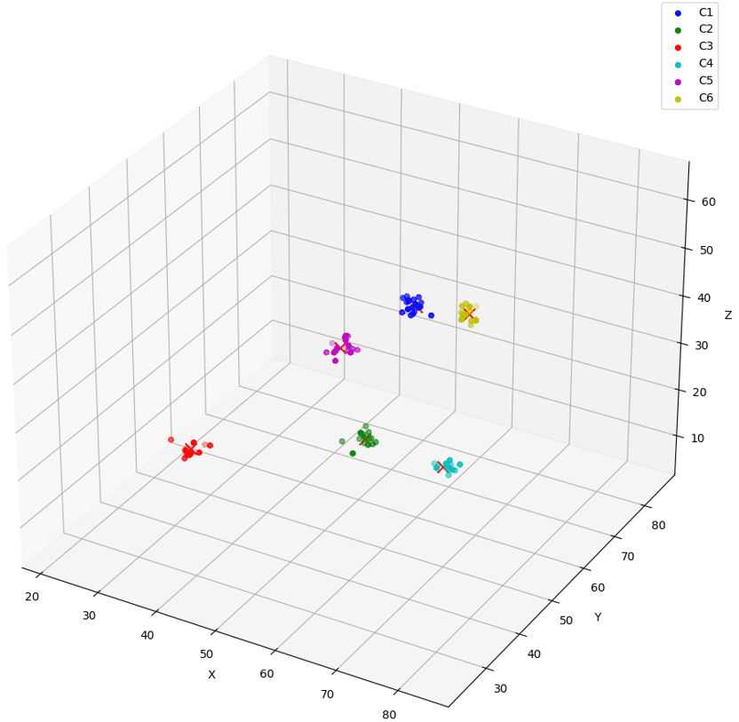

  3. ベクトル・ジェネレータを設定したら、これと次の手順を実行して、その使用方法を理解できます。
    サンプル値を使用して、vector_gen_pkgパッケージのgenerate_vectorsプロシージャを実行します。
    BEGIN
      vector_gen_pkg.generate_vectors(
        num_vectors => 100,   -- Number of vectors to generate. Must be 1 or above
        dimensions => 3,      -- Number of dimensions of each vector. Must be above 1 but less than 500
        num_clusters => 6,    -- Number of clusters to create. Must be 1 or above
        cluster_spread => 1,  -- Relative closeness of each vector in each cluster (using standard deviation). Must be grather than 0
        min_value => 0,       -- Minimum value for a vector coordinate
        max_value => 100      -- Maximum value for a vector coordinate. Min value must be smaller than max value
    END;
  4. SELECT文を実行して、新しく生成されたベクトルを表示します。
    SELECT name, v FROM genvec;
    出力例:
    NAME    V
    _______ ____________________________________________________
    C1      [6.35792809E+001,5.28954163E+001,5.16500435E+001]
    C2      [5.67991257E+001,5.00640755E+001,2.3642437E+001]
    C3      [2.42510891E+001,5.36970367E+001,6.88145638E+000]
    C4      [8.13146515E+001,2.88190498E+001,4.09245186E+001]
    C5      [6.70646744E+001,2.53395119E+001,6.14522667E+001]
    C6      [5.60192604E+001,8.31662598E+001,2.93592377E+001]
    C1-1    [6.4469986E+001,5.25044632E+001,5.22250557E+001]
    C1-2    [6.31295433E+001,5.21443062E+001,5.02242126E+001]
    C1-3    [6.25154915E+001,5.25730362E+001,5.2617794E+001]
    C1-4    [6.3491375E+001,5.21440697E+001,5.06722069E+001]
    C1-5    [6.21516266E+001,5.32161064E+001,5.23233032E+001]
    C1-6    [6.2913269E+001,5.16970291E+001,5.16683655E+001]
    C1-7    [6.22267456E+001,5.40408363E+001,5.0272541E+001]
    C1-8    [6.1414093E+001,5.28870888E+001,5.27458E+001]
    NAME     V
    ________ ____________________________________________________
    C1-9     [6.29652252E+001,5.32767754E+001,5.27030106E+001]
    C1-10    [6.35940704E+001,5.27265244E+001,5.23180656E+001]
    C1-11    [6.34133224E+001,5.39401283E+001,5.29368248E+001]
    C1-12    [6.18856697E+001,5.31113129E+001,5.18861504E+001]
    C1-13    [6.32378883E+001,5.30308647E+001,5.04571724E+001]
    C1-14    [6.18148689E+001,5.33705482E+001,5.29123802E+001]
    C1-15    [6.43224258E+001,5.23124084E+001,5.21299057E+001]
    C2-1     [5.59053535E+001,5.20054626E+001,2.28595486E+001]
    C2-2     [5.71644516E+001,5.13243408E+001,2.31167526E+001]
    C2-3     [5.66626244E+001,5.00615959E+001,2.27138176E+001]
    C2-4     [5.73383865E+001,5.04509125E+001,2.36539135E+001]
    C2-5     [5.6621357E+001,5.01576767E+001,2.38867531E+001]
    C2-6     [5.59768562E+001,5.17590942E+001,2.49088764E+001]
    C2-7     [5.64437904E+001,4.71531525E+001,2.23245487E+001]
    NAME     V
    C2-8     [5.81449051E+001,5.09049644E+001,2.29072056E+001]
    C2-9     [5.37190132E+001,4.87386665E+001,2.28188381E+001]
    C2-10    [5.77416382E+001,4.93461685E+001,2.32014389E+001]
    C2-11    [5.68353958E+001,5.11093979E+001,2.43693123E+001]
    C2-12    [5.79631157E+001,5.0297657E+001,2.28039799E+001]
    C2-13    [5.57930183E+001,5.11965866E+001,2.35887661E+001]
    C2-14    [5.57345848E+001,5.03228951E+001,2.30780907E+001]
    C2-15    [5.69435997E+001,4.8590435E+001,2.58747597E+001]
    C3-1     [2.40239315E+001,5.2352993E+001,5.63517284E+000]
    C3-2     [2.39717846E+001,5.30635986E+001,5.86633539E+000]
    C3-3     [2.70314407E+001,5.48788643E+001,7.96345377E+000]
    C3-4     [2.39875908E+001,5.39634552E+001,5.87654877E+000]
    C3-5     [2.47772026E+001,5.2187336E+001,6.83652115E+000]
    C3-6     [2.32920208E+001,5.41494293E+001,6.40737772E+000]
    NAME     V
    C3-7     [2.46129742E+001,5.32308769E+001,6.29999685E+000]
    C3-8     [2.51000671E+001,5.33271561E+001,8.86797047E+000]
    C3-9     [2.4337059E+001,5.26281281E+001,6.9616766E+000]
    C3-10    [2.39770508E+001,5.42386856E+001,5.63018417E+000]
    C3-11    [2.59837551E+001,5.34013176E+001,6.97773361E+000]
    C3-12    [2.40400314E+001,5.25649719E+001,7.2636981E+000]
    C3-13    [2.13184013E+001,5.28633308E+001,8.3834734E+000]
    C3-14    [2.50075855E+001,5.21548729E+001,6.88196087E+000]
    C3-15    [2.53695087E+001,5.60495186E+001,6.76059389E+000]
    C4-1     [8.28819885E+001,2.95163822E+001,4.03809738E+001]
    C4-2     [8.18269348E+001,2.95735188E+001,3.99435768E+001]
    C4-3     [8.2709259E+001,2.90755043E+001,4.07345886E+001]
    C4-4     [8.18622665E+001,2.88013916E+001,4.1822567E+001]

    結果のベクトルを空間に描写するには、次のグラフを考えてみてください:
    図3-1 ベクトル・クラスタ
