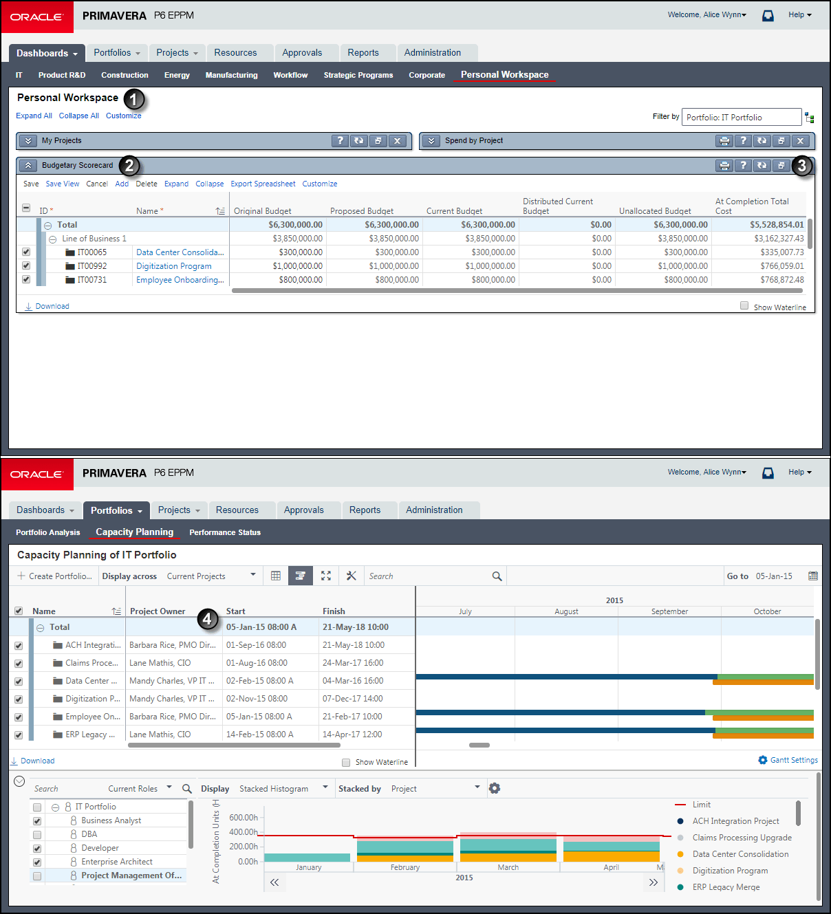

More About Scorecards
You can save the same scorecard view used on the Portfolio Analysis page and display it in private or share it later in a portlet on a dashboard.
Note The application also makes use of general tables of data also referred to sometimes as scorecards; however, they are not the same as your individually named portfolio view scorecards.
This illustration is a graphical representation of the text in the following table.
Table of Related Scorecards
Item
Description
item one
Dashboard: The Personal Workspace dashboard. You can show portfolio views on private, multi-user, or global dashboards.
item  two
Scorecard in a portlet: The Budgetary Scorecard displays in a portlet on a dashboard. This example demonstrates a named portfolio view scorecard.
item  three
 Click here to maximize or minimize this sectionicon: Click to maximize and expand the scorecard. Additional command links will appear at the top of this portlet when it is maximized.
item  four
Scorecard on the Capacity Planning page: This example demonstrates a general table format also referred to as a scorecard; however, this is not a named portfolio view scorecard.
