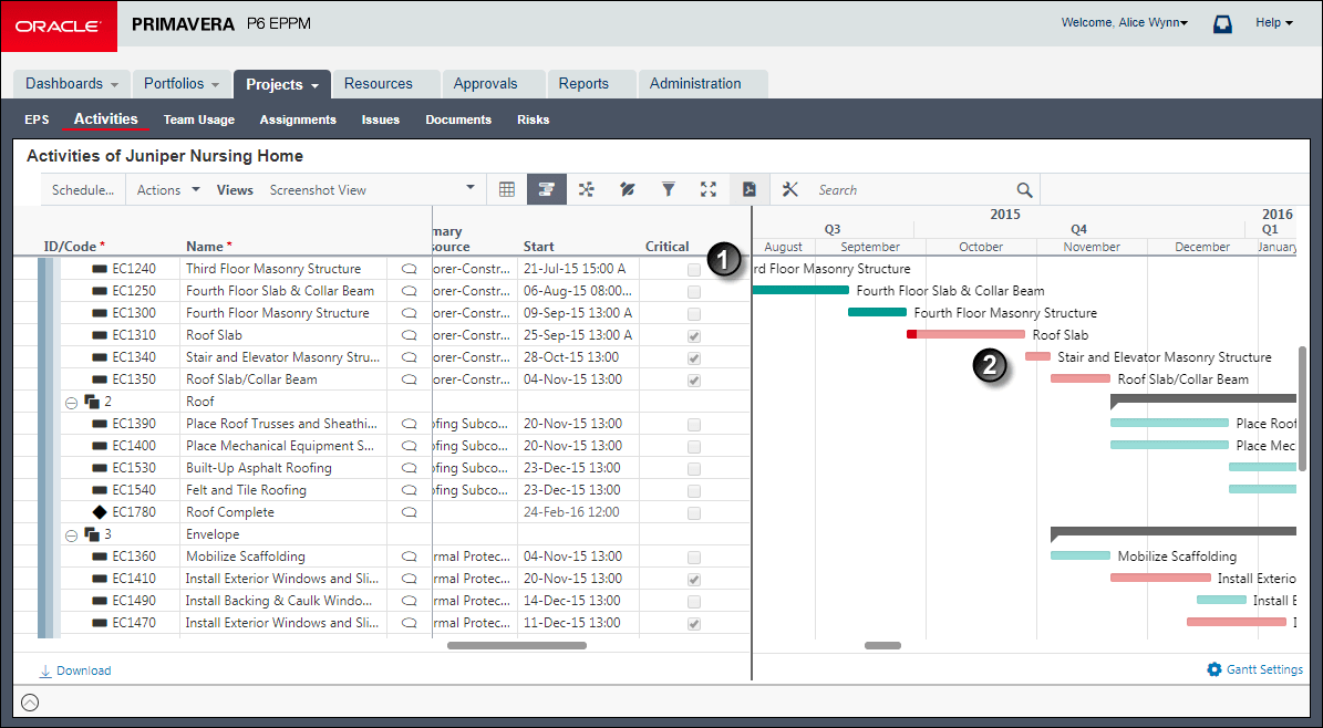

This illustration is a graphical representation of the text in the following table.
Table of Key Elements for Critical Activities
Item
Description
item one
Critical option: This check box is checked for all activities that are calculated as being critical.
item  two
Red bars: Critical activities are indicated in the Activity Gantt with red bars.

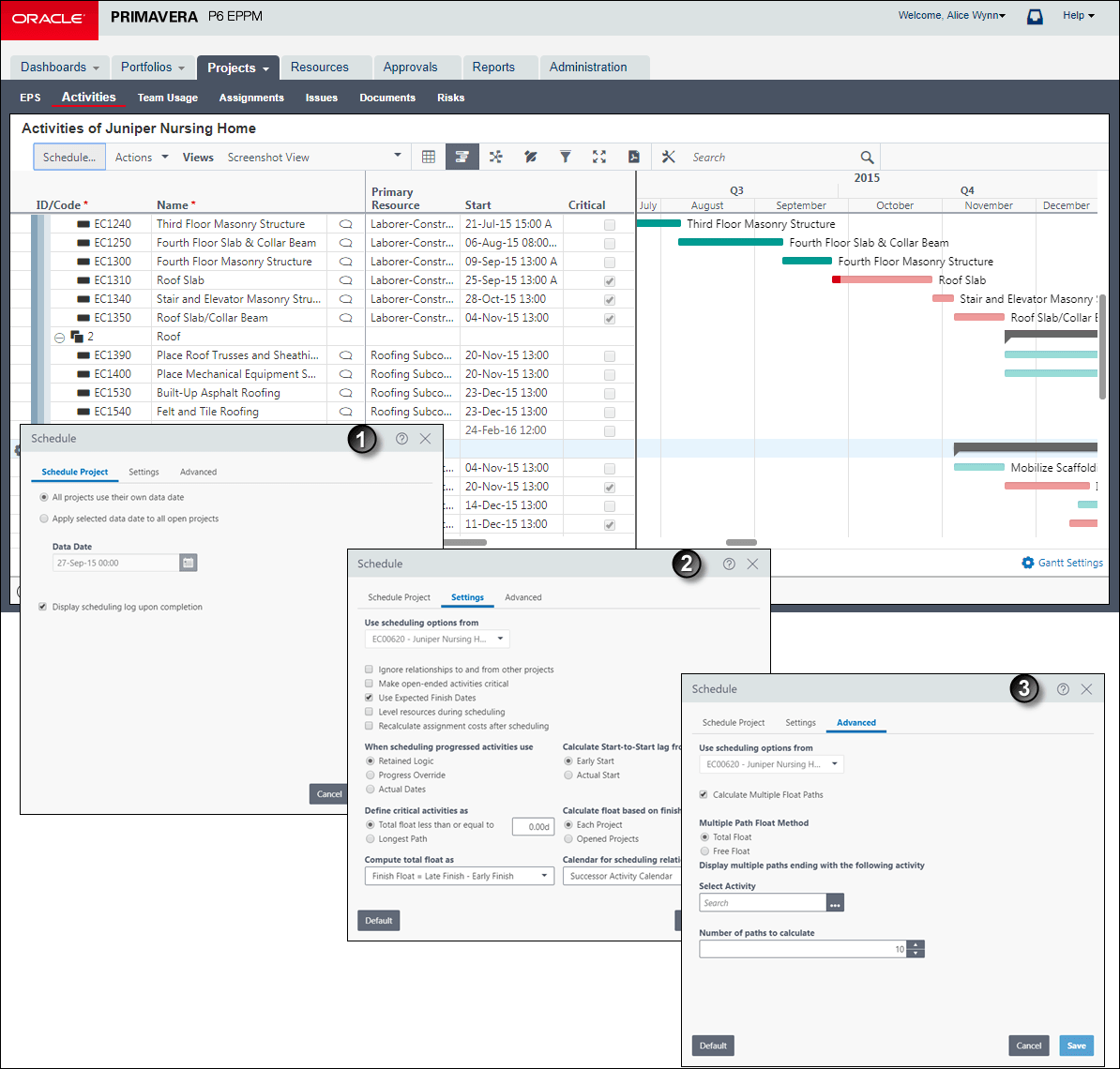

Table of Key Options for Critical Activities
Item
Description
item one
Scheduling Options: On the Activities page, select Schedule. On the resulting Schedule Project dialog box, click the Options button to open the Scheduling Options dialog box.
item  two
Settings tab: Use the Settings tab of the Schedule dialog box to define critical activities according to a maximum float time or by longest path.
item  three
Advanced tab: On the Advanced tab of the Schedule dialog box, you can choose to calculate a specific number of critical float paths based on total float or free float. You can also choose the activity you want the float paths to end on. By choosing an activity, you can calculate multiple float paths that affect the entire project schedule, a specific part of the schedule, or a milestone in the schedule. When you schedule the project, P6 identifies the most critical float path in the schedule and assigns those activities a Float Path value of 1. Then, depending on the number of paths you choose to calculate, P6 identifies other float paths (sub-critical float paths) that affect the most critical float path and numbers the paths based on their criticality in ascending order beginning with 2.
