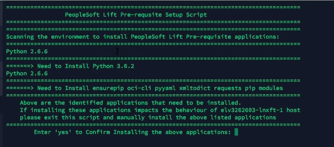

When you run the utility, it will ask if this is a database environment or an application environment. Enter no to indicate that this is an application environment, which is the only supported choice.
Is <environment> a Database Environment: (yes/no):
  • Application environment (answer no at above prompt)
    The system will scan the environment and indicate the applications that need to be installed.
    This example illustrates applications that are required for an application lift.
    Example PeopleSoft Lift Prerequisite Setup Script for Application Environment
  • To confirm installing the applications, enter yes at the prompt.
    Enter 'yes' to Confirm Installing the above applications:
    Warning! If installing the applications impacts the behavior of your environment, then enter no. You will need to install the applications manually.
During installation of the prerequisite applications the utility will prompt for user confirmation, in order to continue installing certain dependencies. Not installing dependencies may result in Lift failure.

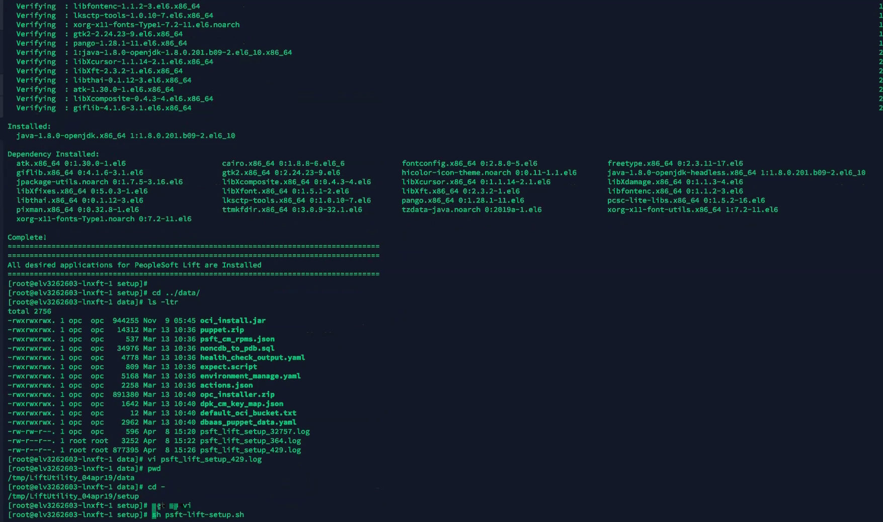

When all the applications are successfully installed, you will get a message “Complete!”.
This example illustrates all desired applications for PeopleSoft Lift are installed.
Example Lift Prerequisites Complete
You can list the files and view the logs that were created for the install. The logs located at <Lift_Utility>/data/psft_lift_setup_<PID>.log
When you are ready to run the Lift Utility, it will verify that all the prerequisites have been installed.
