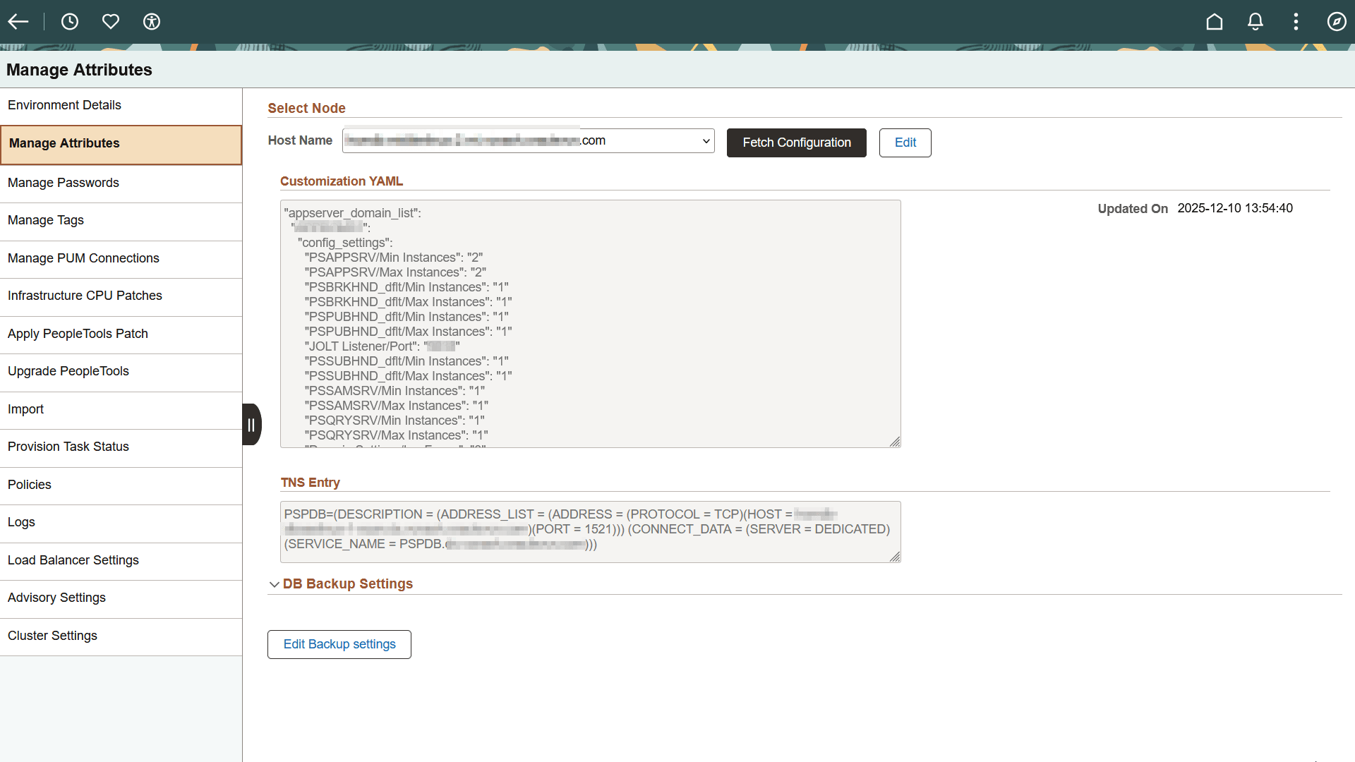

Select Node
Select the host name and click the Fetch Configuration button to view the psft_customization.yaml file and the TNS entry for the selected environment node. The timestamp showing when the fetch happened is displayed at the bottom of the page.
Customization YAML
YAML-formatted configuration for customizing the environment.
TNS Entry
TNS entry for the selected middle-tier node. This is a read-only field.
DB Backup Settings
Configure database backup settings for DBS-based environments and imported environments in this section.
To modify the customization YAML:
  1. Click the Edit button. The Customization YAML section is enabled.

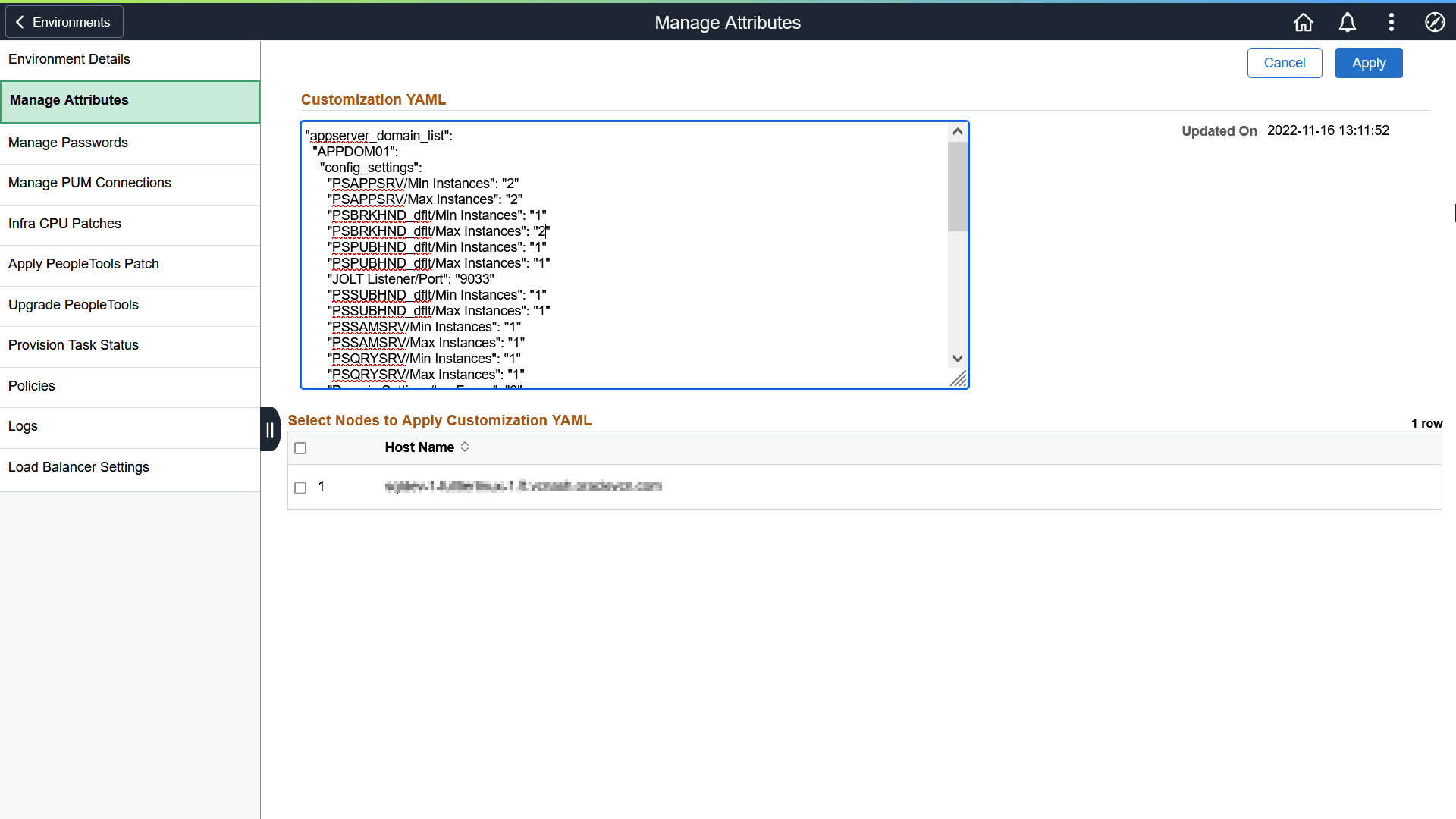

    This example illustrates the fields and controls on the Manage Attributes page that appear on clicking the Edit button.
    Customizing YAML file
  2. Modify the attributes in the application server domain, Process Scheduler domain or web server domain.

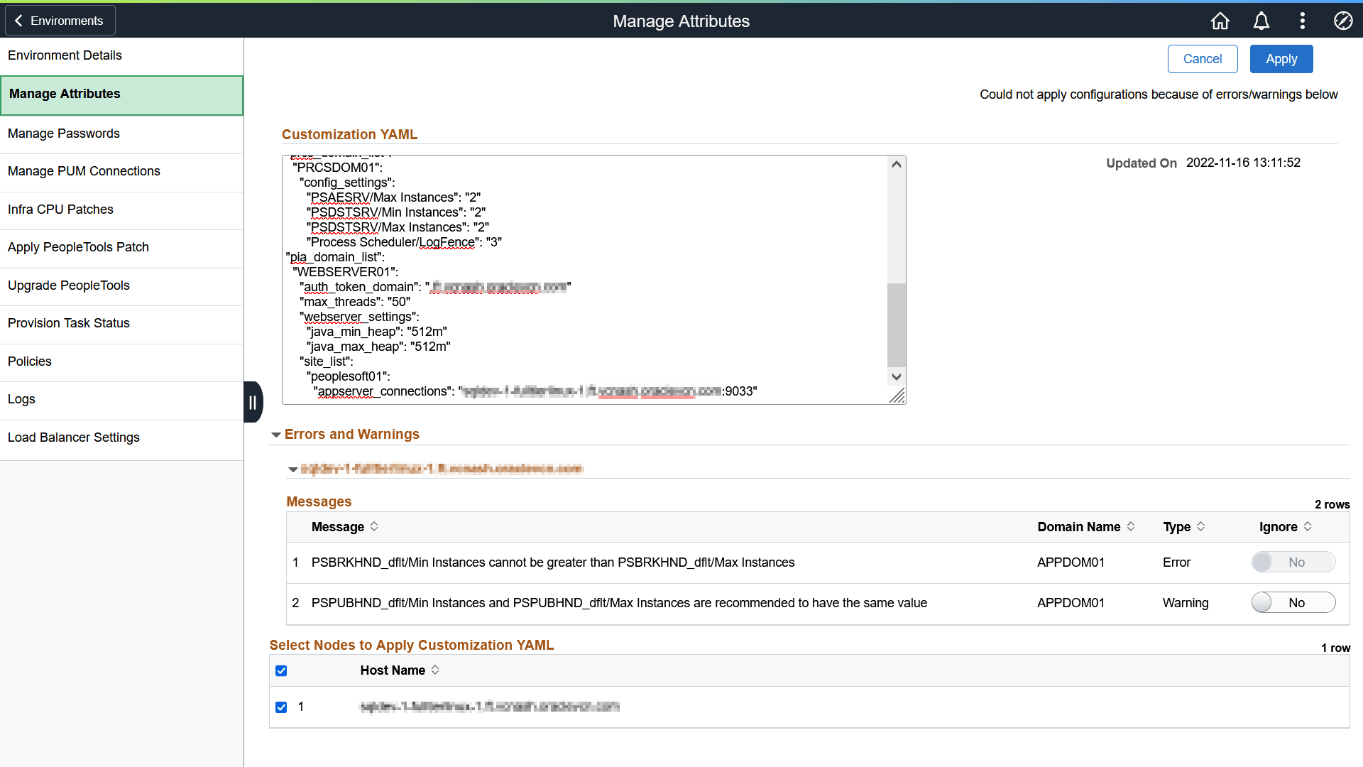

  3. Select the hosts where the customization must be applied on the Select Nodes to Apply Customization YAML section.
  4. Click Apply. The system displays errors and warnings related to the update, if any. You can choose to ignore warnings, but the errors must be resolved.
    This example illustrates the errors and warnings on the Manage Attributes page that appear on clicking the Apply button.
    Errors and Warnings on applying customization YAML

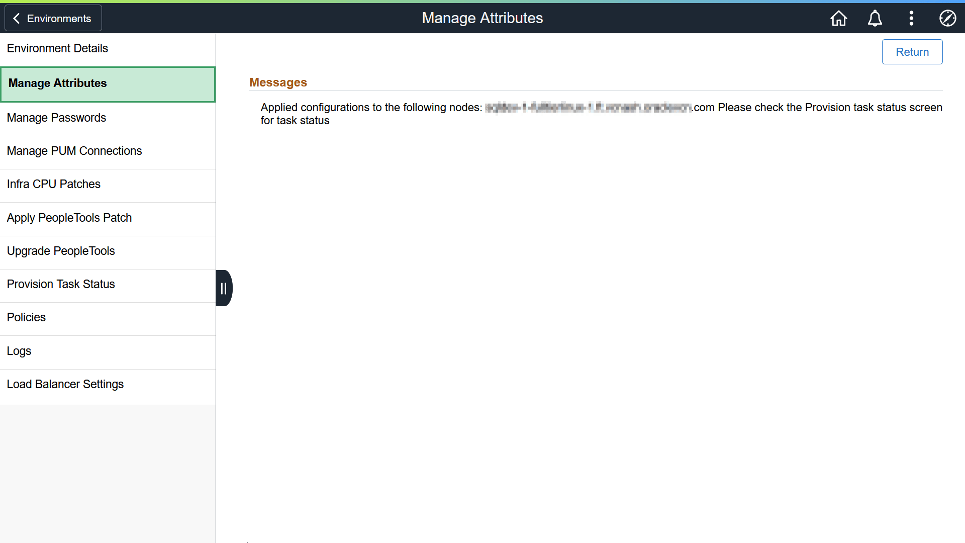

  5. Click Apply after resolving the errors. The system displays a confirmation message.
    This example illustrates the confirmation message on the Manage Attributes page that appears after all the errors are successfully resolved and warnings are resolved or ignored.
    Confirmation message
  6. Check the Provision Task Status page for the status of application of custom configurations, where the status of deployment task activities is displayed along with their start and end times. See Viewing Provision Task Status.
    You cannot modify the configuration of an instance until the tasks in progress for applying the configuration are completed.
You can find the status of applying custom configurations on the Provision Task Status page. If the task fails, a Failed icon appears in the task Status column. If an environment fails due to the presence of faulty values in the Customization YAML, you must revert the configuration files corresponding to the attributes that were modified in the YAML, followed by reconfiguring the domains where attributes are modified, so that the environment can be restarted successfully. Reverting configuration files to the latest backup file is done from PS_CFG_HOME.

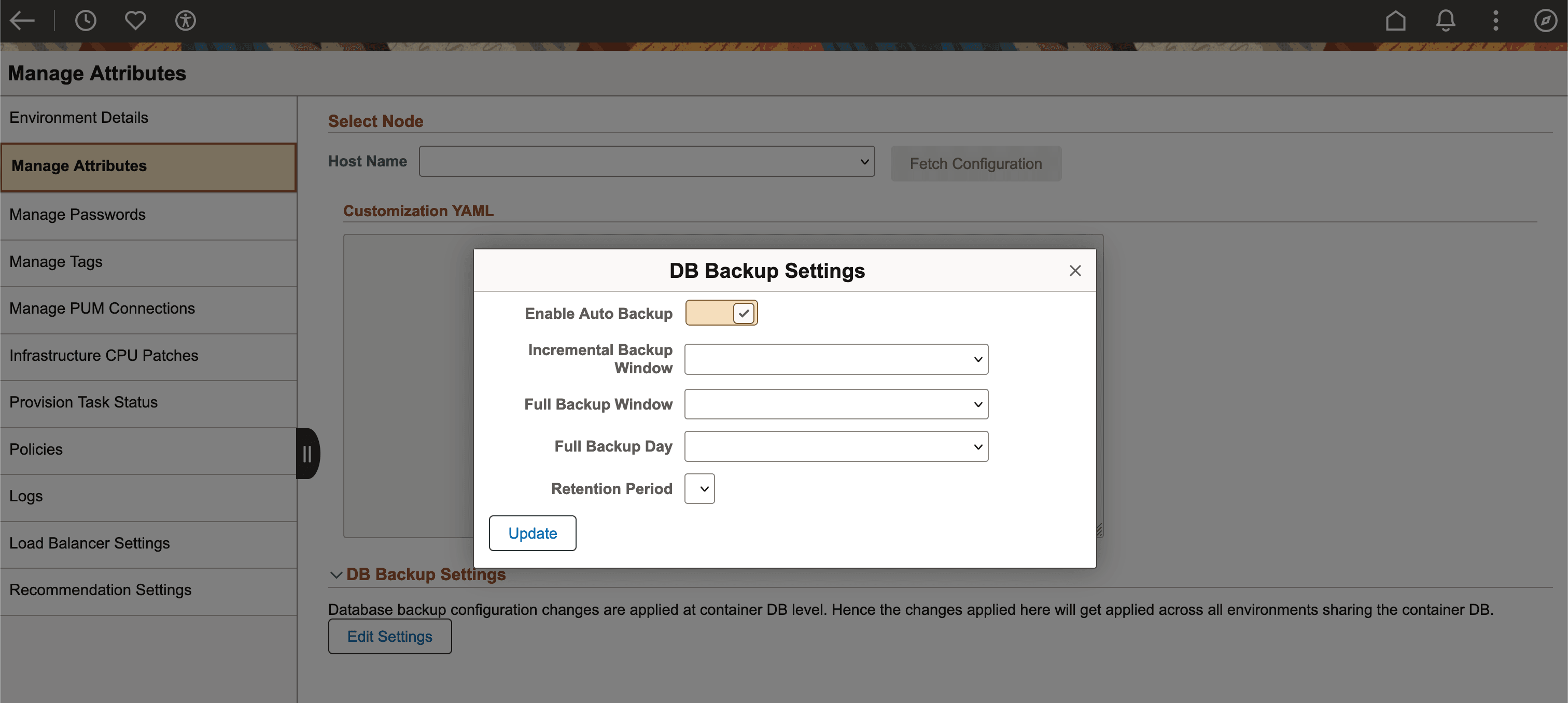

You can use this section to configure DB backup settings for DBS-based environments and imported environments.
Cloud Manager supports backup and restore of DBS-based environments that have single or multiple Pluggable Databases (PDB) in a Container Database (CDB). The prerequisite for this is that auto-backup must be enabled for the CDB containing the environment's PDB.
To update database backup settings:
  1. Expand the DB Backup Settings section and click Edit Settings.
  2. Select the appropriate settings on DB Backup Settings window.
    This example illustrates the fields and controls associated with DB Backup Settings on the Manage Attributes page. This section is enabled only for DBS-based environments. You can find definitions for the fields and controls later on this page.
    DB Backup Settings
    Field or Control
    Description
    Enable Auto Backup
    Select to enable automatic backup. This must be selected to enable the backup of DBS-based environments that have multiple PDBs in a CDB.
    Incremental Backup Window
    Select the time window for performing incremental backup.
    Full Backup Window
    Select the time window for performing full backup.
    Full Backup Day
    Select the day for performing full backup.
    Retention Period
    Select the period for which the backup of an environment is retained.
    Important! The extent of restore is controlled by the retention period of automatic backup configuration.
  3. Click Update. The settings are updated.
It may take up to 24 hours for newly deployed or refreshed PDBs to be fully available in OCI. Therefore, you must wait for up to 24 hours for the PDB to synchronize before attempting Restore action. Similarly, due to a limitation in OCI you can restore just one PDB at a time and parallel restoration of environments that share the same CDB is not possible.
