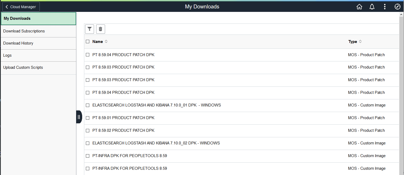

Use the My Downloads page (ECL_REPO_AMYDLS_FL) to view the artifacts downloaded. New entries are added as soon as new artifacts are downloaded.
Navigation:
Click the Repository tile on the delivered Cloud Manager Fluid home page. My Downloads page is displayed by default.
This example illustrates the fields and controls on the My Downloads page. You can find definitions for the fields and controls later on this page.
My Downloads page
Note: Clicking an item in the My Downloads page displays additional details of the downloaded artifact.
Field or Control
Description
Filter icon
Use the Filter icon to refine the search results based on search criteria.
Delete icon
Use the Delete icon to delete downloaded PIs and PRPs. Select the check box corresponding to the row you want to delete, and then click Delete button.
Name
Name of the downloaded artifact.
Type
Indicates the artifact type such as PeopleSoft Update Image, PRP, Custom Image, and so on.
Product
Indicates the PeopleSoft application product pillar.
Release
Indicates the PeopleSoft application release.
Version
Indicates the application PeopleSoft Update Image version.
Platform
Indicates the Operating System platform, such as Linux, or Windows.
Size
Total size of the PeopleSoft Update Image or PRP.

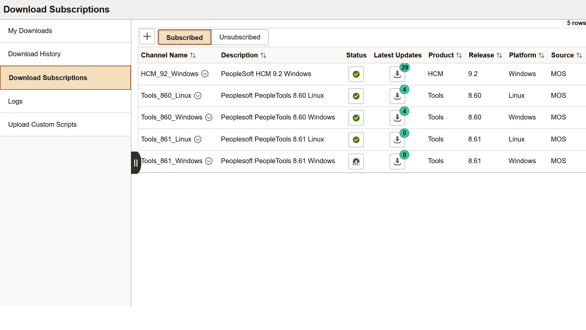

Use the Download Subscriptions page (ECL_REPO_BCHNL_FL) to subscribe to download channels and initiate downloads.
Note: Cloud Manager delivers default channels and those channels are available in the unsubscribed list of the Download Subscriptions page.
Navigation:
Click the Repository tile on the delivered Cloud Manager Fluid home page. Select the Download Subscriptions tab in the left panel of the Cloud Manager home page.
This example illustrates the fields and controls on the Download Subscriptions page. You can find definitions for the fields and controls later on this page.
Field or Control
Description
Related Actions button
To subscribe or unsubscribe channel, click the Related Actions button corresponding to the channel name. If you select the Subscribe option, Cloud Manager starts monitoring for any new PIs or PRPs and downloads them from My Oracle Support. If you select the Unsubscribe option, Cloud Manager will no longer monitor or download latest PeopleSoft Update Images or PRPs.
When a release channel is subscribed, Cloud Manager invokes the download manager application, which connects to MOS and downloads latest updates for the release channel. Note that artifacts, such as Update Images, are large in size and can take a few hours to download. User can view the status of active downloads from the Download History page.

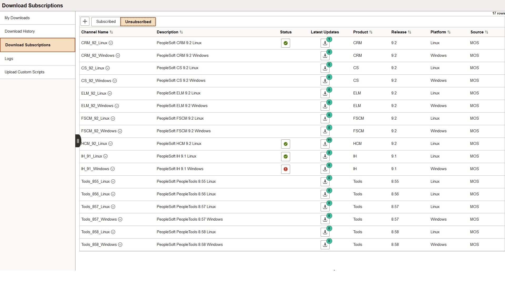

Subscribed tab
Click this tab to view a list of subscribed channels.
When you select the Related Action to subscribe to a channel, that channel will be added to the Subscribed tab.
Note: This operation will renew the channel subscriptions for all channels present in the Subscribed tab. This means that Cloud Manager will check for updates and download them for all channels present in the Subscribed tab.
Unsubscribed tab
Click this tab to view a list of unsubscribed channels. By default, newly created download channels are listed under the Unsubscribed tab.
Status
Success
In-progress
Failed
Status will indicate current state.
  • Success
    The Success icon indicates the download was successful. No further action is necessary.
  • In-progress
    The In-progress icon indicates the update is downloading. Click on the icon to view the status of the download.

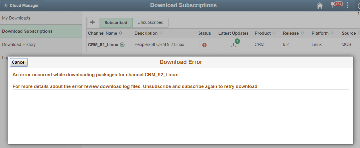

  • Error
    The Error icon indicates the download failures. Click the icon to open the Download Error page.
This example illustrates the fields and controls on the Download Subscriptions – Unsubscribed page. You can find definitions for the fields and controls later on this page.
Download Subscriptions - Unsubscribed page
Use the related actions button to subscribe to a channel.
Download Error Page
Click the failed icon on the Download page to view the Download Error pop-up page. There are two types of error pop-up pages, one for standard errors and another for invalid password. The invalid password pop-up page only applies to password protected downloads.
This example illustrates the fields and controls on the Download Error page. You can find definitions for the fields and controls later on this page.
Download Error page
The download error message will indicate the error and direct the user to review the download log files. Error could be due to issues occurring during the download, such as network connection disruption (unable to reach MOS) or if there is no space available on the file server to save downloads.

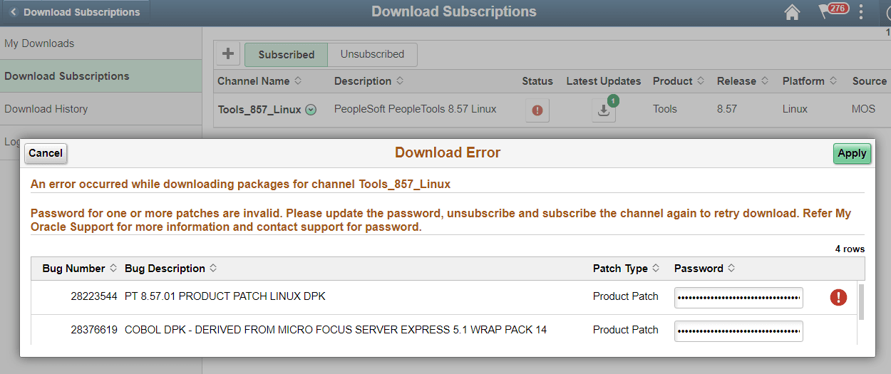

Password Protected Subscription Password Error
When you subscribe to the a password protected download channel, the DownloadAssist file is downloaded from MOS to Cloud Manager. The DownloadAssist file contains the password required to download the packages.
This example illustrates a Download Error page displaying a password error.
Download Error for Password Error
This message will only appear if Cloud Manager is unable to retrieve the password due to an error in MOS. If this does occur, the user will need to request the password from Support and update it manually on this page.
If the issue is due to an expired password, the user can unsubscribe from the channel and then re-subscribe to the channel. Any password changes will be updated in the DownloadAssist file that is posted in MOS. On re-subscribing to a channel, the new password should get automatically updated in Cloud Manager.
If a re-subscribing doesn't solve the problem, then there could be issues in Cloud Manager that is failing to retrieve and update the password automatically or an unforeseen issue in MOS which is not allowing the download of the DownloadAssist file. In such a scenario, the user is expected to get the password from support and update the same on the Download Error page.
Note: The next scheduled download will renew the subscription and include any password changes in the DownloadAssist file. See Changing Download Interval

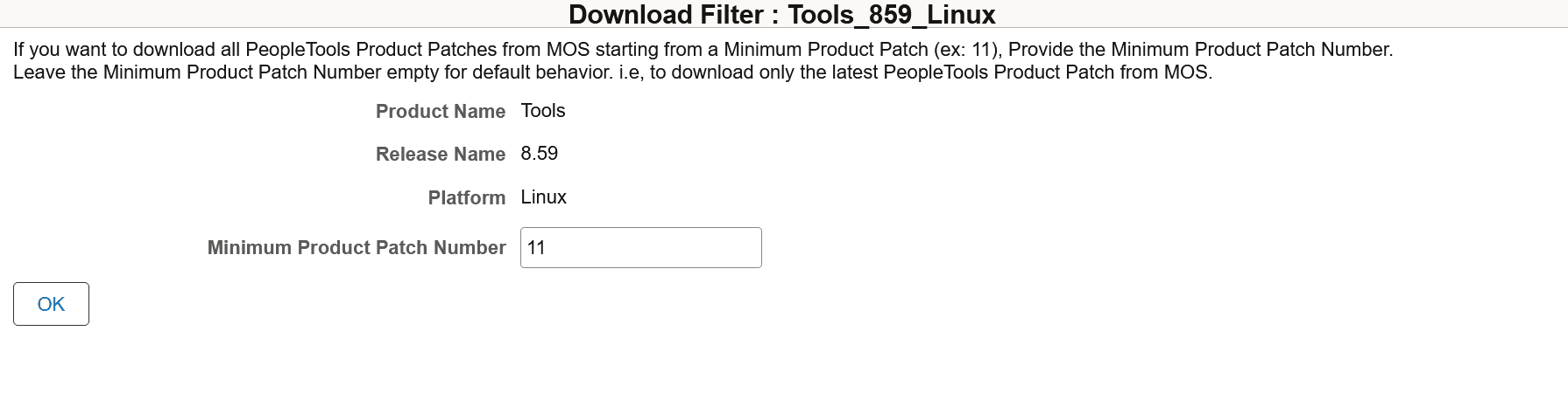

Cloud Manager can download previous PeopleTools patch releases for the PeopleTools channel. But for Application channels, only latest images (patches) get downloaded.
In case of PeopleTools channel subscription, you are presented with a modal window for selecting the patch version you want to download.
Navigation:
Click the Unsubscribed tab. Select any Tools channel. Click the Related Options menu and select Subscribe.
This example illustrates the fields and controls in Download Filter modal window.
Download Filter Modal Window
Enter the required product patch version in the Minimum Product Patch Number field. For example, if user enters 11 in this field, then Cloud Manager will download PeopleTools patches 8.59.11, 8.59.12, 8.59.13 up to the latest.

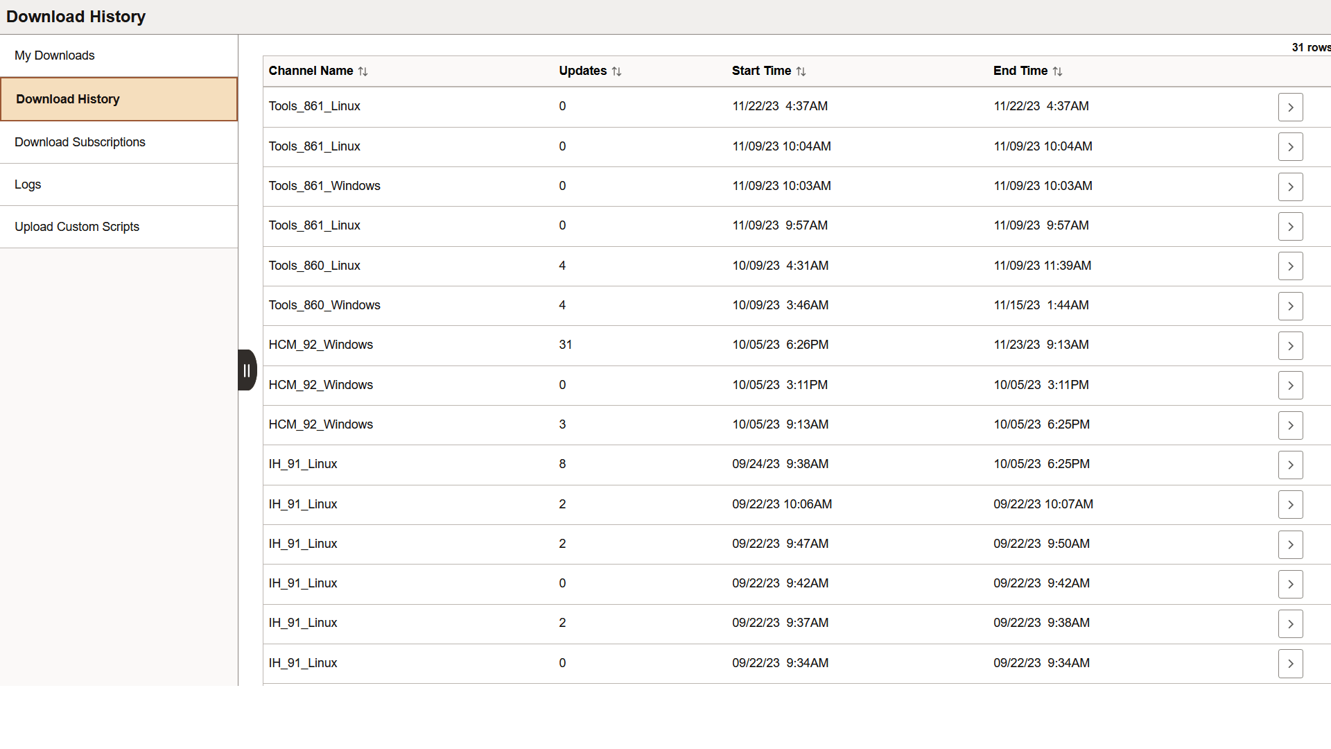

Use the Download History page (ECL_REPO_BDLHIS_FL) to view the history of downloads.
Note: The entries in Download History page are updated based on the download interval. Clicking an entry in the Download History page displays the current state of the download channel (that is, a list of files already downloaded, another list of files in the download queue and those that are currently downloading).
Navigation:
Click the Repository tile on the delivered Cloud Manager Fluid home page. Select the Download History tab in the left panel of the Cloud Manager home page.
This example illustrates the fields and controls on the Download History page. You can find definitions for the fields and controls later on this page.
Field or Control
Description
Channel Name
Name of the download channel.
Updates
Number of updates downloaded.
Start Time and End Time
Indicates the time when downloads are started/finished for the release channel.

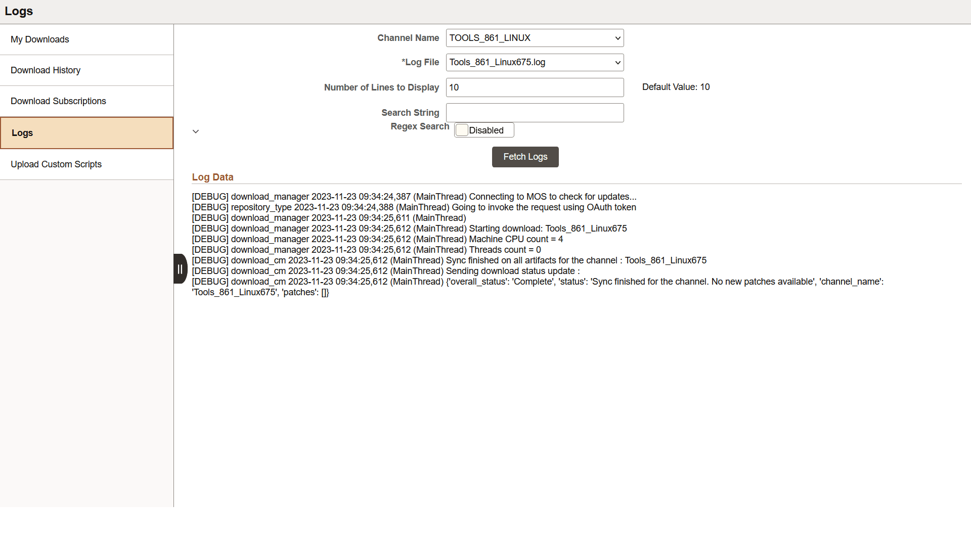

Use the Logs page (ECL_REPO_MLOG_FL) to view the download logs corresponding to the subscribed channels. It displays download logs for all the files that get downloaded.
Navigation:
Click the Repository tile on the delivered Cloud Manager Fluid home page. Select the Logs tab in the left panel of the Cloud Manager home page.
This example illustrates the fields and controls on the Logs page. You can find definitions for the fields and controls later on this page.
Logs page
Field or Control
Description
Channel Name
Name of the subscribed channel.
Log File
Log files are generated when a channel is subscribed. Select an appropriate log file in this field.
Number of Lines to Display
Indicates how many lines of the selected log file to be displayed.
Search String
Used to search for specific keywords in the log file. When user inputs a keyword, such as "ERROR" as an example, then only those lines are displayed which has an Error string in it. Here, only the specified number of lines are displayed.
Regex Search
Enables advanced searching, where a user can provide Unix style regular expressions.
Fetch Logs button
Click this button to fetch log data based on the input provided by the user in the Logs page.
Log Data
Data from the logs.

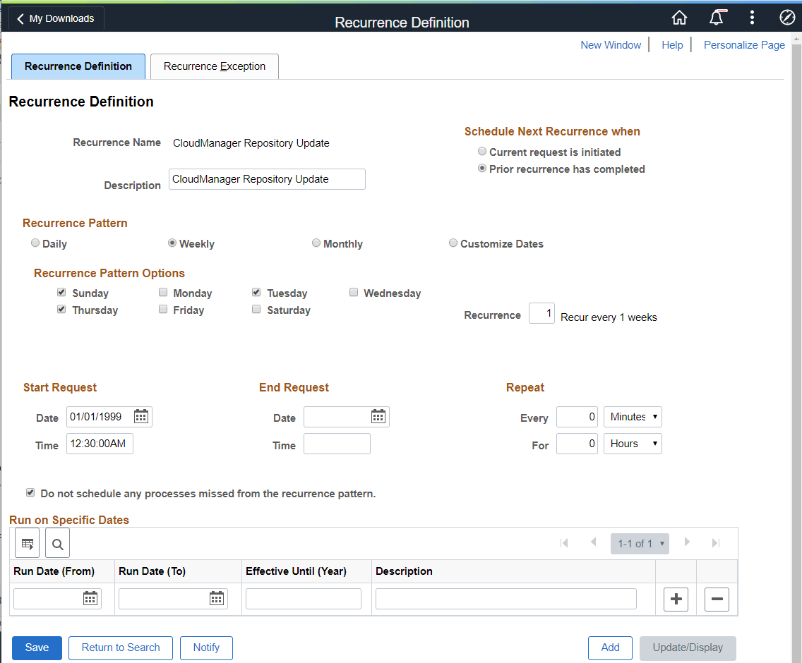

By default, Cloud Manager polls My Oracle Support for new updates every week. The recurrence definition for download channel subscriptions is CloudManager Repository Update. To modify the download schedule to meet your organizational needs, modify the recurrence pattern to a pattern that meets your needs.
For example, if you want to poll for updates on alternate days, you would perform the following:
  1. In Cloud Manager, navigate to PeopleTools, Process Scheduler, Process Scheduler Recurrences.
  2. Select the recurrence CloudManager Repository Update.
  3. Select Recurrence Pattern to Weekly.
  4. Select the alternating days as in Monday, Wednesday, and Friday or Sunday, Tuesday, Thursday.
    Note: It is recommended to select alternate days.
  5. Save the page.
This example illustrates the fields and controls on the Recurrence Definition – Cloud Manager Repository Update where the occurrence is set to alternate days.
Recurrence Definition - CloudManager Repository Update
For more information on setting up recurring schedules, see Product documentation for PeopleTools: Process Scheduler, “Defining PeopleSoft Process Scheduler Support Information”, Defining Recurrence Definitions.

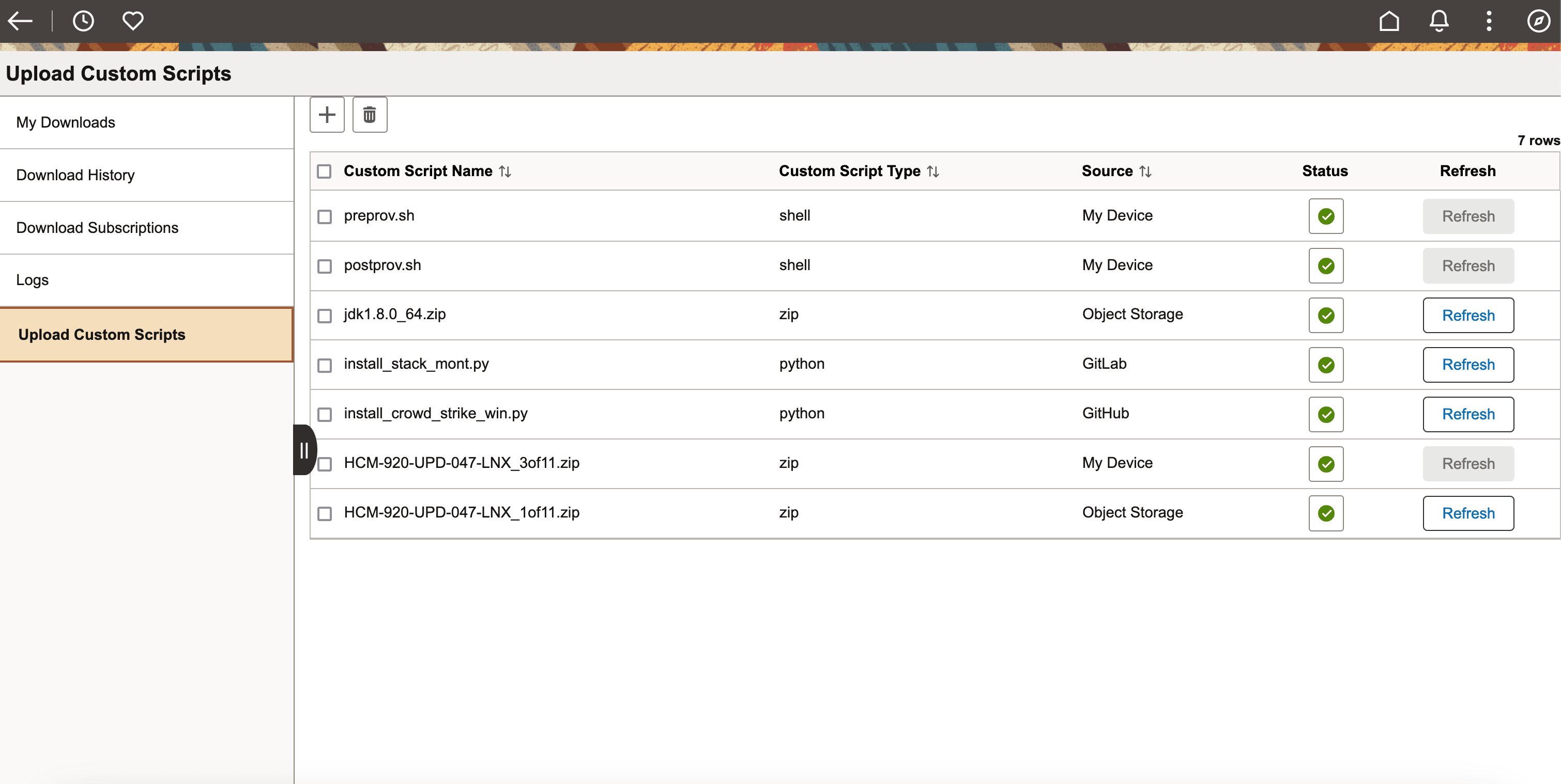

Starting with Cloud Manager Update Image 8 custom scripts can be run before or after provisioning a PeopleSoft environment.
Note: After a PeopleTools upgrade, you must edit the webserver property (configuration.properties) file to add or modify the HttpRepositoryPath as shown here: HttpRepositoryPath=/opt/oracle/psft/customscripts
This table lists the script types and which tiers they can run on.
Script Type
Where you can run the script
Python
Full Tier
Middle Tier
Database Tier
PeopleSoft Client
Search Stack
Database as a service (DBaaS)
Shell
Full Tier
Middle Tier
Database Tier
Search Stack
Batch
PeopleSoft Client and Windows Middle Tier
PowerShell
Windows Client and Windows Middle Tier
Scripts can contain instructions to call and run one or more other scripts. For example, a shell script can invoke multiple shells, Python, or other scripts. You can also upload any kind of supporting files that are used by the scripts.

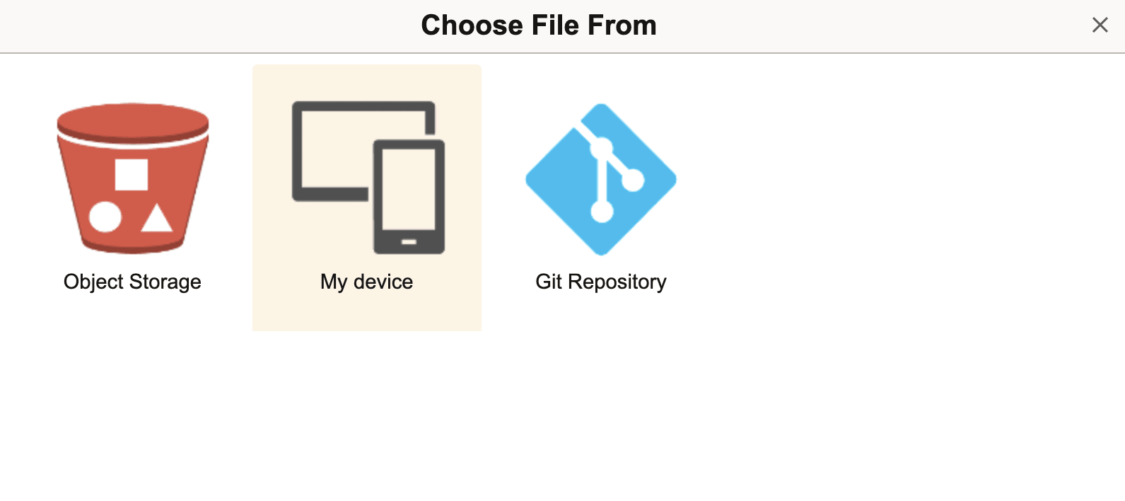

To upload a custom file:
  1. From Cloud Manager homepage, select the Repository tile.
  2. Select Upload Custom Scripts.
  3. Click the Add icon.
  4. The File Attachment pop up appears where you can choose files from object storage, your local device, or a public Git repository by clicking on the corresponding option.
    Note: You must enable firewall connectivity between Cloud Manager and your Git repository. You must also ensure that the customisation artifacts uploaded through Git, object storage or local drive are robust and secure.
    Cloud Manager does not capture the data regarding modification of settings using custom scripts and custom DPK, and the responsibility of ensuring that such modifications do not adversely affect other lifecycle activities of Cloud Manager rests with you.
    This example illustrates the options for uploading custom files on the Upload Custom Scripts page.
    Options for uploading custom file
    This example illustrates the fields and controls on the File Attachment pop up when you select Object Storage as the option for uploading custom files. You can find definitions for the fields and controls later on this page.

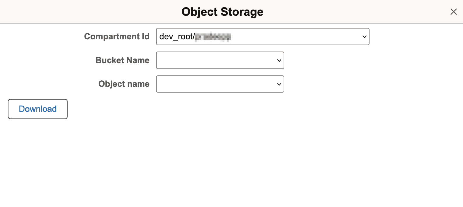

    Object Storage
    Field or Control
    Description
    Compartment Id
    Compartment where custom file is stored.
    Bucket Name
    Name of the bucket that contains the custom file.
    Object name
    Name of the object that contains the custom file.

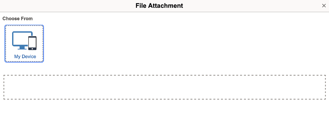

    This example illustrates the fields and controls on the File Attachment pop up for uploading custom files directly from your device.
    Uploading custom files directly from your device
    Note: The maximum supported file size for uploading custom files is 2 GB.

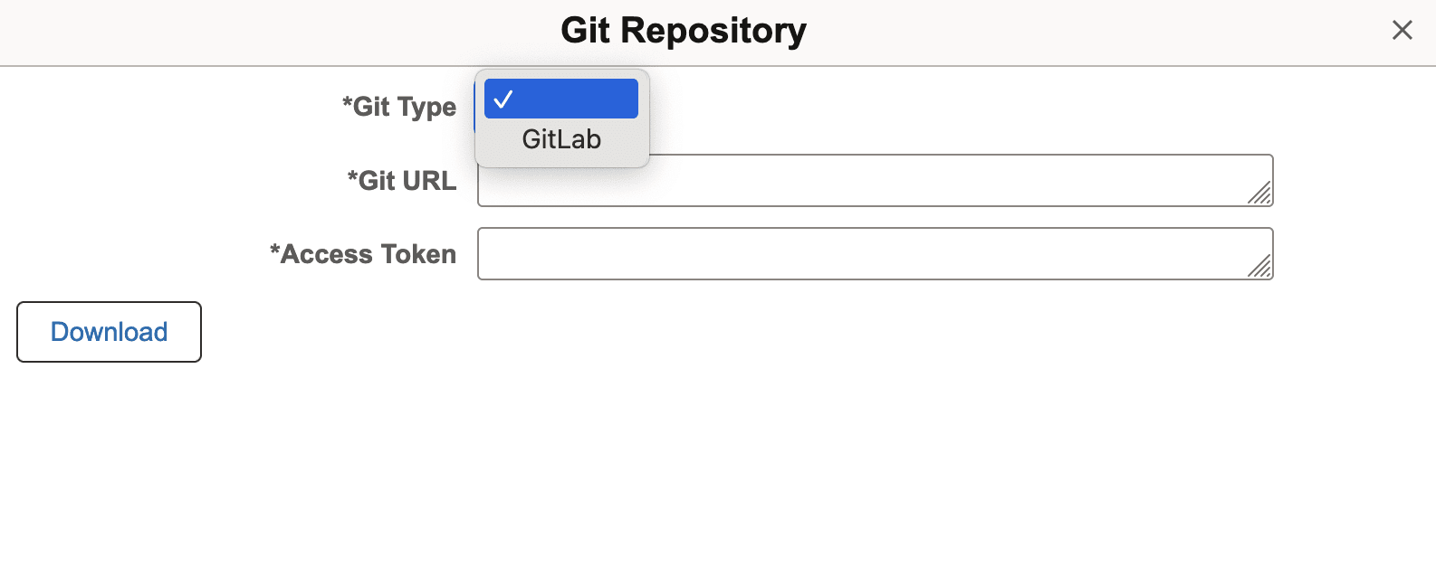

    This example illustrates the fields and controls on the File Attachment pop up for sourcing input from Git. You can find definitions for the fields and controls later on this page.
    Git Repository
    Field or Control
    Description
    Git Type
    Git Type used for sourcing input. Supported types are GitLab and GitHub.
    Git URL
    Raw file download REST APIs URL of your Git repository.
    Access Token
    Access token required by Cloud Manager for using GIT to download artifacts. Cloud Manager needs access to only the repository's raw file download API.
    Note: Access token is optional for public repository.
  5. Once you have selected the file, the Upload option appears.
  6. Click the Upload button to upload the file to Cloud Manager.
  7. When upload is complete, click Done to complete the process.
This example illustrates the fields and controls on the Upload Custom Scripts page. You can find definitions for the fields and controls later on this page.
Field or Control
Description
Custom Script Name
Name of the custom script.
Custom Script Type
Type of the custom script. Possible values are Shell, Python and Zip.
Source
Source of the uploaded custom file. Possible values are Object Storage, your local device, GitLab, and GitHub.
Status
Status of the custom script upload. File metadata of the successfully uploaded files can be viewed by clicking the Status button corresponding to the file.
Refresh
On clicking the Refresh button, Cloud Manager is updated to the latest version for Git and Object Storage sources.
If the script is relocated after you upload it or if the access token is renewed, Refresh can fail by throwing an error message related to HTTP status 401 or 404. When this happens, you must enter the new details again as you would do for a new script or file upload.
