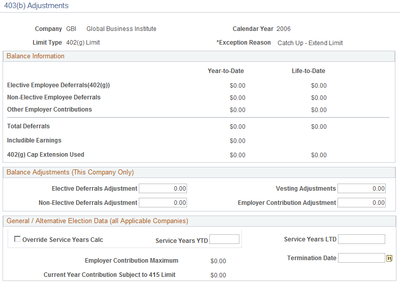

Use the 403(b) Adjustments page (SAVINGS_MGT_EE_SP1) to monitor 403(b) balances.
Review the year-to-date (IT'D) and life-to-date (LTD) balances from the 403(b) process, enter contributions made at another company, and review an employee's contribution amount for each applicable limit.
Navigation:
Click the 403(b) link on the Savings Management page.
This example illustrates the fields and controls on the 403(b) Adjustments page. You can find definitions for the fields and controls later on this page.
Balance Information
The system displays the IT'D and LTD balances calculated from the 403(b) process.
Balance Adjustments (This Company Only)
Use to enter employee contributions from a previous employer. The Calculate 403(b) Extensions process uses these figures.
Field or Control
Description
Elective Deferrals Adjustment, Non-Elective Deferrals Adjustment, and Employee Contribution Adjustment
Enter the new amounts. Both the Calculate 403(b) Extensions and Pay Calculations processes use these fields.
Vesting Adjustments
Enter the new amount. Both the Calculate 403(b) Extensions and Pay Calculations processes use these fields. A vesting adjustment is considered to be a type of employer contribution, so it is used along with the Employer Contribution YTD/LTD balance fields and the Employee Contribution Adjustment field.
General / Alternative Election Data (all Applicable Companies)
Field or Control
Description
Override Service Years Calc (override service years calculation)
Select this check box if you need to override the system-calculated Service Years IT'D field, the Service Year LTD field, or both displayed on the 403(b) Projections page.
Employer Contribution Maximum
This is the amount entered in the Maximum Yearly Deduction field located on the 415(c) Limit Table.
Termination Date (403[b] expected termination date)
If applicable, enter the date.
Current Year Contribution Subject to 415 Limit
This is the year-to-date deductions that are subject to the 415(c) limit.

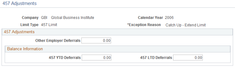

Use the 457 Adjustments page (SAVINGS_MGT_EE_SP2) to monitor the 457 catch-up limit extension and election for 457 plans.
Navigation:
Click the 457 link on the Savings Management page.
This example illustrates the fields and controls on the 457 Adjustments page. You can find definitions for the fields and controls later on this page.
457 Adjustments
This group box appears if you selected 457 in the Savings Plan Type field.
Field or Control
Description
Other Employer Deferrals
The amount deferred to a 457 plan with another employer during the years of service with the current employer.
457 IT'D Deferrals and 457 LTD Deferrals
457 year-to-date and life-to-date balances are automatically maintained as part of the 403(b) Extensions process for those employees who are enrolled in both a 457 and 403(b) plan.
