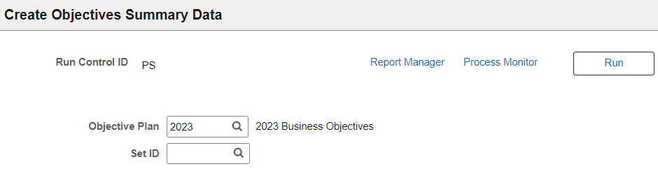

This example illustrates the fields and controls on the Create Objectives Summary Data page.
Select the objective plan and set ID (this field appears after an objective plan is specified) you want to create summary data and then click Run.
