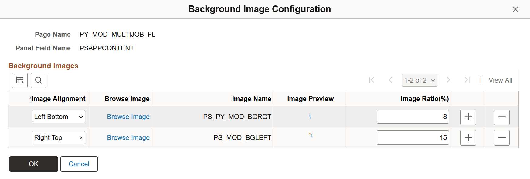

Background Image Configuration Page
PY_CFG_IMG_SEC
Upload images used in the page background.

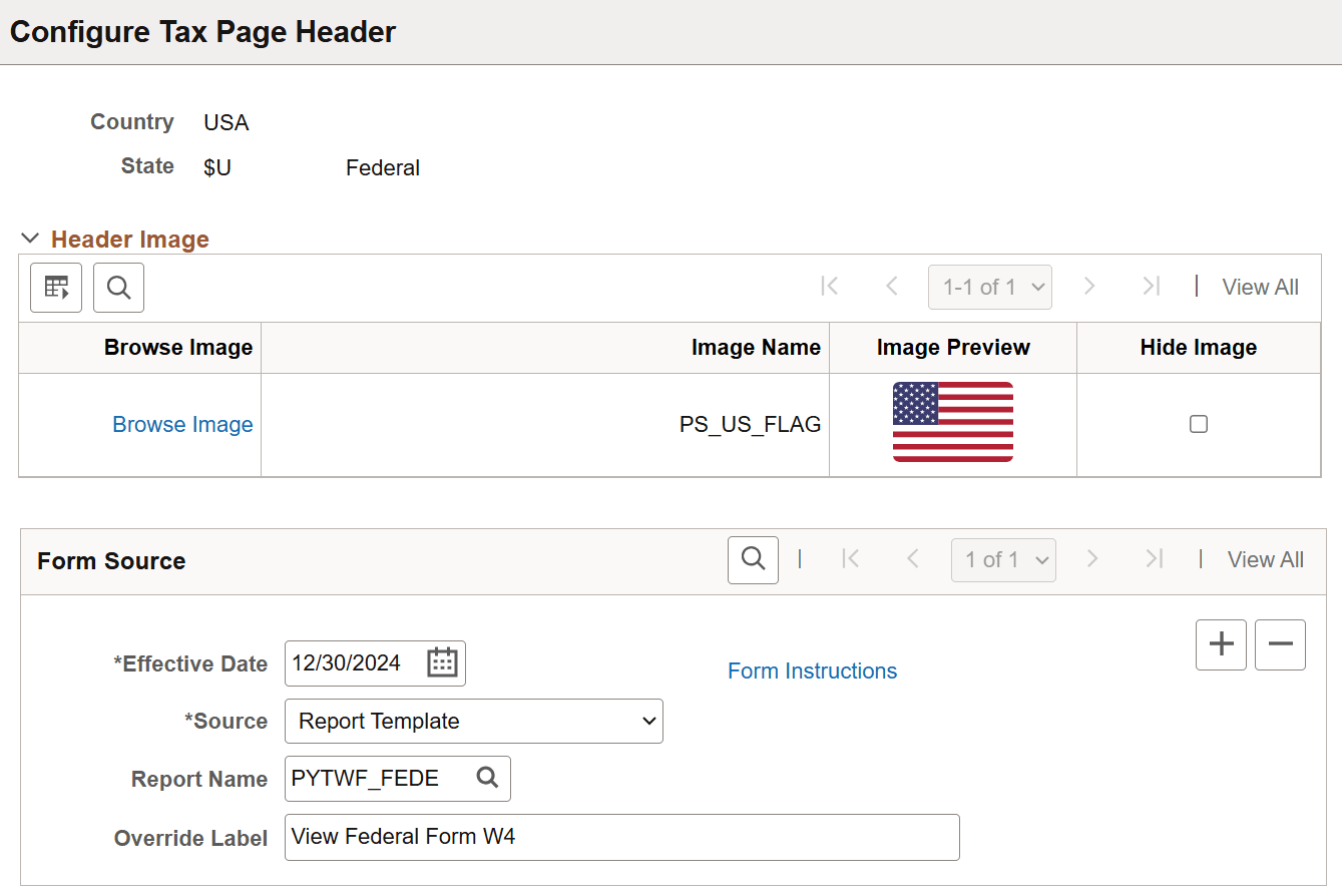

Configure Tax Page Header Page
PY_CFG_TXFRMHDR_PG
Set up the page header for Paycheck Modeler tax withholding pages.

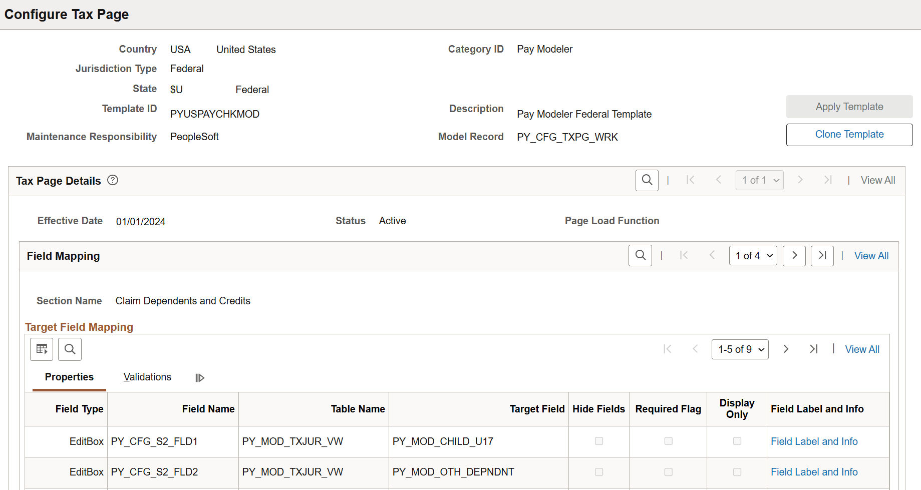

Configure Tax Page Page
PY_CFG_TAX_PG
Set up display and text options for Paycheck Modeler tax withholding pages.

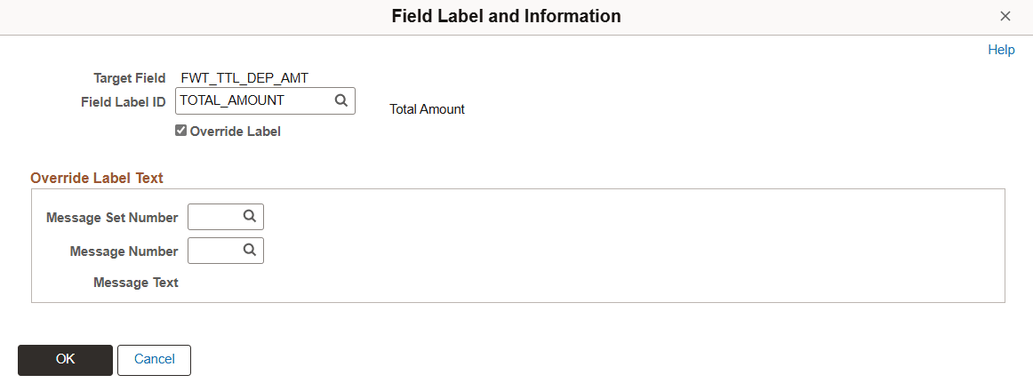

Field Label and Information Page
PY_CFG_TAX_FLDINFO
View or update section field labels.

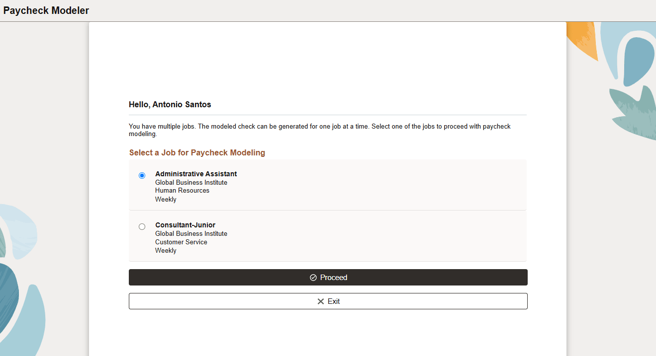

Paycheck Modeler - Select a Job Page
PY_MOD_MULTIJOB_FL
Choose a job for the paycheck simulation.

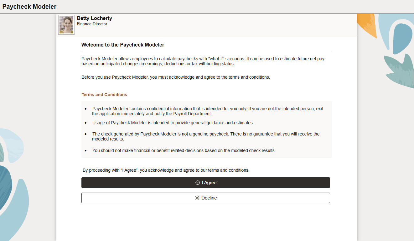

Paycheck Modeler - Welcome Page
PY_MOD_START_FL
Acknowledge the usage terms and conditions of Paycheck Modeler.

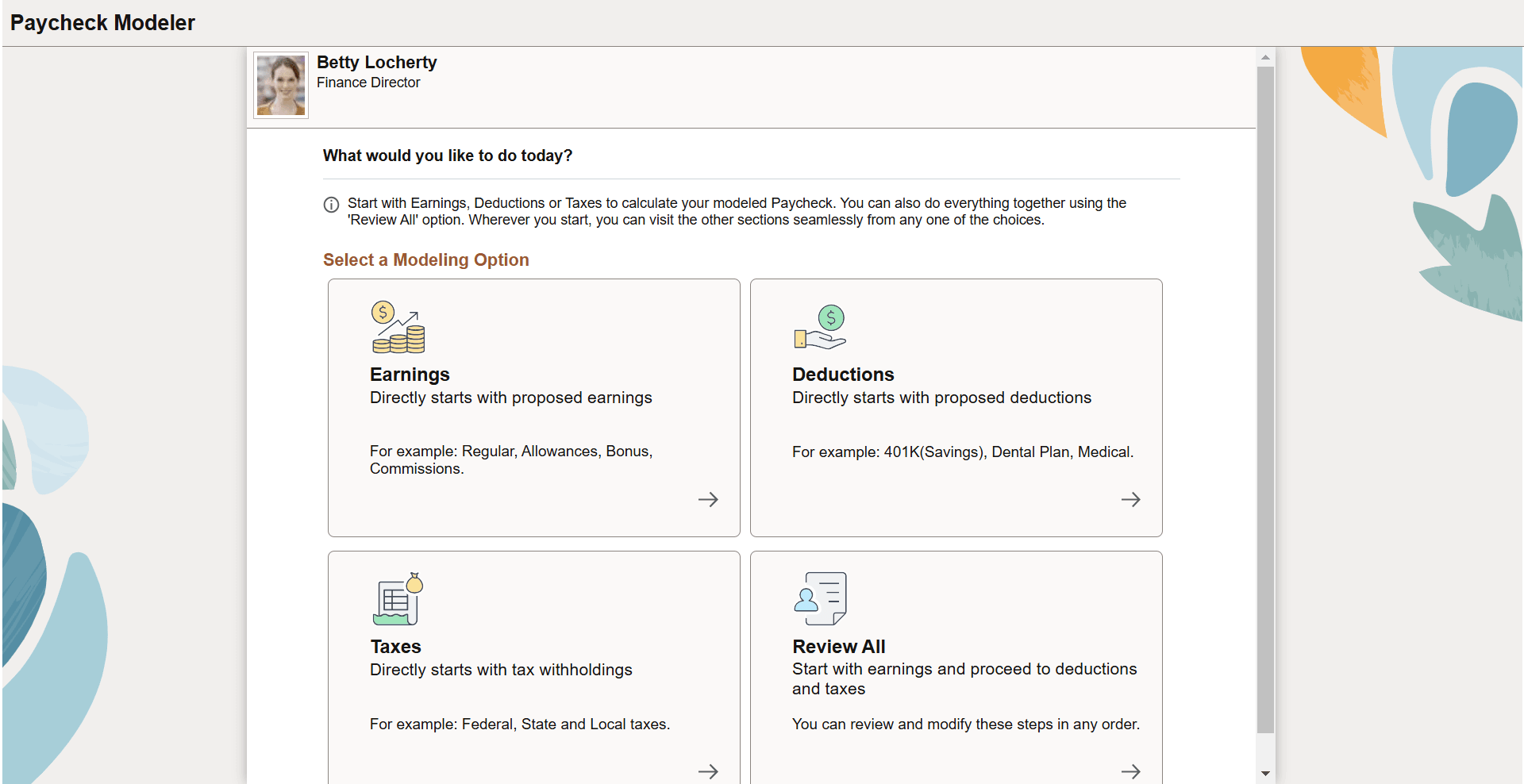

Paycheck Modeler - Decision Page
PY_MOD_SEL1_FL
Select the starting point of the modeling process.

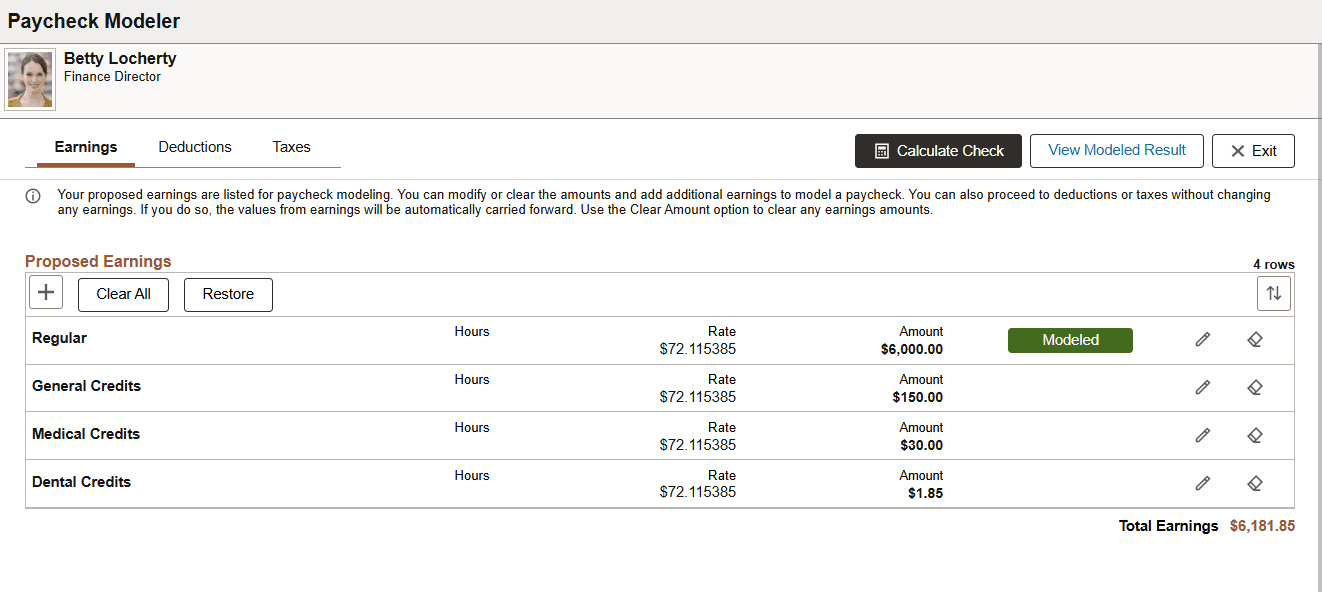

Paycheck Modeler - Earnings Page
PY_MOD_EDTL_FL
Modify earnings information for the modeled paycheck calculation.

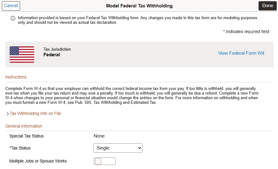

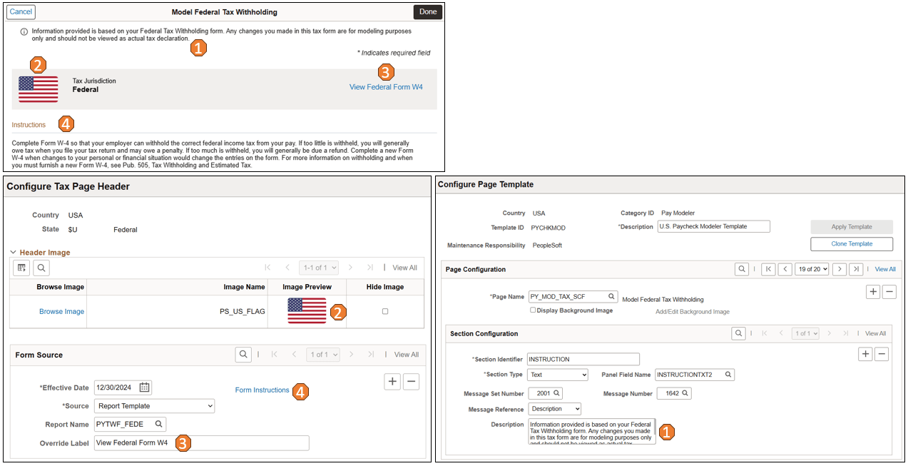

Model Federal Tax Withholding Page
PY_MOD_TAX_SCF
Modify federal tax withholding information for the paycheck calculation.

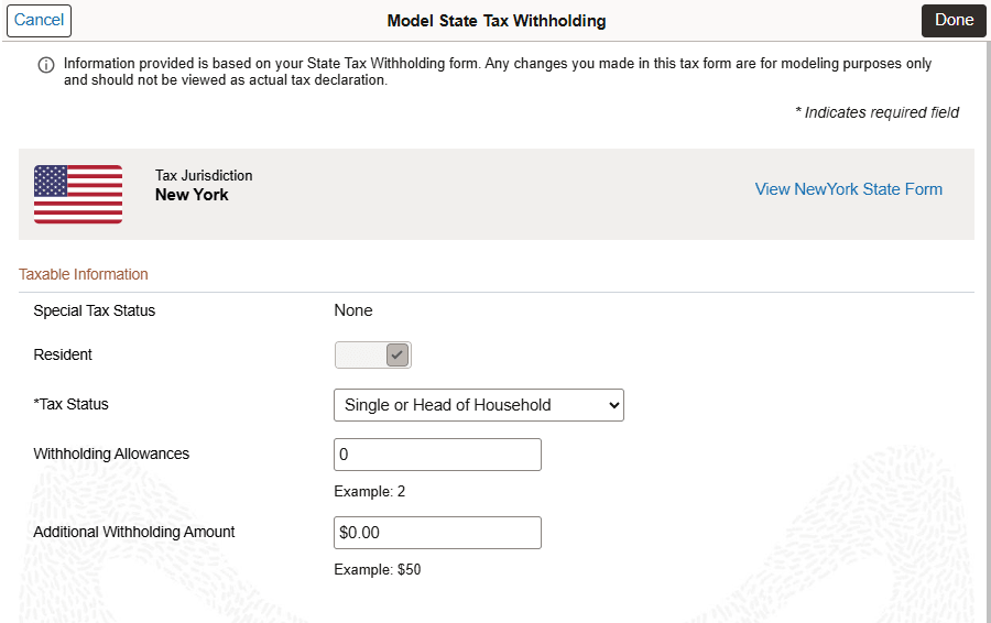

Model State Tax Withholding Page
PY_MOD_ST_TAX_SCF
Modify state tax withholding information for the modeled paycheck calculation.

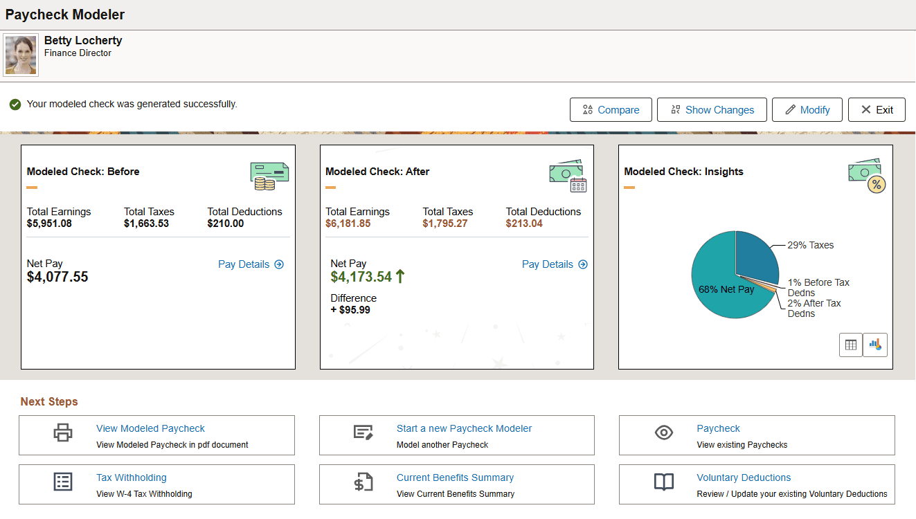

Paycheck Modeler - Results Page
PY_MOD_RSLT_FL
View the modeled paycheck results.

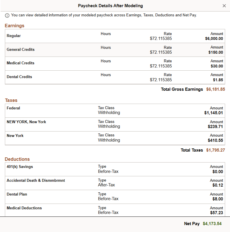

Paycheck Details Page
PY_MOD_CALRSLT_SCF
View details of the corresponding paycheck.

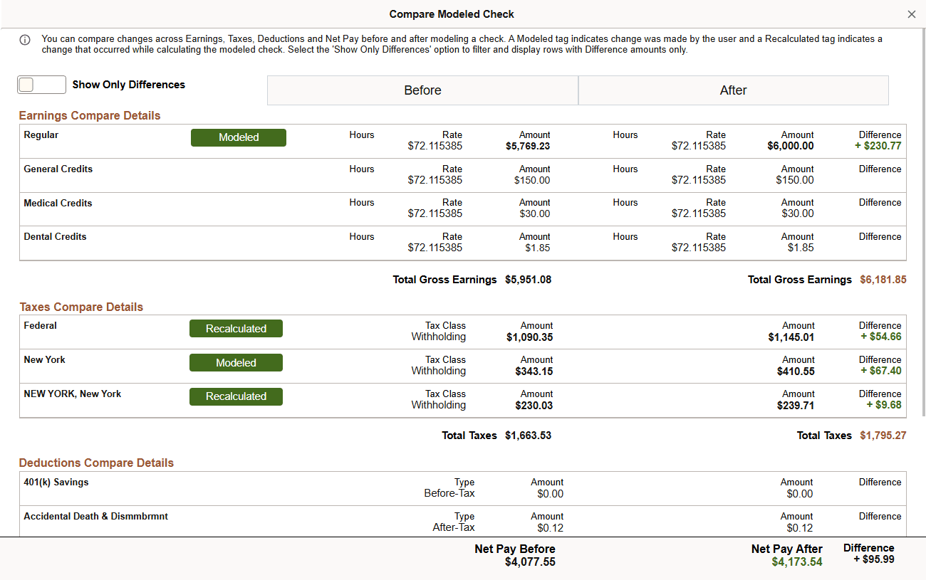

Compare Modeled Check Page
PY_MOD_CMP_RSLT_FL
View paycheck details before and after the paycheck modeling process.
View Modeled Changes Page
PY_MOD_AUDIT_SCF
View changes made in the paycheck modeling process.
Fluid Paycheck Modeler enhances the paycheck modeling process, providing employees a modern and intuitive user interface to simulate paychecks with their what-if scenarios.
Employees can use Paycheck Modeler to get quick estimates on their net pay based on changes in earnings, deductions, or tax withholding that they anticipate in life. For example, an employee is aware that a big bonus is coming. They can use the paycheck modeling tool to estimate future net pay with the bonus included and see if it is sufficient to fund a family trip.
To support the paycheck modeling process more effectively, Fluid Paycheck Modeler:
  • Updates the design of the pages to improve user experience. It:
    • Provides users the option to choose the starting point of the process.
    • Adds visual indicators to help users identify where changes are made during the process.
    • Allows users to calculate the modeled check at any time when a change is made in earnings, deductions, or tax withholding, without the need to go through all the pages unnecessarily.

  • The Next Steps section on the Paycheck Modeler - Results Page is display only.

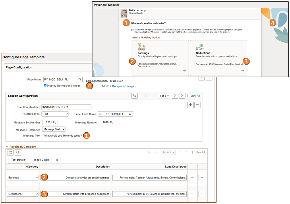

Page Configuration
PeopleSoft delivers a page configuration template (PYCHKMOD for U.S. Payroll) that enables the dynamic rendering of details of pages used in Paycheck Modeler. Depending on the nature of the page, configuration options are available to manage page displays, such as instructional texts (which are displayed with the Information icon), page information, background color and image, for these pages:
This image illustrates the relationship between page elements of Paycheck Modeler page and where they were configured on the page configuration.
Payroll Modeler page and corresponding page configuration
From the Paycheck Modeler page image (top screenshot), each page element that has an assigned number is controlled by the field on the configuration page (bottom screenshot) with the same assigned number.
Administrators can create custom templates to modify the look and feel of pages based on their requirements by cloning from the system-delivered template.
Tax Form Page Configuration
Additionally, PeopleSoft delivers tax page configuration to support the dynamic rendering of details for federal, state, and local tax withholding pages that are available on the Paycheck Modeler - Taxes Page. These setup pages include:
  • Configure Tax Page Header Page, specifying the image, tax form report template, and tax form instructions used for the tax withholding page, which are displayed in the header area of the page.
    The system delivers page header setup for federal and state withholding pages.
  • Configure Tax Page Page, which includes what appears on the withholding page, such as page sections, as well as fields and texts included in each section.
    The system delivers tax page setup for federal, state, and local tax withholding pages. Administrators can create custom tax page configuration to modify tax page display based on their requirements by cloning from the delivered templates.
    Note: The system does not deliver configuration setup for states that do not have state income tax, with an exception for Washington. A system-delivered template for WA is available to support paycheck modeling on paid family and medical leave tax classes for the state of Washington.
This image illustrates the relationship between page elements on the header of a tax withholding page and where they were configured on the tax page header and page template pages.
Paycheck Modeler tax page header and corresponding page header configuration
From the page header image, each page element in the federal tax withholding page header (top screenshot) that has an assigned number is controlled by the field on a configuration page (either bottom screenshot) with the same assigned number.
This image illustrates the relationship between page elements on a tax withholding page and where they were configured on the tax page configuration.
Paycheck Modeler tax page and corresponding tax page configuration
From the page section image, each page element in the Claim Dependents and Credits section of the federal tax withholding page (top screenshot) that has an assigned number is controlled by the field on the configuration page (bottom screenshot) with the same assigned number.

Use the Configure Page Template page (PY_CFG_TMPL_PG) to set up display and text options for Paycheck Modeler pages.
Navigation:
Set Up HCM > Common Definitions > ePay Configuration Framework > Configure Page Template > Configure Page Template
This example illustrates the fields and controls on the Configure Page Template page.
Oracle delivers the PYCHKMOD template to configure Paycheck Modeler pages for U.S. Payroll.
Field or Control
Description
Apply Template
Select to use this template to render the Paycheck Modeler pages of the specified country and category. For example, use this button to switch to use a custom template you just updated,or back to the delivered template if preferred.
This field is read-only if the template you're viewing is the one used for page rendering already.
Clone Template
Select to create a new template by cloning from template you're viewing.
Note: If customers wish to create their own templates to modify the look and feel of the pages used, Oracle recommends that they create customer-maintained templates by cloning from the delivered template, and make updates in the new templates as desired.
Page Configuration
Field or Control
Description
Page Name
Select a page to be configured as part of the template.
Display Background Image
Select to enable the display of a background image on the specified page.
Add/Edit Background Image
Select to add background images for the specified page on the Background Image Configuration Page. This link becomes available when the Display Background Image field is selected.
Section Configuration
Field or Control
Description
Section Identifier
Specify a name to identify the section. Some section identifiers included in the delivered template include BACKGROUNDCOLOR and INSTRUCTION.
Section Type
Select the type of section configuration. Available values are:
Background Color
HTML
Text
Panel Field Name
Select the panel field to which the configuration applies.
Theme
Select how the background color of the page is specified. Values are:
Color Code: When selected, enter a hex code for the color in the Hexadecimal field that appears.
Solid Color: When selected, choose a color from the Color field that appears.
This field appears if the selected section type is Background Color.
HTML Code
Enter the HTML code for the display.
This field appears if the selected section type is HTML.
Add Bind Values
Enter bind values that are included in the HTML code on the Add Bind Values page (PY_CFG_HTMLBIND_PG).
This link appears if the selected section type is HTML.
Message Set Number and Message Number
Specify the Message Catalog set number and number of the text (for example, instructional text) to use, if desired.
This field appears if the selected section type is Text.
Message Reference
Select to display text from a free-form description field or a Message Catalog entry. Values are:
Description
Message Text
Description
Enter free-form text.
This field appears if the selected message reference type is Description.
Message Text
Displays the message text of the specified message set number and message number.
This field appears if the selected message reference type is Message Text.
Paycheck Category
This section controls which:
Field or Control
Description
Category
Select a category to appear on the selected page as a card. Available values change based on the selected page.
Values for PY_MOD_RSLT_FL are:
Modeled Check After
Modeled Check Before
Modeled Check Insights
Values for PY_MOD_SEL1_FL are:
Deductions
Earnings
Review All
Taxes
Description and Long Description
Enter a short and a long description of the category. The short description is used as the title of the card.
Browse Image
Select the link to choose a graphic for the specified category on the Browse Image Catalog page.
For more information about the Image Catalog, refer to PeopleTools: Portal Technology, "Administering Portals," Browsing the Image Catalog.
Image Name and Image Preview
Displays the name and image of the selected graphic.

Use the Background Image Configuration page (PY_CFG_IMG_SEC) to upload images used in the page background.
Navigation:
Select the Add/Edit Background Image link on the Configure Page Template page.
This example illustrates the fields and controls on the Background Image Configuration page.
Field or Control
Description
Image Alignment
Select the corner location of the page to place the image.
Browse Image
Select the link to choose a graphic for the specified page on the Browse Image Catalog page.
Image Ratio
Enter the ratio of the image to the page. Enter between 1 to 100.
Use the Configure Tax Page Header page (PY_CFG_TXFRMHDR_PG) to set up the page header for Paycheck Modeler tax withholding pages.
Navigation:
Set Up HCM > Common Definitions > ePay Configuration Framework > Configure Tax Page Header > Configure Tax Page Header
This example illustrates the fields and controls on the Configure Tax Page Header page.
The system delivers tax page header configuration for federal and states.
Field or Control
Description
Browse Image
Hide Image
Select to not show the image on the tax withholding page header.
Form Source
Field or Control
Description
Source
Select the source of tax form link, which appears in the header of the tax withholding page. Values are:
None: No link to display.
Report Template: Select to specify the BI Publisher report template for the tax form in the Report Name field that appears.
URL: Select to specify the URL of the tax form in the URLID field that appears.
Override Label
Enter a new label for the tax form link if needed.
Form Instructions
Select to view or update the instructional text for the tax form on the Form Instructions page (PY_CFG_FORMINS_SEC), if applicable.
Entered text appears in the Instructions section of the corresponding federal or state tax withholding page. If there is no instructional text defined, the Instructions section is not displayed.
Note that this instructional text is tax form-specific; it is different from the instructional text for Paycheck Modeler pages that is displayed with the Information icon, which is defined on the Configure Page Template Page.
Use the Configure Tax Page page (PY_CFG_TAX_PG) to set up display and text options for Paycheck Modeler tax withholding pages.
Navigation:
Set Up HCM > Common Definitions > ePay Configuration Framework > Configure Tax Page > Configure Tax Page
This example illustrates the fields and controls on the Configure Tax Page page.
The system delivers tax page configuration for:
  • Federal tax withholding
  • State tax withholding (for states that have income tax, and WA)
  • Local tax withholding (for IN, MI, and NY, where locality details are also available on their state W-4.)
Tax page configuration is used for rendering tax withholding pages in Paycheck Modeler. Each delivered configuration includes page fields to support its W-4, field properties and validation.
Administrators can use system-delivered configuration, or create custom configurations if they wish to modify field properties (hidden, required, read-only) or change field labels to suit their needs.
Field or Control
Description
Apply Template
Select to use this active template to render the tax withholding page of the specified country, category, jurisdiction type, and state. For example, use this button to switch to use a custom template you just updated,or back to the delivered template if preferred.
Clone Template
Note: If customers wish to create their own templates to modify the look and feel of their federal, state, and local tax withholding pages, Oracle recommends that they create customer-maintained templates by cloning from the delivered templates, and make updates in the new templates as desired.
Tax Page Details
Tax page configuration is effective-dated and can be inactivated. The system uses the latest active configuration to render tax withholding pages.
Field Mapping
Field or Control
Description
Section Name
Displays or select the name of a section on the tax withholding page.
Target Field Mapping
This section displays fields that appear in the specified section.
Field or Control
Description
Field Type
Displays or select the type of the field. Values are:
CheckBox
DropDown
EditBox
HTML
Push Button
Radio Button
Field Name, Table Name, and Target Field
Identifies the field to be displayed in the page section.
Hide Fields
Displays whether the field is shown or hidden on the page, or select to hide the field.
Required Flag
Displays whether or not the field is required, or select to indicate that the field is required.
Display Only
Displays whether or not the field is read-only, or select to indicate that the field is read-only.
Field label and Info
Select to view or update field label or instructional text (for HTML field type) on the Field Label and Information Page.
Use the Field Label and Information page (PY_CFG_TAX_FLDINFO) to view or update section field labels.
Navigation:
Select the Field Label and Info link on the Configure Tax Page page.
This example illustrates the fields and controls on the Field Label and Information page.
Field or Control
Description
Override Label
(When page is read-only) Displays whether or not the existing field label has been overridden.
(When page is editable) Select to replace the existing label of the field. When selected, the Override Label Text section that appears.
Override Label Text
Select text from the Message Catalog to be the new field label by specifying the text's message set number and number.

Use the Paycheck Modeler - Select a Job page (PY_MOD_MULTIJOB_FL) to choose a job for the paycheck simulation.
Navigation:
  • (Employee) Select the Paycheck Modeler tile.
  • (Payroll administrator) Payroll for North America > Payroll Processing USA > Paycheck Modeling > Paycheck Modeler
This example illustrates the fields and controls on the Paycheck Modeler - Select a Job page.
Paycheck Modeler can model paycheck for one job at a time. This page appears if the system determines that the employee has multiple jobs.
The default job is the job for employment record 0, or the lowest numbered active employee record if job 0 is inactive or does not exist.
Select the job to use to model the paycheck. Select the Proceed button to move to the next step, or Exit to leave the tool.
Use the Paycheck Modeler - Welcome page (PY_MOD_START_FL) to acknowledge the usage terms and conditions of Paycheck Modeler.
Navigation:
  • (Employee with single job) Select the Paycheck Modeler tile on the Payroll dashboard.
  • (Employee with multiple jobs) Select the Proceed button on the Paycheck Modeler - Select a Job page.
This example illustrates the fields and controls on the Paycheck Modeler - Welcome page.
The welcome page introduces Paycheck Modeler and lists the terms and conditions for using the tool. Select the I Agree button to provide acknowledgement and move to the step, which is to decide where to start the paycheck modeling session.
Select Decline to exit the tool and return to the previous page.
Use the Paycheck Modeler - Decision page (PY_MOD_SEL1_FL) to select the starting point of the modeling process.
Navigation:
Select the I Agree button on the Paycheck Modeler - Welcome page.
This example illustrates the fields and controls on the Paycheck Modeler - Decision page.
This page displays four available options to launch the paycheck modeling session. Start by:
If you plan to make one type of changes (for example, deductions) only, it is quicker to navigate directly to that page and make the updates. Note that when you are on a page, you can navigate freely to other pages to view or edit the information that is used to calculate the modeled paycheck.
Use the Paycheck Modeler - Earnings page (PY_MOD_EDTL_FL) to modify earnings information for the modeled paycheck calculation.
Navigation:
  • Select the Earnings or Review All card on the Paycheck Modeler - Decision page.
  • Select the Earnings tab in Paycheck Modeler.
This example illustrates the fields and controls on the Paycheck Modeler - Earnings page.
This page displays employee's standard earnings from the last confirmed paycheck.
The additional earnings that are available to add to paycheck modeling are based on the earnings defined for the employee's company and pay group on the Pay Group Parameters - Earnings Definition Page.
See Common Elements Used in Fluid Paycheck Modeler.

Use the Model Federal Tax Withholding page (PY_MOD_TAX_SCF) to modify federal tax withholding information for the modeled paycheck calculation.
Navigation:
Select Edit on the federal tax withholding row on the Paycheck Modeler - Taxes page.
This example illustrates the fields and controls on the Model Federal Tax Withholding page (1 of 2).
This example illustrates the fields and controls on the Model Federal Tax Withholding page (2 of 2).
You can update federal tax information for the simulation, such as tax filing status, dependent claim and other withholding amounts.
Use the Model State Tax Withholding page (PY_MOD_ST_TAX_SCF) to modify state tax withholding information for the modeled paycheck calculation.
Navigation:
Select Edit on the state tax withholding row on the Paycheck Modeler - Taxes page.
This example illustrates the fields and controls on the Model State Tax Withholding page.
You can update state tax information for the simulation, such as tax filing status and additional withholding allowance amount.

Use the Paycheck Modeler - Results page (PY_MOD_RSLT_FL) to view the modeled paycheck results.
Navigation:
Select the Calculate Check button on a Paycheck Modeler page.
This example illustrates the fields and controls on the Paycheck Modeler - Results page.
Paycheck Modeler - Modeled Result page
Note: Only employee amounts appear. Employer amounts are not part of a modeled paycheck.
Field or Control
Description
Compare
Select to view the side-by-side display of all earnings, deduction, and tax entries as well as the net pay amounts of the modeled check before and after the calculation on the Compare Modeled Check Page.
Each updated entry has a Modeled tag to indicate that it was edited during the simulation. A Recalculated tag is attached to each entry that changed during the calculation of the modeled check.
Show Changes
Select to view the changes you made to earnings, deduction, and tax entries in the modeled check on the View Modeled Changes Page. The page shows the before and after values for each modeled entry and the net pay of the check.
Modify
Select to make further updates on Earnings, Deductions, and Taxes pages and calculate the paycheck again.
Exit
Select to leave Paycheck Modeler. Data updated during the session is not saved when you exit.
The Modeled Check: Before and Modeled Check: After cards display important amounts pertaining to the paycheck, such as total earnings, total deductions, total taxes, and net pay. Select the Pay Details link for a detailed view of all the entries and associated amounts included in the check on the Paycheck Details Page.
The Modeled Check: Insights card shows the percentage distribution of the modeled paycheck amounts in a pie chart or tabular format (which includes amount values).
These cards are configurable on the Configure Page Template Page.
Next Steps
The list of available actions (which are available for the PY_MOD_RSLT_FL page) are set up on the Configure Page Template Page.
Note: To access these actions, make sure popup windows are allowed in your browser.
The Next Steps section is display only for payroll administrators.

Use the Paycheck Details page (PY_MOD_CALRSLT_SCF) to view details of the corresponding paycheck.
Navigation:
Select the Pay Details link on the Paycheck Modeler - Results page.
This example illustrates the fields and controls on the Paycheck Details page.
You can select to view the details (for example, net pay, totals for earnings, deductions, and taxes, and individual entry amount) of either the original or modeled paycheck.
Use the Compare Modeled Check page (PY_MOD_CMP_RSLT_FL) to view paycheck details before and after the paycheck modeling process.
Navigation:
Select the Compare button on the Paycheck Modeler - Results page.
This example illustrates the fields and controls on the Compare Modeled Check page.
This page enables you to compare the details of the original and modeled paychecks side-by-side.

Show Only Differences
Use the slider to update the page to show rows with difference amounts only, in other words, rows that are Modeled or Recalculated.
