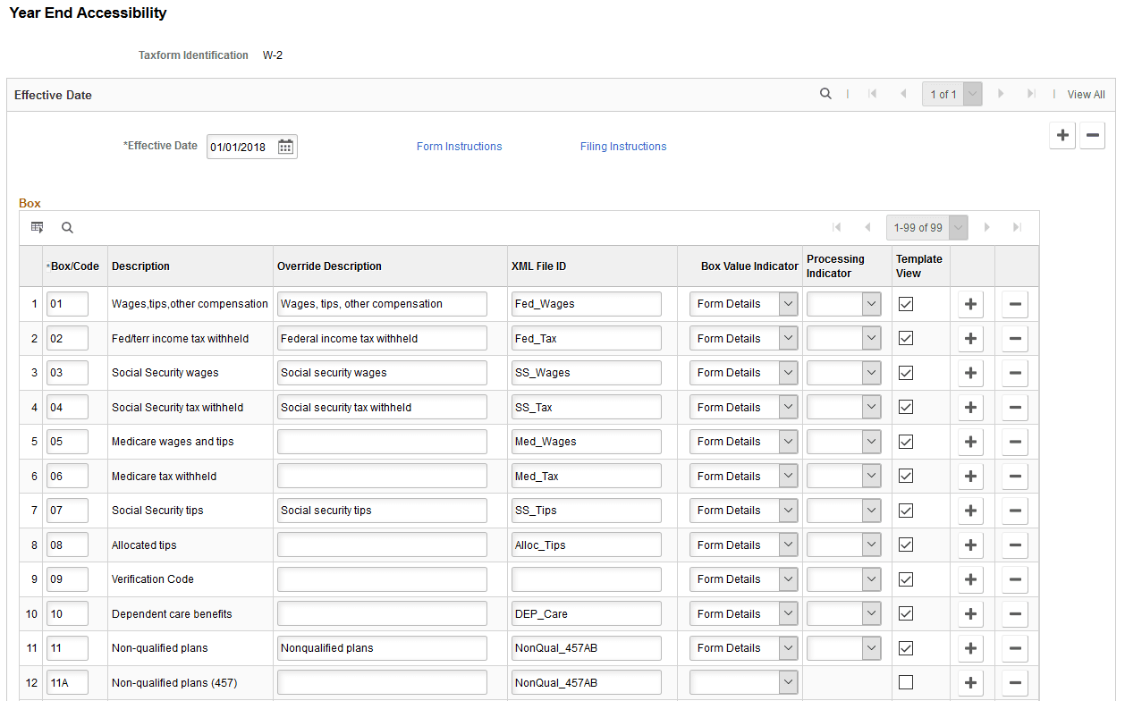

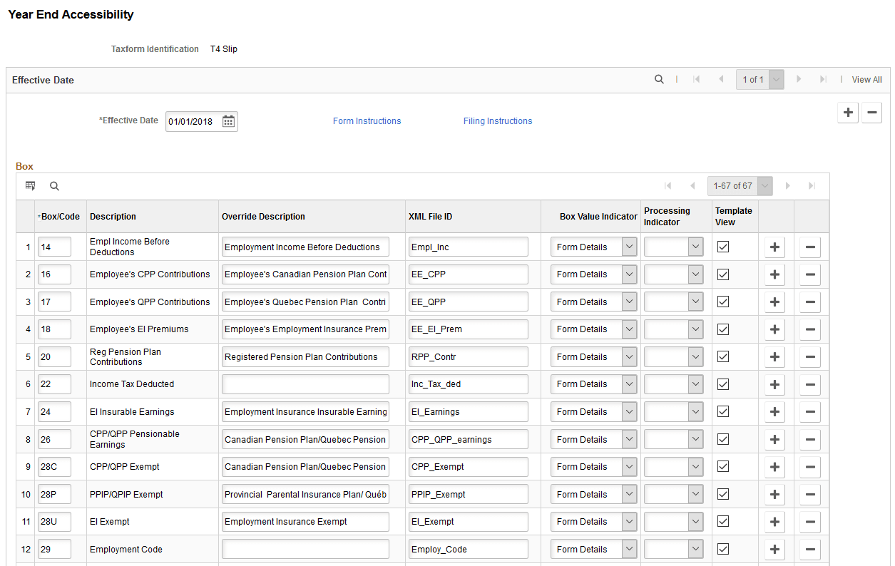

Use the Year End Accessibility page (TAXFORM_ACC_SETUP) to set up accessibility parameters for year-end tax forms.
Navigation:
  • Payroll for North America > U.S. Annual Processing > Define Annual Tax Reporting > Year End Accessibility
  • Payroll for North America > Year-End Processing CAN > Define Annual Tax Reporting > Year End Accessibility
This example illustrates the W-2 accessibility setup on the Year End Accessibility page.
(W-2) Year End Accessibility Page
This example illustrates the T4 accessibility setup on the Year End Accessibility page.
(T4) Year End Accessibility Page

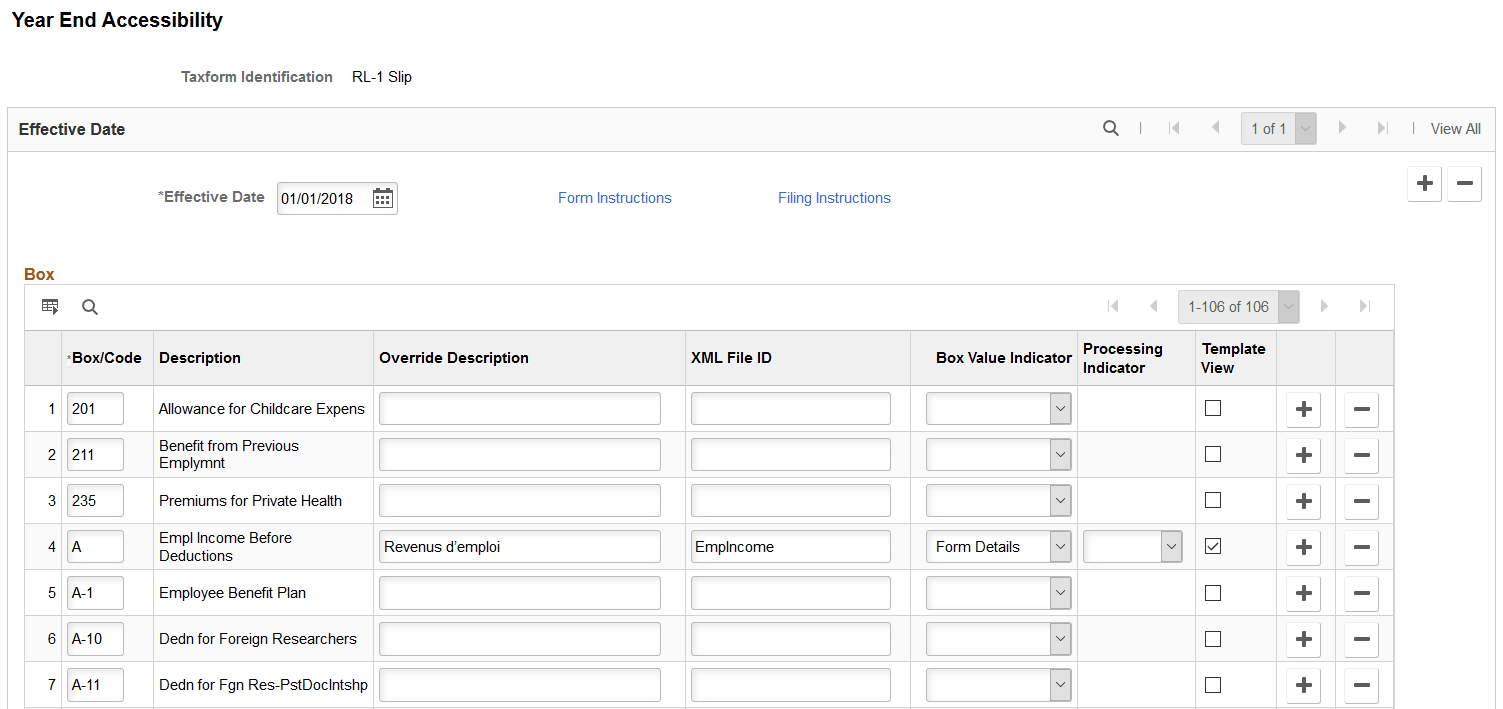

This example illustrates the RL-1 accessibility setup on the Year End Accessibility page.
(RL-1) Year End Accessibility Page
Payroll for North America delivers setup configurations to support the display of year-end tax forms in screen reader mode in Employee Self-Service. These configurations include:
  • Mapping of valid boxes and codes with corresponding XML tags in tax form definitions.
  • Display or processing logic.
  • New box labels that override default descriptions.
Important! Oracle recommends that you modify only the override descriptions and form instructions in delivered tax form configurations if necessary.
Field or Control
Description
Taxform Identification
Displays the tax form to which the accessibility setup applies.
Form Instructions
Click to view the instructional text that appears in the Instructions section of the View <Tax Form Name and Year> page in screen reader mode.
Filing Instructions
Click to view the instructional text for filing the tax form, which appears on the View <Tax Form Name> page where users can view tax forms by different tax years, for example, the View W-2/W-2c Forms page (PY_SS_YEW2_FORM_FL).
Box/Code
Based on the selected tax form and year, the system populates the corresponding boxes or codes from the Tax Form Definitions page along with descriptions.
Description
Displays the default description defined for the corresponding Box/Code on the Tax Form Definitions page.
Note: This field is editable for Form 1042-S and Form 1099-R.
Note: In screen reader mode, it is important to give a proper description to the Box/Code for the screen reader to interpret. If you need to override the delivered description, use the Override Description field to enter an alternate or new description.
Enter the preferred description to be displayed for the corresponding Box/Code when users view the tax form in screen reader mode. If this field is left blank, the default description will be displayed.
Note: This field is not available for Form 1042-S and Form 1099-R.
XML File ID
Indicates the mapping between the Box/Code and the XML tag in the XMLP template for the corresponding tax form definition.
Box Value Indicator
Indicates the mapping of the Box/Code to the corresponding section on the page that displays the tax form (screen reader mode). Available options are:
  • Employee Details: This option is used to map the Box/Code to the Employee Details section.
  • Employer Details: This option is used to map the Box/Code to the Employer Details section. This section specifies the address, company name and details about the employer.
  • Form Details: This option is used to map the Box/Code to the <Tax Form Name> Details section. This section specifies information that is specific to the tax form.
The options listed below are applicable to tax forms with corrected information, for example, W-2c.
  • Employee Correction: This option is used to map the Box/Code to the Corrected Employee Information section. This section specifies employee information that was previously reported and is now corrected.
  • Federal: This option is used to map the Box/Code to the Corrected Federal Information section. This section specifies federal information that was previously reported and is now corrected.
  • Local: This option is used to map the Box/Code to the Corrected Local information section (for example, Locality Wages, Locality Name and Locality Tax). This section specifies local information that was previously reported and is now corrected.
  • State: This option is used to map the Box/Code to Corrected State information (for example, State Wages and State Income Tax). This section specifies state information that was previously reported and is now corrected.
The Box/Code details will be displayed in each section of the View <Tax From Name and Year> page (screen reader mode) based on this mapping.
Processing Indicator
Indicates the processing type for each Box/Code. Available options are:
  • Correction: This process indicator is used to append box values together. Currently this is used along with the Employee Correction box value indicator, where we append the employee’s first name, last name and suffix together.
    Note: Currently this process indicator is applicable only to tax forms with corrected information, for example, W-2c.
  • Normal: This is the default behavior when one to one mapping of the XML ID is available.
  • Other: If the Box/Code description and value are in the same XML tag, then the Processing Indicator will be Other. Currently this is used in Box 14 of W-2-related tax forms.
    Note: Box 14 does not display long descriptions in screen reader mode. It displays the Box/Code values only.
  • Overflow: For single Box/Code, if the XML file ID field contains two field values, one for label and another for value, the processing indicator will be overflow. The system will identify the first tag value as the box code and second tag value as the corresponding value. Currently this is used in Box 12 of W-2-related tax forms.
Note: By default, normal processing is followed if this field is left blank.
Template View
Select to display the corresponding box and description on the tax form or slip.
When an employee views a year-end form or slip in screen reader mode, the system displays by default only boxes that have the Template View option selected and contain form values. If the employee selects to view all boxes on the form or slip, all boxes with the Template View option will be displayed, regardless of the presence of form values.

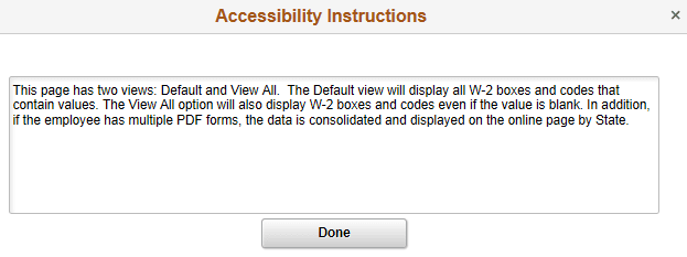

Use the Accessibility Instructions page (TAXFRM_INS_ACC_SEC) to view or update the instructional texts used for viewing year-end tax forms in screen reader mode.
Navigation:
Click the Form Instructions link on the Year End Accessibility page.
This example illustrates the Accessibility Instructions.
Content displayed on this page is the standard accessibility instruction that PeopleSoft delivers. You can modify the text if needed.
At runtime, this instructional text appears on the Instructions section of the View <Tax Form Name and Year> page in screen reader mode, when the corresponding tax form is being viewed.

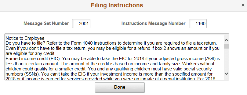

Use the Filing Instructions page (TAX_FILINGINST_SEC) to view instructional texts used for filing tax forms.
Navigation:
Click the Filing Instructions link on the Year End Accessibility page.
This example illustrates the Filing Instructions.
Filing Instructions Page
Filing instructions are managed through message catalogs.
At runtime, this instructional text appears on the View <Tax Form Name and Year> page where users can view the corresponding tax forms by different tax years, for example, the View W-2/W-2c Forms page (PY_SS_YEW2_FORM_FL).

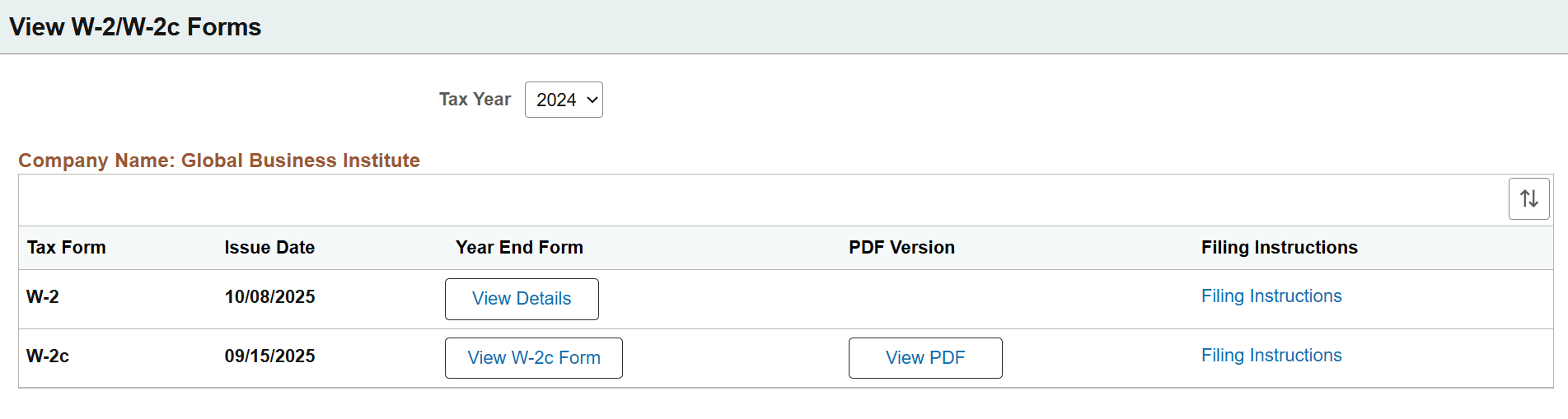

This example illustrates the View W-2/W-2c Forms page in screen reader mode.

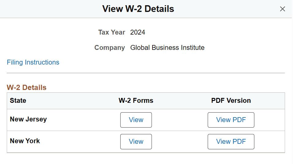

This example illustrates the View W-2 Details page in screen reader mode for employees with multiple copies of the same tax form and year.
<>View <Tax Form Name> Details page showing tax form copies for the same tax form definition and year, with different states

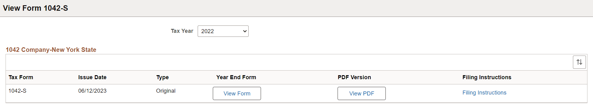

This example illustrates the View Form 1042-S page in screen reader mode.

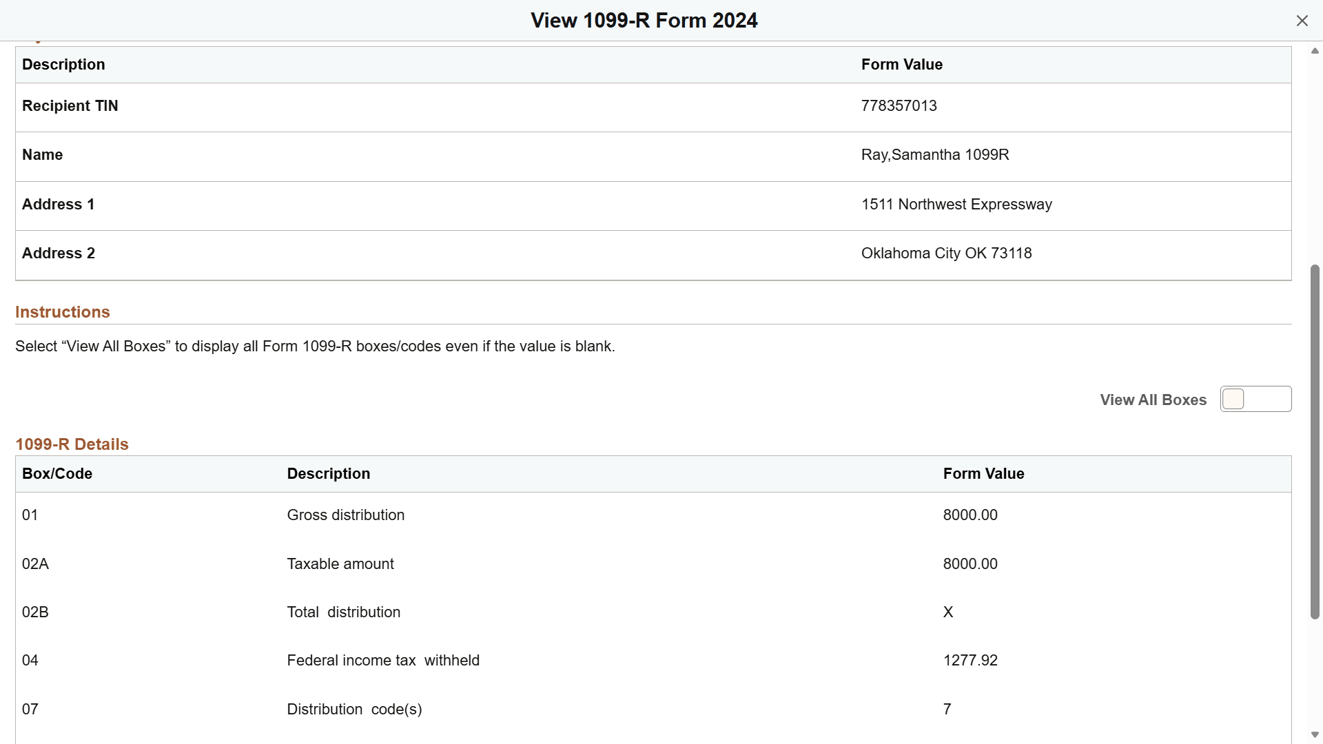

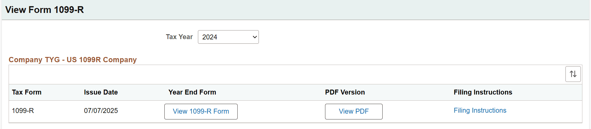

This example illustrates the View Form 1099-R page in screen reader mode.

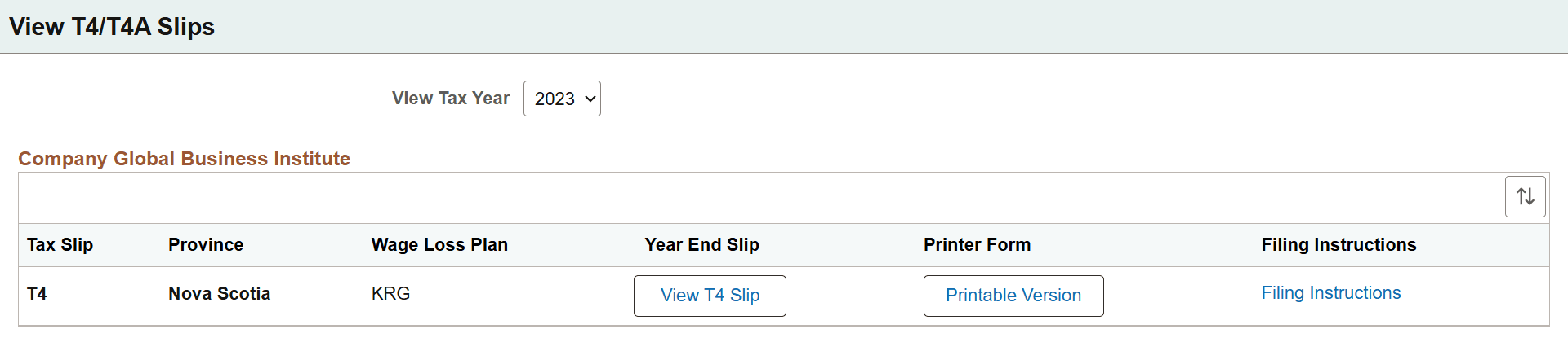

This example illustrates the View T4/T4A Slips page in screen reader mode.

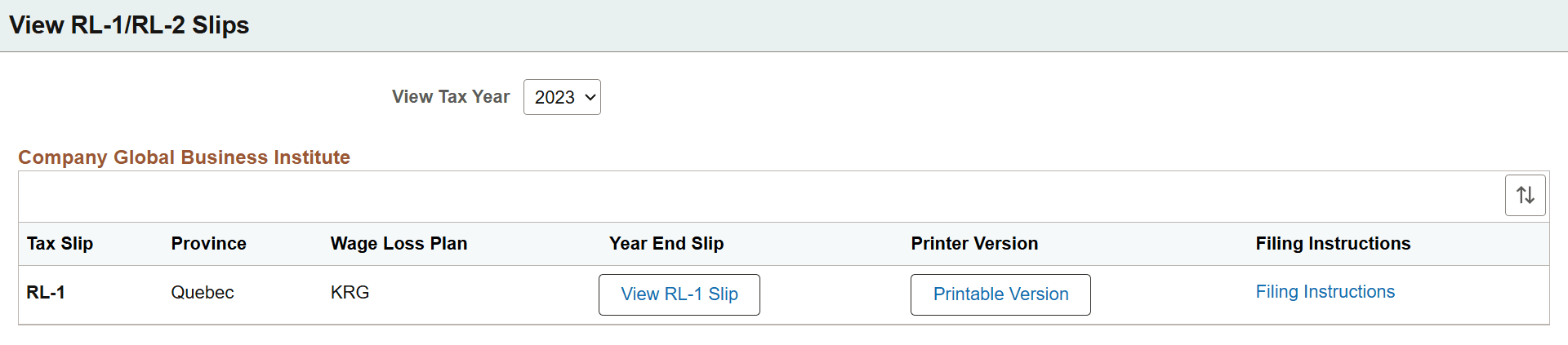

This example illustrates the View RL-1/RL-2 Slips page in screen reader mode.

Field or Control
Description
Tax Year or View Tax Year
Select the year of the tax form you wish to view.
View <Tax Form Name> or View
Select the button to view the corresponding tax form online in screen reader mode.
View Details
Select the button to select and view tax forms by state or type on the View <Tax Form Name> Details page.
Note: This button appears if the user has more than one copy of the tax form for the same tax form definition and year, for example, W-2s from different states, or RL-1 slips of different types (original and amended).
(USA) View PDF or (CAN) Printable Version
Select the button to view or print the corresponding tax form in the PDF format in a new browser tab or window.
Note: (For overflow W-2 forms) Select the button to view or print each of the W-2 pages individually on the View Pages.
Filing Instructions
Select the link to view the filing instructions of the corresponding tax form online. A button is available on the online page for you to view or print the instructions in PDF if needed.

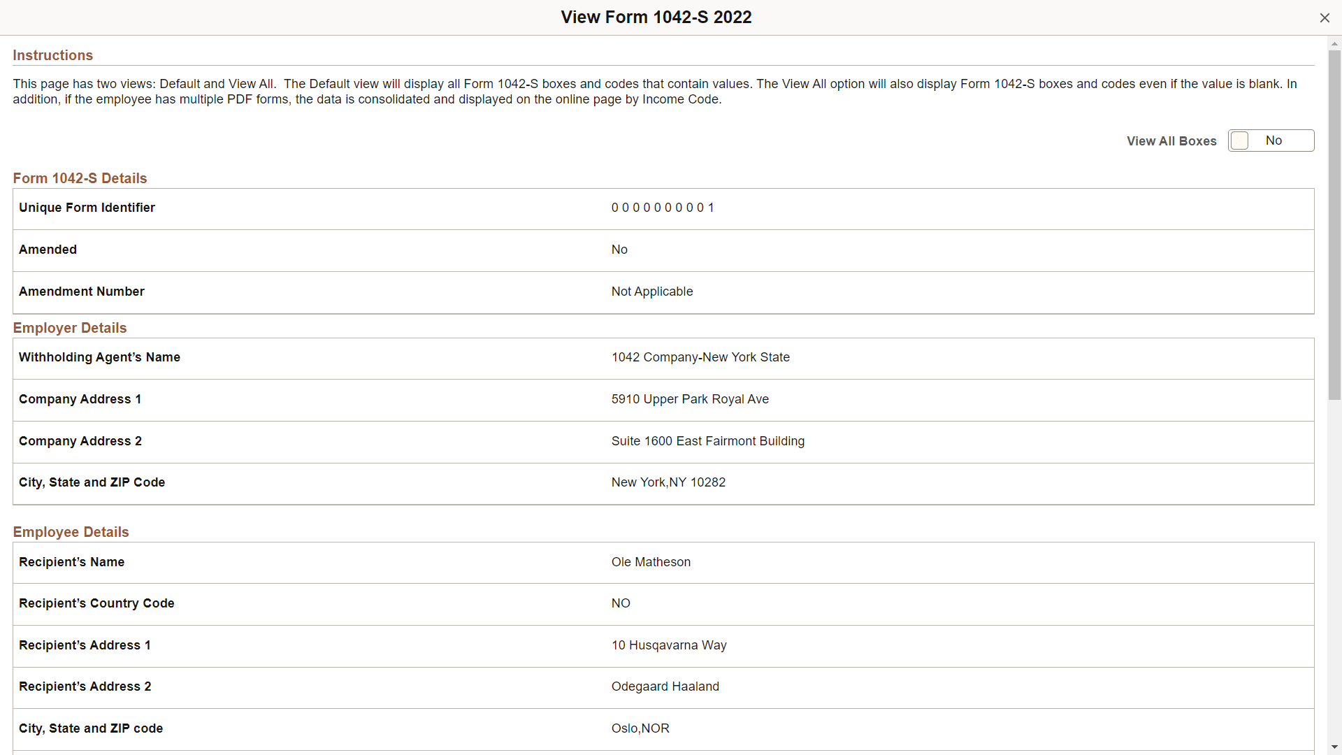

This example illustrates the View Form 1042-S <Year> page in screen reader mode.
<>View Form 1042-S <Year> page in screen reader mode
This example illustrates the View 1099-R Form <Year> page in screen reader mode.
<>View 1099-R Form <Year> page in screen reader mode

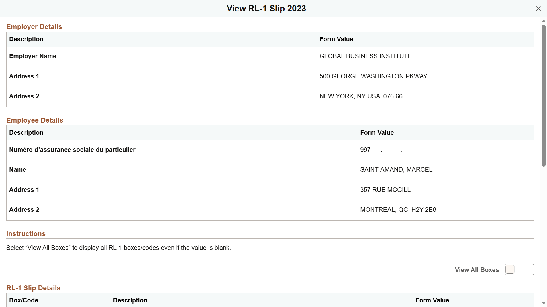

This example illustrates the View RL-1 Slip <Year> page in screen reader mode.
<>View RL-1 Slip <Year> page in screen reader mode
This online page is displayed based on the accessibility configuration that is defined on the Year End Accessibility Page.
Field or Control
Description
View All Boxes
Click to show on the tax form or slip all boxes and codes that have the Template View option selected on the Year End Accessibility page. It includes all the Template View-enabled boxes with or without form values.
Note: If this option is disabled, only boxes and codes with form values will be displayed on the page.
(USA) View PDF or (CAN) Printable <Tax Form Name>

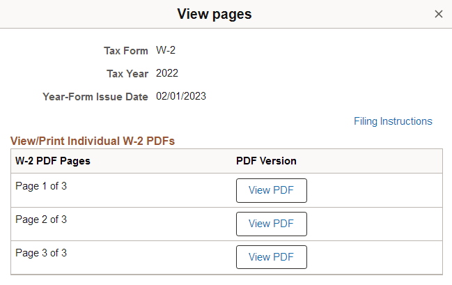

Use View Pages (PY_SS_YEW2_PGS_SCF) to view or print overflow year-end forms in single-page PDFs individually.
Navigation:
Select the View PDF button of an overflow year-end form on the View W-2/W-2c Forms page.
This example illustrates View Pages.
View pages
Note: This page appears if the year-end form you select to view contains multiple PDF pages (overflow).
Field or Control
Description
Filing Instructions
Select to view or print the filing instructions of the tax slip in PDF.
View PDF
Select the button to view or print the selected page of the year-end form in PDF.
View All Pages
Select to view or print all pages of the year-end form in a consolidated PDF.
Note: Consolidated (multi-page) PDFs are not accessible by screen readers.
This button appears if the configuration option to view consolidated PDFs in the current mode (standard or screen reader) is selected on the Payroll for NA Installation Page.
