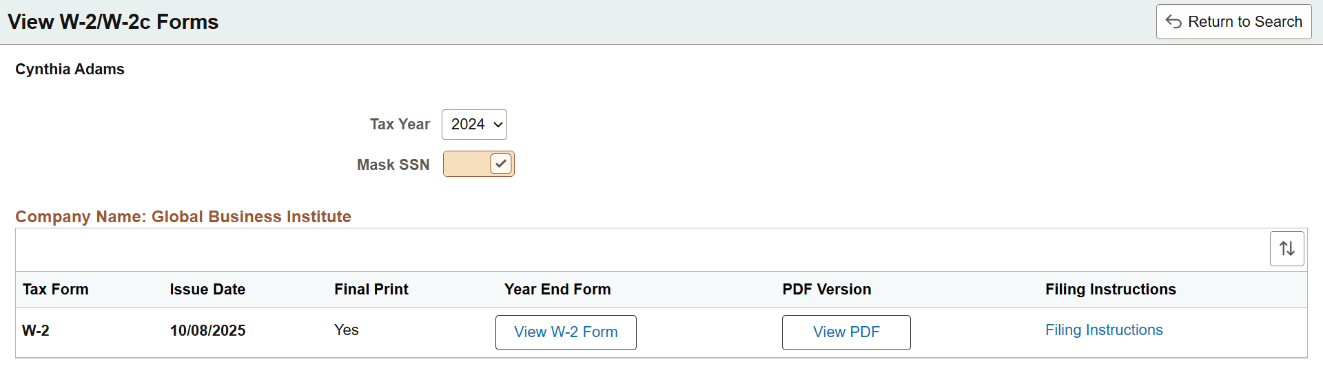

  • The administrator view of year-end forms and slips includes additional fields:
    • The employe name is shown on the page for easy identification.
    • The Tax Year field is available for administrators to select different year-end forms and slips.
    • (For Canadian year-end slips) The Mask SIN option is available. When selected, the SIN is displayed in a masked format on the year-end slip.
    • (For U.S. W-2/W2-c) The Mask SSN option is available if masking the SSN on the employee copy is enabled on the BI Publisher SSN Mask Options page.
      When Mask SSN is selected, the SSN is displayed in a masked format on the year-end form.
    • The Final Print field is displayed.
This is an example of the Fluid View W-2/W-2c Forms page for administrators. The page layout is similar across all year-end forms and slips.
Example of the Fluid View W-2/W-2c Forms page for administrators

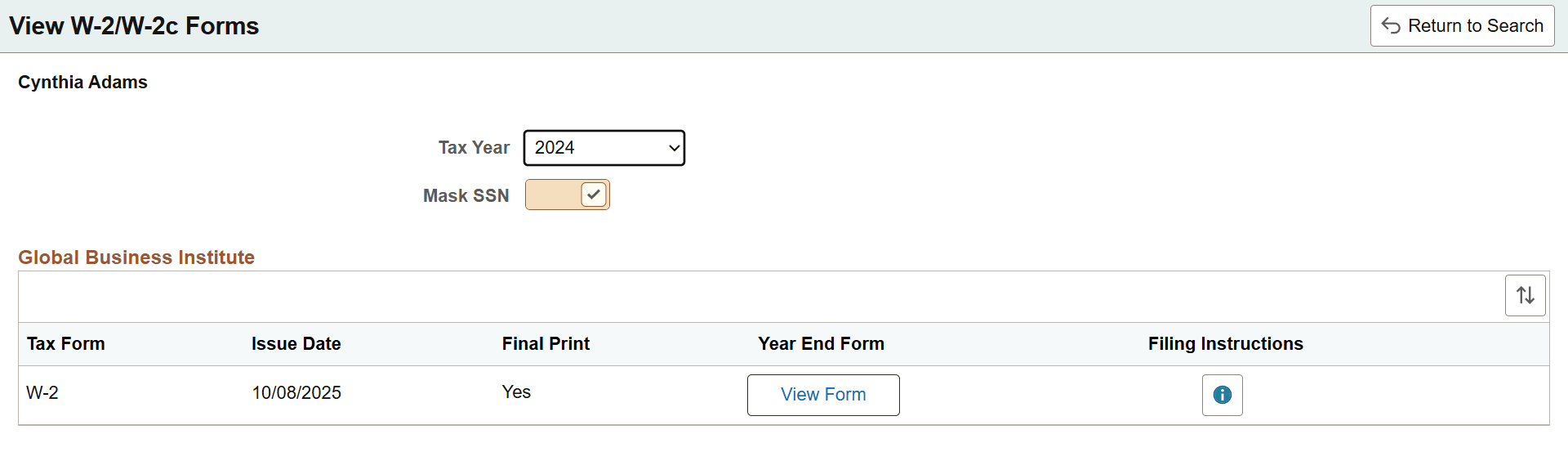

Administrators can view fluid year-end forms and slips in screen reader format (HTML), which can be enabled either at the system level using the Fluid HTML View in Standard Mode configuration on the Payroll for NA Installation Page, or at login on the Sign In page.
This is an example of the Fluid View W-2/W-2c Forms page for administrators in screen reader mode.
Example of the Fluid View W-2/W-2c Forms page for administrators in screen reader mode)
