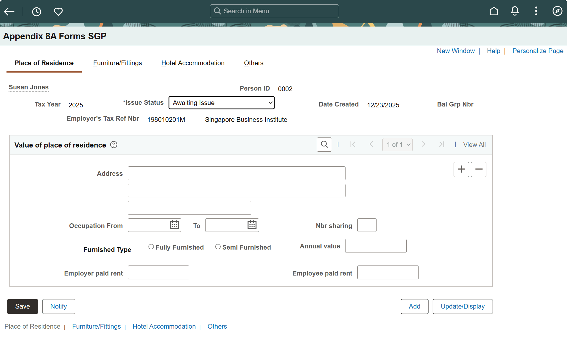

Use the Place of Residence page (GPSG_APP_8A_1) to review the employee's residence, occupation and rent details.
Navigation:
Global Payroll & Absence Mgmt > Year-End Processing > Appendix 8A Forms SGP > Place of Residence
This example illustrates the fields and controls on the Place of Residence page.
Place of Residence
The details that you enter on this page populate the fields on the IR21 Appendix 1 Details pages. You must run the Appendix 8A - calculation program before the details that you enter on this page populate the fields on the IR21 Appendix 1 Details.

Value of place of residence
Field or Control
Description
Address
If the employee's residence is part of an employment benefit in kind, enter the full address of the employee's residence that is provided by the employer. You can add multiple addresses.
This is a required field.
Occupation From and To
Enter the dates that the employee occupied the residence during the year. These dates also automatically determine the total days occupied on the IR21 Appendix 1 Details 1 page.
Nbr sharing (number sharing)
Enter the number of employees that were living and sharing the residence during the year (excluding family members).
Employer paid rent and Employee paid rent
Enter the values for the year. These values also populate the fields on the IR21 Appendix 1 Details 2 page, and they are used in the calculation of the taxable benefit or taxable value of the employee's Place of Residence on the IR21 – Appendix 1 Form. The annual value is the estimated annual rent that a property can fetch and the amount that is to be declared is shown in the property tax bill. If the place of residence is or was rented by the employer and if the annual value is not available, the amount of rent that is paid by the employer should be declared.
Note: If the place of residence is or was shared among employees, annual value and paid rent should be apportioned according to the number of employees that are staying in the place.

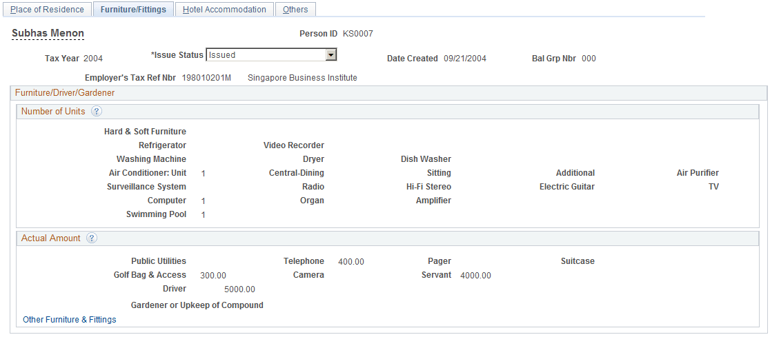

Use the Furniture/Fittings page (GPSG_APP_8A_2) to review additional specific benefit item units and values for furniture or fittings.
Navigation:
Global Payroll & Absence Mgmt > Year-End Processing > Appendix 8A Forms SGP > Furniture/Fittings
This example illustrates the fields and controls on the Furniture/Fittings page.
You can enter the number and monetary value of each of the furniture and fitting, driver, and gardener benefit items within the employee's residence. The system calculates the value of the benefits in kind by using effective-dated rates that are stored in the Benefit Rates table. These rates reflect the rates that are detailed in sections B and C of the Appendix 8A form. These values are used in the calculation of the taxable value of the employee's benefit in kind items.
Click the Other Furniture & Fittings link to access the App 8A Furniture & Fittings page.

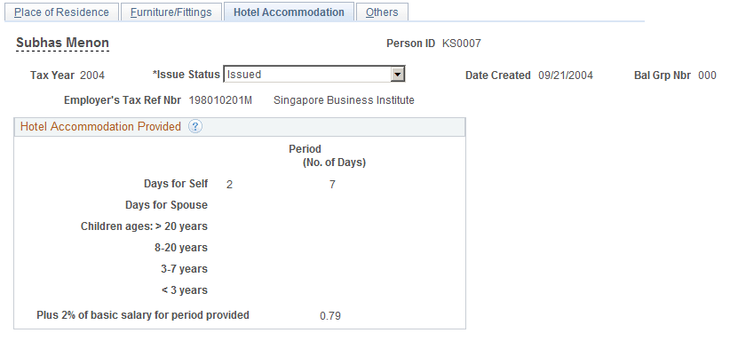

Use the Hotel Accommodation page (GPSG_APP_8A_3) to review the values that are used in the calculation of the taxable value of hotel accommodation that is provided to employees and their families.
Navigation:
Global Payroll & Absence Mgmt > Year-End Processing > Appendix 8A Forms SGP > Hotel Accommodation
This example illustrates the fields and controls on the Hotel Accommodation page.
Hotel Accommodatn page
The self; spouse; children under 20 years old; and children ages 8 to 20 years, three to seven years, and under three years values populate the fields on the IR21 Appendix 1 Details 2 page. You use these values in the calculation of the taxable value of hotel accommodation that is provided to employees by using the rate per person that is stored in the Benefit Rates table (or in Section C of the Appendix 8A Form). You enter the total number of persons (self, spouse or child) and the period during which the accommodation was provided to these persons.
