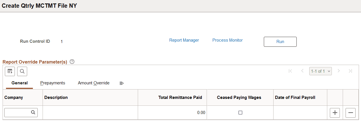

This example illustrates the fields and controls on the Create Qtrly MCTMT File NY page.
Important! To create quarterly MCTMT reports, you need to launch the TAX820NY program twice.
First, run the program without any specified parameters. The purpose of this run is to prepare values to be displayed in the Total Remittance Paid field for Zone 1 and Zone 2 on the General tab.
After running the program for the first time, you can specify companies in the Report Override Parameter(s) section and make updates as needed. When a company is selected, the system displays the total amount that it is remitting with this filing in the Total Remittance Paid field. Run the program again to generate quarterly MCTMT reports.
General
Field or Control
Description
Company
Enter the reporting company.
Displays the total amount taxpayer is remitting with this filing after the program has been run for the first time in the quarter.
Ceased Paying Wages
Select if the company is no longer doing business in the MTA region.
Date of Final Payroll
Enter the date of final payroll, which must be within the quarter and year of this filing.
This field becomes editable when the Ceased Paying Wages field is selected.
