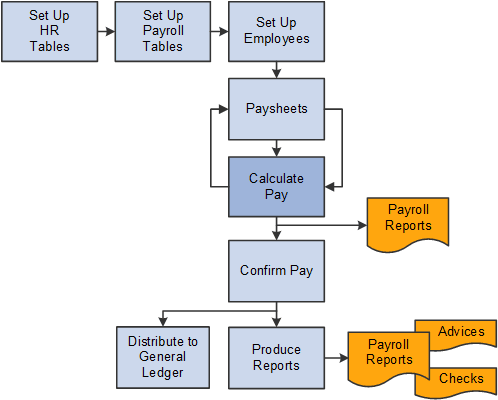

In Payroll for North America, pay calculation is an iterative process. You can run and rerun calculations repeatedly until you're confident that the payroll data is correct. Here are the basic steps:
  1. Enter employee payroll information, create paysheets, and make updates and adjustments for the pay period.
  2. (Optional) Identify and fix potential errors using the Precalculation Audit Report (PAY035).
  3. Run the Pay Calculation COBOL SQL process (PSPPYRUN).
  4. Review calculation results and check for errors.
    Check payroll error messages online or print the Payroll Error Messages report (PAY011).
    View the results of paycheck earnings, deductions, and taxes using the Paycheck pages and various standard reports that you can print to verify the results of the pay calculation.
  5. Make adjustments on the paysheets.
  6. Repeat these steps until you're confident that the payroll data is correct, then run the final calculation and confirm pay.
This diagram illustrates where pay calculation fits into the payroll process from setting up PeopleSoft HR tables to producing payroll reports, advices and checks:
This diagram illustrates where pay calculation fits into the payroll process from setting up PeopleSoft HR tables to producing payroll reports, advices and checks.
Illustration showing how pay calculation fits into the payroll process from setting up PeopleSoft HR tables to producing payroll reports, advices and checks

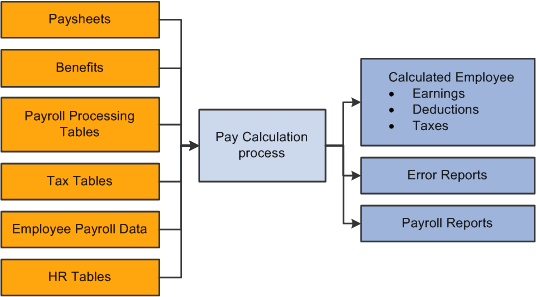

Pay calculation processes information that you set up in PeopleSoft HCM and Payroll for North America setup tables and employee setup tables, as well as additional information that is provided on paysheets.
This diagram shows what payroll and HCM information is used in the pay calculation process:
This diagram shows what payroll and HCM information is used in the pay calculation process.
Illustration showing what payroll and HCM information is used in the pay calculation process
