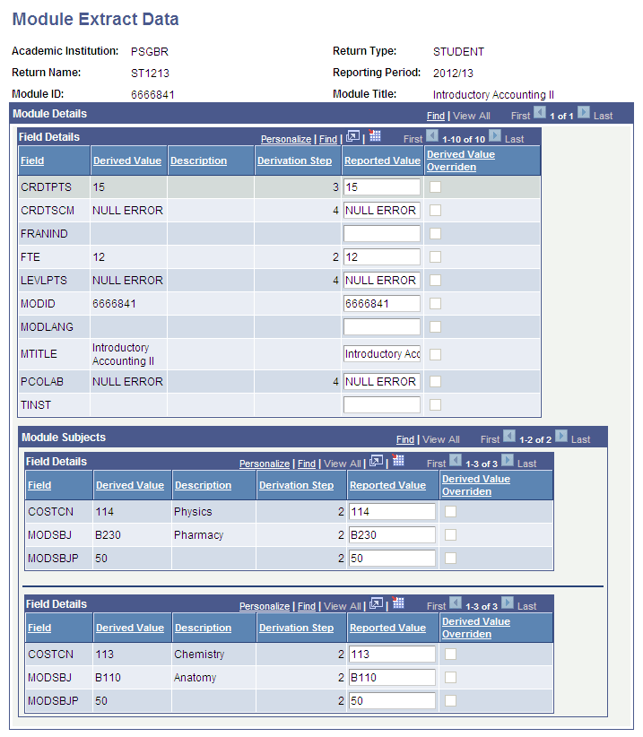

Register Extract Data
SSR_HE_REGI_EXT
Records and Enrollment > HESA Reporting > Extract Data > Register Extract Data
Review the Student and Course Subject entity data that the Create Extract process generates for a student's ITT/Register return.

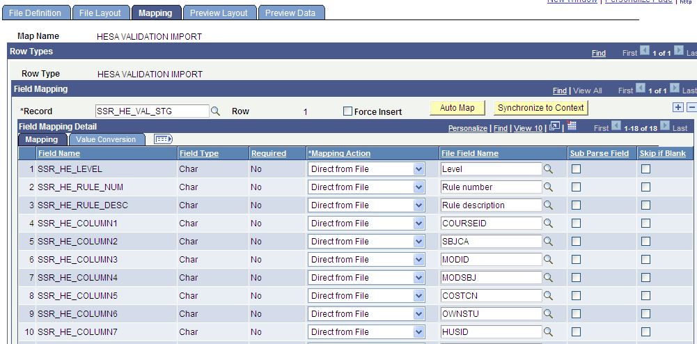

The Add Attachment button and XML Path/File Name field are similar to the same button and field on the Import Survey Target Population page. You can now import CSV files. The import process ignores the header row of the CSV file. Take note that the file name character limit is 60, so you might must edit the file name before importing.
The other actions on this page (other than the Increment Year of Program checkbox) are similar to the check boxes on the Calculate Year of Student page.

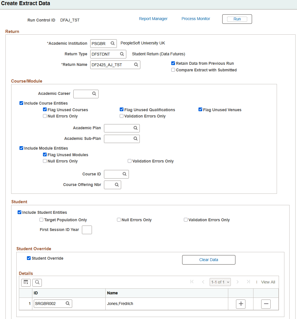

Access the Create Extract Data page (Records and Enrollment > HESA Reporting > Extract Processing > Create Extract).
This example illustrates the fields and controls on the Create Extract Data page. You can find definitions for the fields and controls later on this page.
Field or Control
Description
Return Type
Enter a return type to filter the list of available returns in the Return Name field.
Return Name
Enter the return for which the process should generate the reporting data.
You set up a return using the Returns Setup component.
Retain Data from Previous Run
Select to have the Create Extract process delete the existing inactive data, update the existing active data to inactive, and to extract new data. If the is deselected, then the process deletes all the existing data (both active and inactive) records and extracts the new data.
Compare Extract with Submitted Data
When you select this checkbox, the Create Extract Data process compare extract records with the most recent set of submitted data records. And then the process updates the Entity Status and Field Status values.
You can skip the comparison by deselecting the checkbox. When the derived value in the extract is NULL ERROR, Field Status is set to Error. When the derived value isn'tblank, then Field Status is set to New. The Entity Status is set to Error when there's at least one field whose Field Status in the extract is also "Error." Otherwise, Entity Status is set to New.
The fields on this page are available for entry depending on the return you select. For example, the system disables the Course/Module, Student, and Student Override regions for an Total Offshore return. If the return is Graduate Outcomes, only the Null Errors Only and Validation Errors Only check boxes in the Student region and the Student Override region are available.
Survey Details
Use this region to select which survey records are included in the extract. Each is enabled only if the corresponding Survey value is defined for the return. You can run the extract process for only one Graduate Outcomes survey at a time.
If only one survey is defined for the return, that survey is selected by default and the other check boxes are disabled. If more than one survey is defined, then all the check boxes are enabled and default to the deselected state. You must select at least one to run the process. When you select a , other check boxes that are currently selected are automatically deselected.
Course/Module
Use this region to include or exclude the Course and Module entity data in the Student return. Also, you can use the region to restrict the Course and Module entity data in the Student return. For example, you can specify that the process should create Course data for all the courses in the undergraduate career and Module data for a Biochemistry course offering in the undergraduate career.
Also, use this region to include or exclude the KISCourse entity data in the Unistats/KIS return.
Note: You can use this region only for Student and Unistats/KIS returns. It's not applicable to Register/ITT, Offshore, and Graduate Outcomes returns.
Field or Control
Description
Academic Career
Select to restrict the Course and Module extracts of the Student return to a particular career.
This isn'tapplicable for Unistats/KIS return.
Note: If you select an academic career, the process will restrict the Instance extract in the Student return based on the selected career because the process creates Instance records only if the plan or subplan is already included in the Course extract.
The system enables the Academic Career field only if you select either the Include Course Entities or the Include Module Entities . However, if you select either the Null Errors Only or the Validation Errors Only , the system disables this field.
Select to include the Course and Course Subject extracts in the Student return.
Select to include KISCourse extract in the Unistats/KIS return.
Flag Unused Courses
Flag Unused Qualifications
Flag Unused Venues
These options are available only when the return type is DFSTDNT.
If Include Course Entities is selected, then these options are also selected by default.
These are the conditions that the Create Extract Data process follows to update the Entity Status to Unused. This applies to records that aren't being used in the corresponding student extract data.
  • If Flag Unused Courses is selected and the Course ID doesn't exist in the Student Course Session extract data.
  • If the Flag Unused Qualifications is selected and the Qualification ID doesn't exist in either the Course extract data (when the Entity Status isn't Unused) or the Qualification Awarded extract data.
  • If the Flag Unused Venues is selected and the Venue ID doesn't exist in the Study Location extract data.
Note that for entities that have data errors and aren't used, the process will update the Entity Status from Error to Unused.
Null Errors Only
Select to restrict the Course or KISCourse extract to those records where a NULL ERROR value has been derived in the previous run of the process.
You can't select both the Null Errors Only and Validation Errors Only check boxes for the Course entity.
Select to restrict the Course or KISCourse extract to those records where the HESA Validation Kit has identified a validation error and the error details have been imported to the validation staging table.
Academic Plan
Select to restrict Course or KISCourse extract to a particular plan.
The system enables this field only if the Include Course Entities is selected and both the Null Errors Only and Validation Errors Only check boxes are cleared.
All active academic plans are available for selection. Ensure that the Report to HESA is selected on the Plan HESA Data page for the plan you've selected.
Academic Sub-Plan
Select to restrict Course or KISCourse extract to a particular subplan.
All active academic subplans are available for selection. Ensure that the Report to HESA is selected on the Sub-Plan HESA Data page for the subplan you've selected. Also, select the Enable Sub-Plan Reporting on the HESA Returns page to report subplan data.
Select to include the Module and Module Subject extracts.
Flag Unused Modules
This option is available only when the return type is DFSTDNT.
If Include Module Entities is selected, then this option is also selected by default. When Flag Unused Modules is selected and the Module ID doesn't exist in the Module Instance extract data, the Entity Status is updated to Unused.
Null Errors Only
Select to restrict the Module extract to those records where a NULL ERROR value has been derived in the previous run of the process.
You can't select both the Null Errors Only and Validation Errors Only check boxes for the Module entity.
Select to restrict the Module extract to those records where the HESA Validation Kit has identified a validation error and the error details have been imported to the validation staging table.
Course ID and Course Offering Nbr
Select to restrict the Course entity data to a particular course.
If you select a Course ID or Course Offering Number, the process creates Module and StudentOnModule data for only the selected values.
All active courses are available for selection. Ensure that the Report to HESA is selected on the HESA Module Data page for the course ID and course offering number you've selected.
The system enables this field only if the Include Module Entities is selected and both the Null Errors Only and Validation Errors Only check boxes are cleared.
Student
Use this region to include or exclude the student-related entity data in the return. Also, you can use the region to restrict the student-related entity data. Examples of student-related entities include Instance, Student, and Entry Profile entities.
This region isn't applicable for Unistats/KIS return.
Field or Control
Description
Include Student Entities
This option is enabled only for Student returns. For Register/ITT, the Create Extract process automatically includes the student-related entity data.
Select to include the student-related extracts.
Target Population Only (for Data Futures return)
Select to restrict the Engagement extract to only those continuing students whose Population Year value in the HESA Instance record matches the Reporting Period Year.
Note that this affects only continuing students and doesn't affect new students.
First Session ID Year
If Include Student Entities is selected, this field appears only for DFSTDNT.
Use this field if you don't want to use the default and want to use the SCSESSIONID derivation (based on Report Year) in a different year instead of the default 24. Just enter the year you'd like it to begin.
For example, if you want to start from 2025/26 instead of 2024/25, enter 25.
Once you set a value, any new sessions starting that year or later will use the Report Year for SCSESSIONID. Earlier sessions continue to use the old method with 1 at the end.
Note: By default, SCSESSIONID ends with the last two digits of the Report Year for Student Course Sessions starting in or after 2024/25. For example, sessions starting in 2024/25 will have an ID ending in 24. Sessions starting before 2024/25 will have an ID ending in 1.
New Students
This option is enabled only for Register/ITT returns. By default, this is selected. New students are included in the extract if the start date of instance is within the reporting period.
Continuing Students
This option is enabled only for Register/ITT returns. By default, this is selected. Continuing students are included in the extract if the start date of instance is before the reporting period start date.
Null Errors Only
Select to restrict returns to those students where a NULL ERROR value has been derived in one of the student-related entities during a previous run of the process.
You can't select all three check boxes — Null Errors Only, Validation Errors Only, and Student Overrides — for the student-related entities. Only one can be selected.
The system enables this for only Student and Register/ ITT returns.
Select to restrict the student-related entities in the extract to those records where the HESA Validation Kit has identified a validation error and the error details have been imported to the validation staging table.
The system enables this for only Student and Register/ITT returns.
Student Override
Use this region to specify a single or multiple students for whom the process should generate the return data.

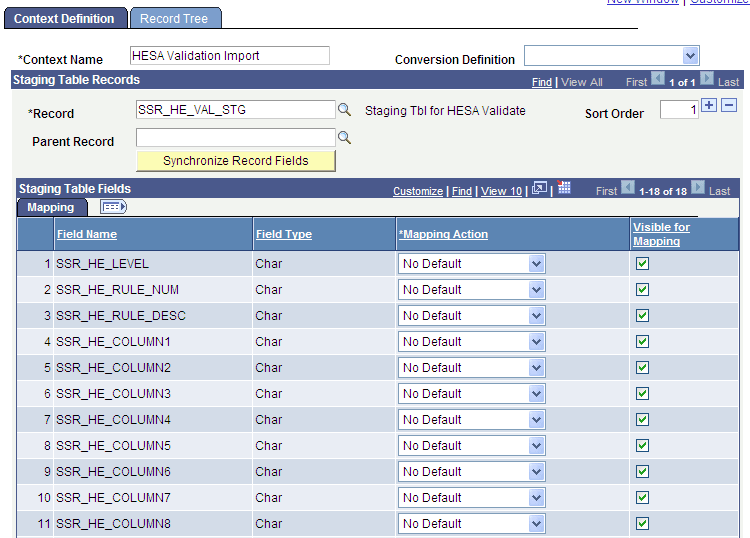

Note that the Field Conversion Definition setup is required only if the file data needs to be converted before inserting into the staging table. Therefore, this setup isn’t required for HESA validation error processing.
The following is an example of the context definition setup for HESA Validation error processing:
This example illustrates Context Definition setup for HESA error processing (1 of 2). You can find definitions for the fields and controls later on this page.
Context Definition setup for HESA (Higher Education Statistics Agency) error processing (1 of 2)
This example illustrates Context Definition setup for HESA error processing (2 of 2). You can find definitions for the fields and controls later on this page.
Context Definition setup for HESA (Higher Education Statistics Agency) error processing (2 of 2)

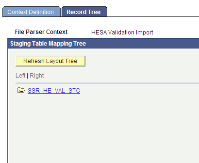

Click the Refresh Layout Tree link on the Record Tree page to view the staging table (SSR_HE_VAL_STG) that holds the imported validation errors.
The following is an example of the Record Tree page for SSR_HE_VAL_STG:

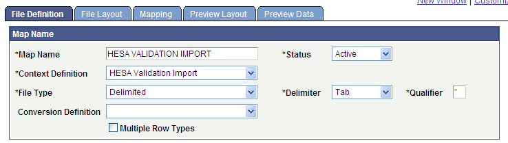

Campus Solutions delivers an example definition that includes the possible validation error values that you can import:
Example of a File Definition page
The delivered definition is based on an assumed error file structure:
An example of the error file structure set up on the File Layout page
The header row for the file would contain the field names, indicated in the preceding example, without the Line Number.

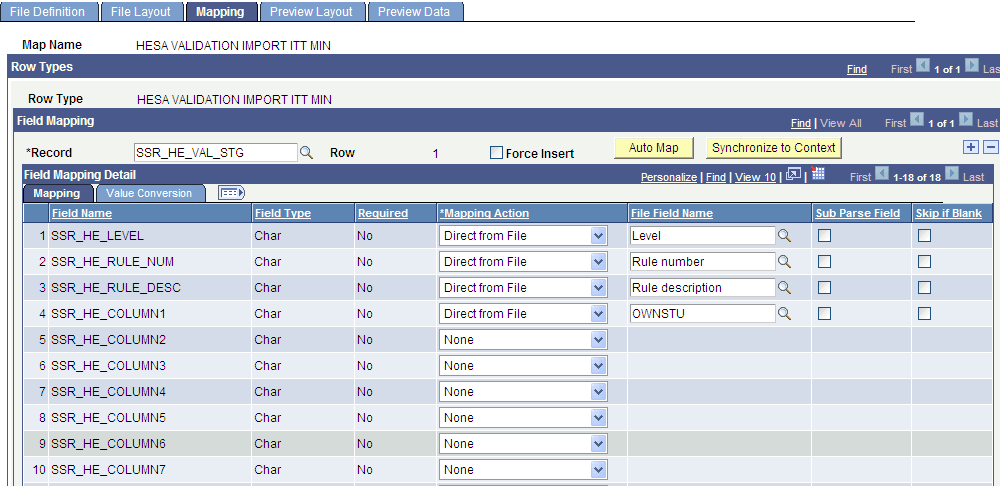

You can copy an existing File Mapping Definition (Set Up SACR, System Administration, Utilities, File Parser, Copy File Map Definition ) and then edit the copied version to create different mappings that match the fields in the error file.
Map the key fields of COURSEID, MODID, and OWNSTU to a staging table column if the values for the fields are provided in the errors file. Also, map the Level, Rule Number, and Rule Description values.
The following is an example of the Mapping page with the mappings for these fields:
Mapping for the minimum fields (1 of 2)
Example of mapping for the minimum fields (continued):
Mapping for the minimum fields (2 of 2)

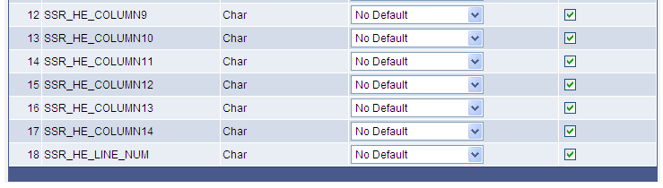

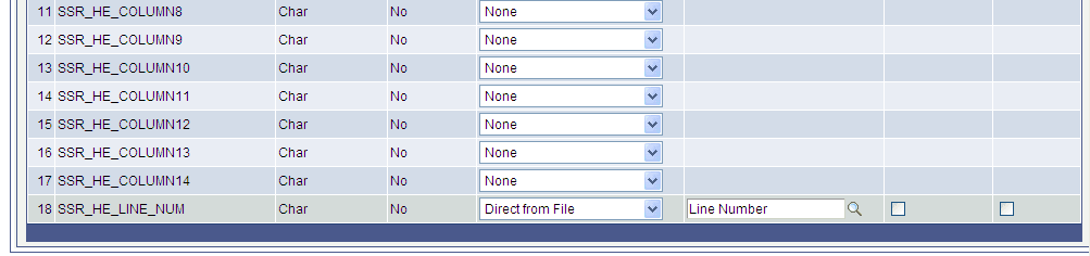

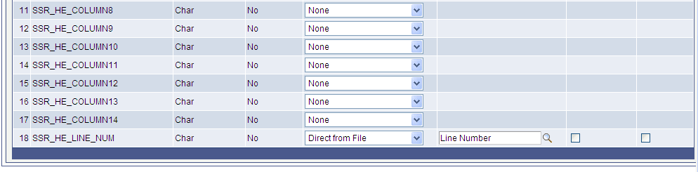

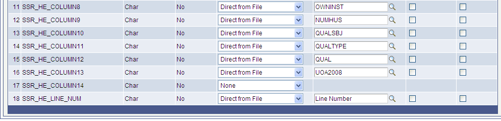

To process the staging table records, the Create Extract process doesn't rely on values existing in a particular column but the process will select the key COURSEID, MODID and OWNSTU values based on the header row value for the column in the error file. Therefore, you must include the header row in the error file being imported.
Other than the key and Level, Rule Number and Rule Description values, you can map the remaining fields to import the full details of the errors into the staging table record. This step is optional because the nonkey values aren't required for the next processing of the staging table records by the Create Extract process.
This is the mapping for the full Student return error file:
Mapping for the full error file (1 of 2)
Mapping for the full Student return error file (continued):
Mapping for the full error file (2 of 2)

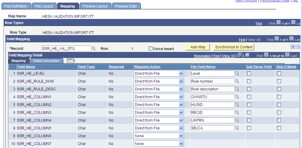

As with the Student return, for the ITT return, you must map the Level, Rule Number and Rule Description values along with the key OWNSTU value. The File Parser process uses these mappings to identify the extract records that are to be re-processed by the Create Extract process.
This example illustrates the mapping for the minimum fields — ITT.
Mapping for the minimum fields - ITT (Initial Teacher Training) (1 of 2)
Mapping for the minimum fields — ITT (continued).
Mapping for the minimum fields - ITT (Initial Teacher Training) (2 of 2)
This is the mapping for the full ITT error file:
This example illustrates the mapping for the full error file — ITT.
Mapping for the full error file - ITT (Initial Teacher Training) (1 of 2)
Mapping for the full error file — ITT (continued).
Mapping for the full error file - ITT (Initial Teacher Training) (2 of 2)

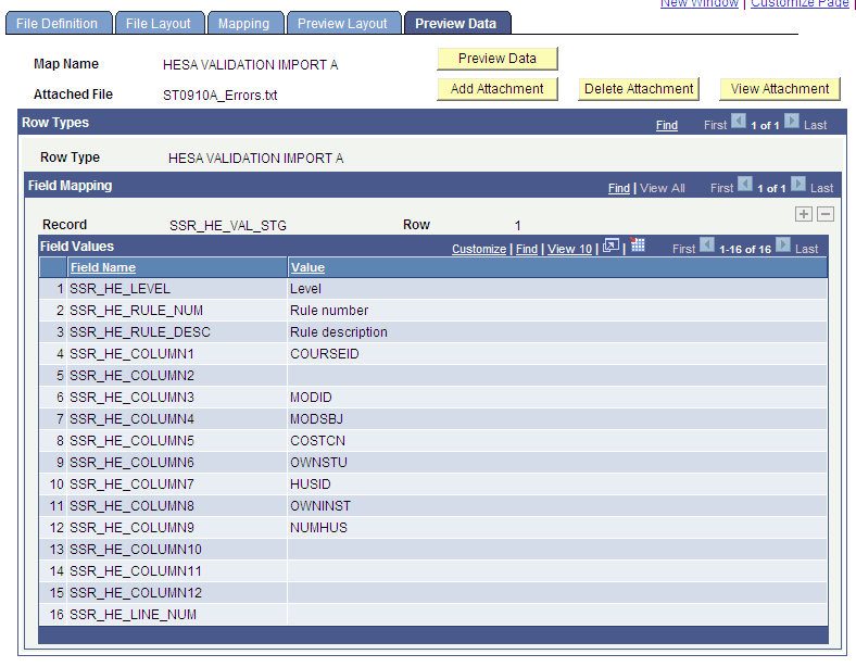

On the Preview Data page, you can attach an error file and generate a preview based on the first row in the error file. This lets you check whether the values will populate the correct columns in the staging table.
The following is an example of the Preview Data page:
Example of the Preview Data page
In the preceding example, note that because the header row doesn't included a label for Line Number that value is blank in the preview.
Access the extract data pages (Records and Enrollment > HESA Reporting > Extract Data).
Use the Institution Extract, Module Extract Data, Course Extract Data, Student Extract Data, and Instance Extract Data pages to review the Student return extract data.
Use the Institution Extract and Provision Extract Data pages to review the Offshore return data.
Use the Institution Extract and Register Extract Data pages to review the ITT return data.
Use the Graduate Outcomes Extract Data page to review the Graduate Outcomes return data.
For the Unistats/KIS return, use the Institution Extract page to review institution level fields and fields of Location entities. Use the Course Extract Data page to review the KIS Course records.
The following example shows an extract data page:
Example of an extract data page
You can use the Extract Data pages to override the derived field value. For example, you can enter a different value for ModuleSubject.COSTCN in the Reported Value field and click the Save button. When you click the Save button, the Derived Value Overridden appears as selected for ModuleSubject.COSTCN. The Extract Data pages also display the sequence number of the step that derives the field value.
The documentation sections for entities list the derivation steps for each field. For an example of such a section, see Student Record Return: Course Entity.
You can review only the most recent data for a particular return. When you run the Create Extract process, the system automatically deletes any data before generated for a return.
Null Error on the Instance Extract Data page
The Create Extract process selects this if any field in the student's extract data has a NULL ERROR value. The Null Error is applicable for only Student return.
