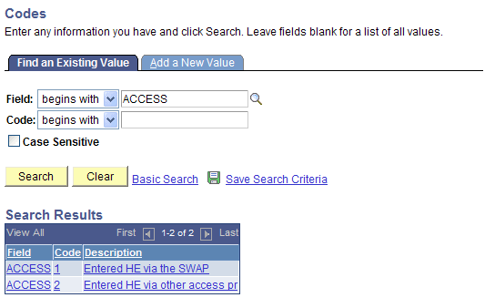

Access the Codes search page (Records and Enrollment > HESA Reporting > Codes and Mappings > Codes).
This example illustrates the fields and controls on the Codes search page. You can find definitions for the fields and controls later on this page.
Codes search page
Use the Codes search page to search for all the codes of a specific field. If required, click the Add a New Value link to manually add a code for a field.
Click the Add a New Value link or click a link in the Search Results group box to access the Codes page.
