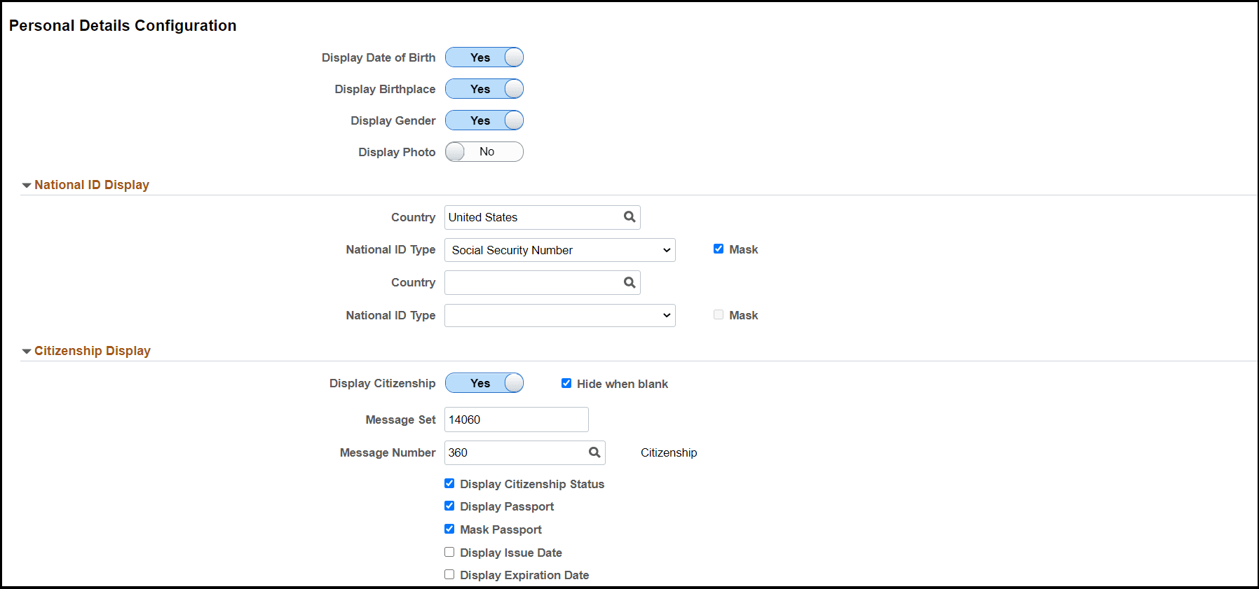

Access the Personal Details Configuration page (Set Up SACR > Common Definitions > Self Service > Campus Community > Personal Details Configuration).
This example illustrates the fields and controls on the Personal Details Configuration page 1 of 2.

You can use this page to configure how data is displayed on the Personal Details and Biographic Details pages.
Use the toggle switch to select these fields to be displayed: Date of Birth, Birthplace, Gender, or Photo fields.
Note: If you select Yes for Birthplace, the birth location, state, and country values are displayed on the Personal Details page.
Empl ID always appears on the pages. You can configure Gender as a read-only field on the Personal Details page or as a read-only or updatable field on the Biographic Details page.
National ID Display
Field or Control
Description
Country and National ID Type
Select the Country and the National ID Type to be displayed on the Personal Details page. The National ID fields are not displayed on the Personal Details page if a National ID Type is not defined, or if the user does not have an ID of the type defined.
Note: You can configure two National IDs.
For more information, see:
Mask
Select the check box to mask the first five characters of the National ID on the Personal Details page. By default, the check box is cleared and is enabled only if National ID Type has a value.
See Applying Demographic Data Access Security.
Citizenship Display
Field or Control
Description
Hide when blank
If selected, the region is hidden on the Personal Details page if there are no records to display
