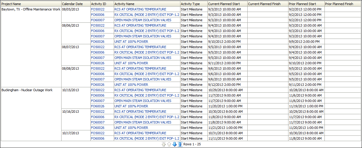

Purpose
The pivot table shows data for all milestones whose dates have changed since the previous history interval. Data is broken down and ordered by project and date. The table contains columns for:
- Project Name
- Calendar Date
- Activity ID
- Activity Name
- Activity Type
- Current Planned Start
- Current Planned Finish
- Prior Planned Start
- Prior Planned Finish
Use the up and down arrows below the table to navigate to other sections of the table. Use the double-ended arrow to view the whole table in one screen (to a maximum of 500 rows per page).
