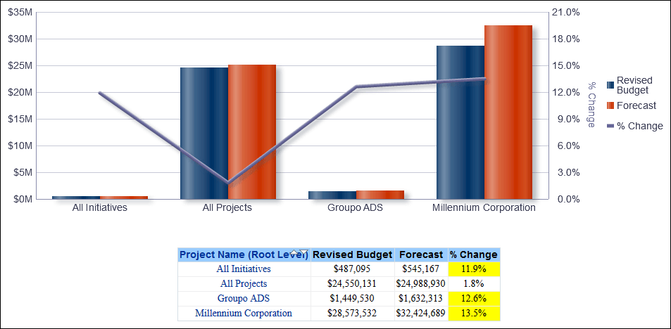

Budget vs. Forecast Section
Purpose
The line-bar chart shows bars for Revised Budget and Forecast. The line represents the change between Revised Budget and Forecast shown as a percentage.
The x-axis shows root-level projects. The y-axis for the bars (on the left) shows cost sheet values. The y-axis for the line (on the right) shows percentages.
The table contains columns for:
- Project Name (root-level)
- Revised Budget
- Forecast
- % Change (((Forecast - Revised Budget) / Revised Budget) * 100)
