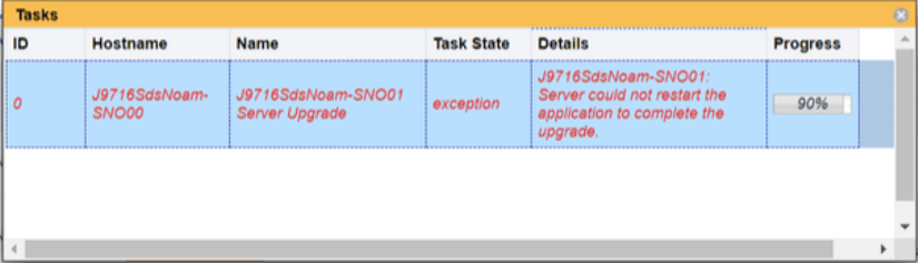

9.6 Workaround to Resolve Failed Upgrade
Error: Upgrade failed from 9.x to 9.0.2 with error: "Server could not restart the application to complete the upgrade".
Following are the steps to resolve a failed upgrade:
Figure 9-1 Failed upgrade
Failed upgrade
  1. Set Max HA Role to Active for the failed server on HA screen.
  2. Restart the server on the server screen.
