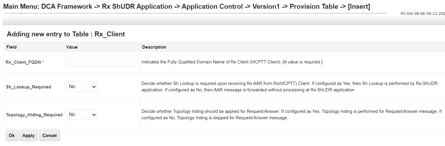

Rx_Client Table
This is the first table Application lookup when Rx Initial message is received from client.
Figure 4-1 Rx_Client Provision Table
Figure 4-2 Rx_Client Provision Table Insert Screen

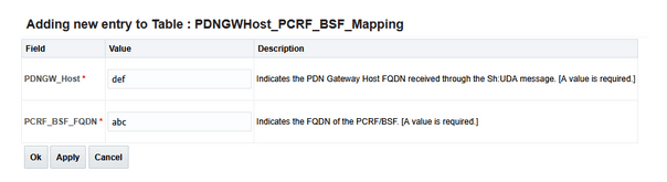

PDNGWHost_PCRF_BSF_Mapping Table
This table gets the PCRF address from PDNGW_Host received from HSS (Sh:UDA Response).
Figure 4-3 PDNGWHost_PCRF_BSF_Mapping table
Figure 4-4 PDNGWHost_PCRF_BSF Provision Table Insert Screen

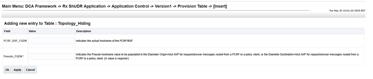

Topology_Hiding Table
This table is used when a AAA Response is reeived from PCRF/BSF, message generated from PCRF/BSF, message generated from Rx Client other than AAR Initial message for apply the topology hiding (replace the PCRF/BSF address with Pseudo FQDN).
Figure 4-5 Topology_Hiding table Provision Table
Figure 4-6 Topology_Hiding Provision Table Insert Screen

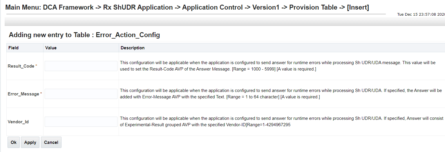

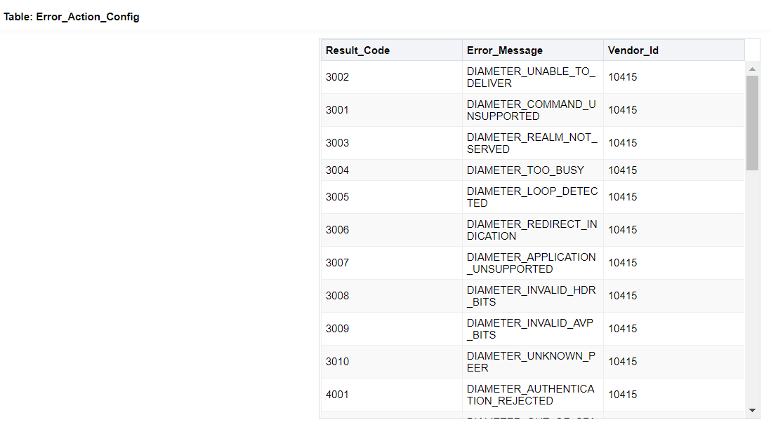

Error_Action_Config Table
This table used when non success response is received from HSS (Sh:UDA Response from HSS) to map to AAA Response (Result code, Error Message, Vendor Id).
Figure 4-7 Error_Action_Config table Provision Table
Figure 4-8 Error_Action_Config Provision Table Insert Screen

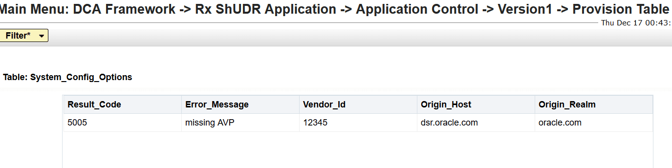

System_Config_Options Table
This table is used to configure system wide configuration that is used for Sh UDR message creation and sends the error response to Rx Client.
Figure 4-9 System Config Option table
