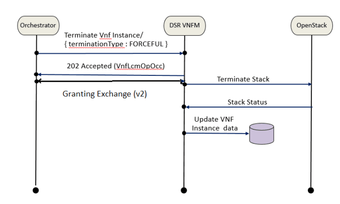

15.1 Forceful Termination
The VNFM will delete the VNF immediately after accepting the request. The instance file is updated with VNF Operational State set to STOPPED.
If the VNF is still in service, requesting forceful termination can adversely impact the network service.
Figure 15-1 Forceful termination
Terminating DSR and SDS VNF Instance Forcefully

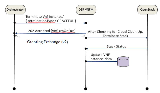

15.2 Graceful Termination
The VNFM first validates that the VNF configuration is cleaned up after accepting the request. Once the configuration is cleaned, the VNFM deletes the VNF. The instance file is updated, setting the VNF Operational State to STOPPED.
This cleanup process is automated by the VNFM for DSR, SDS Signaling, and DR NOAM from NOAM. If Appworks configuration are not cleaned up automatically by VNFM, the orchestrator's graceful termination fails.
  • VNFM must automatically clean up only the configurations which is originally applied during the DSR setup at instantiation time. Any additional configuration performed after instantiation will not be cleaned up by VNFM and must be removed by the user before initiating Graceful Termination.
  • gracefulTerminationTimeout specifies the sleep time before graceful stack termination.
Figure 15-2 Graceful termination
Sample Request for graceful termination::
Terminating VNF Instance gracefully
