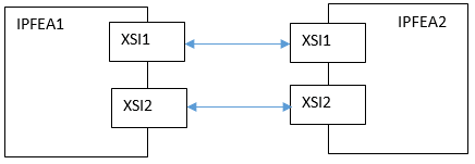

Cause:
Following is the example for the heartbeat message exchange between the IPFE mates.
img/alarm-5012.png
