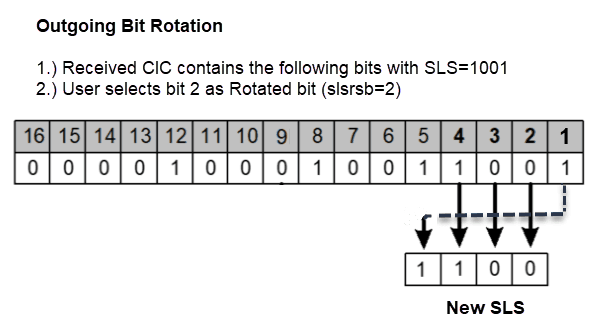

Outgoing Bit Rotation Example:
The following figure shows an example of Outgoing Bit Rotation:
Figure 2-10 Example: SLS Outgoing Bit Rotation
img/outgoing-bit-rotation-example.png
  • After the SLS is rotated then the existing algorithm for selecting a linkset and signaling link is performed and the message is sent out on the selected link. Note that the SLS is modified only for the link selection algorithm and is not modified in the outgoing message.
