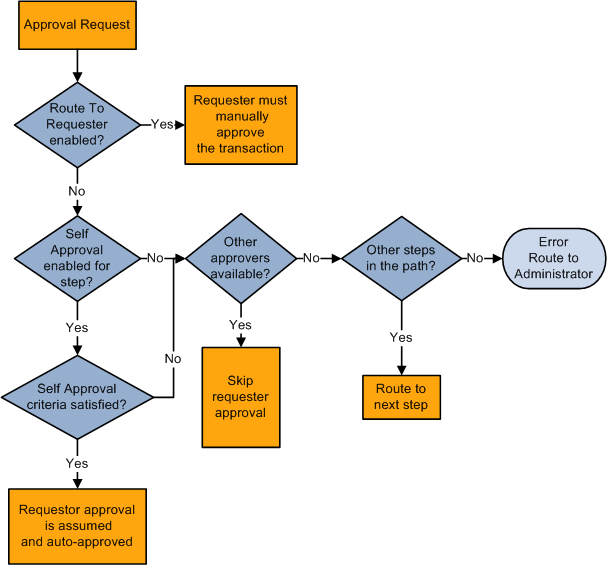

Route to Requester
Route to requester is a feature that informs the system that an approval should be sent to a requester. In some cases the requester may already be listed in the approval path. The flow of this option is also dependant on the self-approval feature as displayed in this diagram:
Image: Route to requester and self-approval feature flow
Diagram illustrating the route to requester and self-approval feature flow.
  • If route to requester is selected, the requester must always manually approve the transaction regardless of the self-approval setting.
    Note: Even if the self-approval criteria is met, the requester must manually approve the transaction.
  • If neither route to requester nor self-approval are selected, and the requester is the only approver, the system tries to identify additional steps in the path and routes the transaction to the next step if available. If no additional steps are available, it generates an error and routes the transaction to the administrator.
  • If neither route to requester nor self-approval are selected, and there are other approvers in the path, the requester approval is skipped.
  • If route to requester is not selected and self-approval is selected, the self-approval criteria are checked. If the requester meets the approval criteria, the approval is assumed and auto-approved.
    If the requester does not meet the approval criteria, and other approvers are available, the requester approval is skipped. If self approval criteria are not met and there aren’t other approvers in the same step, the system routes the transaction to the next step in the process if applicable, or to the administrator if there are no more steps in the path.
