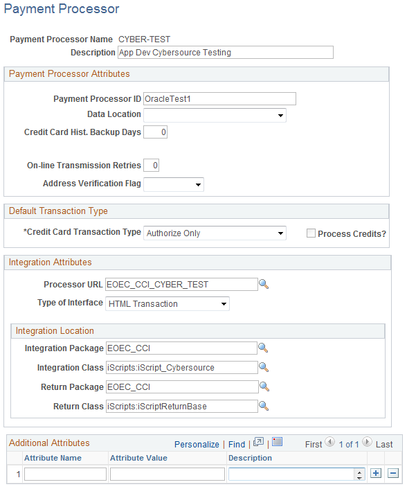

Use the Payment Processor page (EOEC_CCI_INSTAL) to define connection parameters for credit card processing calls to a third-party supplier.
Note: Before you set up credit card processing options, establish your merchant account with a third-party supplier.
Note: Check the installation documentation for the product you are installing for specific details on setting up credit card interfaces.
Image: Payment Processor page
This example illustrates the fields and controls on the Payment Processor page. You can find definitions for the fields and controls later on this page.
Verify connection requirements with your third-party supplier.
Payment Processor Attributes
Field or Control
Definition
Payment Processor ID
Enter the processor name. The Payment Processor ID should correspond to your merchant account ID with the third-party supplier.
Data Location
Select from Hosted or Local.
Credit Card Hist. Backup Days (credit card history backup days)
If you create a process that archives history records, specify the number of days that you retain credit card authorization history records.
On-line Transmission Retries
Enter a value from 0 through 9 to specify how many times the system should attempt to retransmit transactions in the event of transmission failure.
Address Verification Flag
Credit card transmissions can fail authorization if the address that you send doesn't exactly match the billing address for the credit card. Select from:
Add Ver ON (address verification on): Transactions fail when the address that you send does not match the credit card billing address. This is the default value.
Add Vf OFF (address verification off): Transactions do not fail when the address that you send does not match the billing address on the credit card.
Default Transaction Type
Field or Control
Definition
Credit Card Transaction Type
Select the types of transactions that your agents are allowed to submit. Disallowed transaction types are not available on the application-specific credit card transaction page. Select from:
Authorization Reversal: Your supplier can cancel the transaction after authorization and before payment is received. This makes the funds available if the transaction is cancelled.
Authorize Bill Subscription
Authorize Only: Your supplier verifies that the card is valid for the charge. For example, the customer has enough credit to pay for the order, the card is not stolen, and so forth. The supplier does not bill the credit card.
Authorize Subscription
Authorize and Bill: Your supplier performs both authorization and billing during the same transaction. The supplier charges the customer’s credit card on receiving authorization.
Bill Only: Your supplier bills the card without first verifying that the card is valid for the charge. Select this option if you have preauthorized the transaction and you want to submit the transaction for billing only.
Create Account
Credit Only: Your supplier credits the customer’s credit card.
Delete Account
Error
Modify Account
Retrieve Subscription
Process Credits?
Select to permit agents to submit credit transactions as well as billing transactions. This option is available only when you select Authorize and Bill or Credit Only in the Credit Card Transaction Type field.
Integration Attributes and Integration Location
The third-party supplier that you integrate with will provide you with information to connect with their systems. Enter that information to enable your PeopleSoft system to make the connection when you submit a transaction for processing.
Field or Control
Definition
Processor URL
Enter the URL identifier that corresponds to the URL for the merchant integration point. You define the URL identifier on the URL Maintenance page (select PeopleTools, then select Utilities, then select Administration, then select URLs).
Type of Interface
Select HTML Transaction or Integration Broker.
Integration Package and Integration Class
Enter the Application Package and Application Class that holds the integration iScript PeopleCode. This class must extend EOEC_CCI:iScripts:iScriptBuilderBase.
Return Package and Return Class
Enter the Application Package and Application Class that holds the iScript PeopleCode for return processing. The default class parses the URL return parameters and stores them in the Global Object.
Additional Attributes
The Additional Attributes grid contains a name/value pair attribute system for third-party supplier definitions and stores integration attributes that are not captured in the main section of the payment processor information. For example, a third-party supplier may require each integrating system to store and leverage a security script. Another possible use for the additional attributes section is to store provider-specific integration properties that you would like to customize for the Peoplesoft customer.

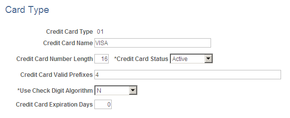

Use the Card Type page (EOEC_CCI_CARDTYPE) to define the types of credit cards you accept for credit card processing.
Image: Card Type page
This example illustrates the fields and controls on the Card Type page. You can find definitions for the fields and controls later on this page.
Card Type page
Use this page to define the types of credit cards that you accept for credit card processing.
Oracle delivers data for most popular credit card types. You can modify existing definitions and add new ones.
Field or Control
Definition
Credit Card Type
Enter a value for the credit card.
Credit Card Name
Enter a credit card name such as Visa or MasterCard. The name should match the credit card type so that you can identify the card without memorizing the credit card type codes.
Credit Card Number Length
Enter the card's standard credit card number length. Before transmitting a request to your supplier, the system validates the length of the credit card number against this number.
Credit Card Status
Select Active if you accept this type of credit card. Select Inactive if you don’t accept this type of credit card. Inactive credit card types do not appear on the application-specific credit card transaction page or in the Test Credit Card Interface component.
The default value for this field is Inactive.
Credit Card Valid Prefixes
Enter all valid prefixes for this type of credit card. Enter multiple prefixes in comma-separated format with no spaces in between. The system removes any characters other than numbers and commas when you move to another field.
Before transmitting a request to your supplier, the system validates that the credit card number starts with a valid prefix.
Use Check Digit Algorithm
Select Y (yes) to use the modulus (MOD) 10 check digit algorithm to validate credit card numbers before transmitting requests to your supplier. The MOD 10 check digit algorithm verifies whether card numbers you enter into the system are legitimate.
The default value for this field is N.
Credit Card Expiration Days
Enter a four digit numerical expiration value.

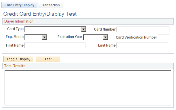

Use the Test Credit Card Interface - Card Entry/Display page (EOEC_CCI_TEST) to enter test credit card information that you can submit to verify that your credit card processing is functioning properly.
Image: Test Credit Card Interface - Card Entry/Display page
This example illustrates the fields and controls on the Test Credit Card Interface - Card Entry/Display page. You can find definitions for the fields and controls later on this page.
Use this page to enter test credit card information that you can submit to verify that your credit card processing is functioning properly.
The test that you can run on this page:
  • Verifies that the card number you enter meets the requirements defined in the Credit Card Valid Prefixes field for the associated card type on the Card Type page.
  • If you have set the Use Check Digit Algorithm field value to Y, verifies that the card number is valid based on the MOD 10 check digit algorithm.
  • Verifies that you have entered values in the Exp. Month, Expiration Year, First Name and Last Name fields on this page.

Toggle Display
Click to switch between display-only and editable modes.
Test
Click to begin the test.
Test Results
The results of the test appear in this text box. If the card number is valid, the message VALID CARD NUMBER appears. If the card number is not valid, an explanatory message appears; the card number is incorrect or the card is expired, for example.

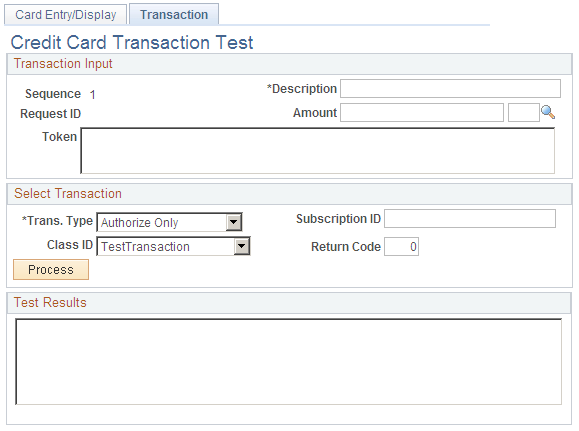

Use the Test Credit Card Interface - Transaction page (EOEC_CCI_TRANSACT) to enter test credit card transaction information that you can submit to verify that your credit card processing is functioning properly.
Image: Test Credit Card Interface - Transaction page
This example illustrates the fields and controls on the Test Credit Card Interface - Transaction page. You can find definitions for the fields and controls later on this page.
Use this page to enter test credit card transaction information that you can submit to verify that your credit card processing is functioning properly.
The test that you can run on this page verifies that your environment is set up correctly to process online credit card transactions using XML Compliant integration.

Field or Control
Definition
Sequence and Request ID
Display a combination of numbers that distinguishes the transaction from other transactions. The combination of numbers are similar to a run control or job number.
Amount
Enter a transaction amount and click the Look up button to select a transaction currency.
Token
The token is a response value that is returned from the Credit Card processing service. It is another validation that can be referenced in regards to a specific transaction.
Trans. Type (transaction type)
Choose a transaction type to test:
Auth/Bill (Authorization/Bill): Perform both authorization and billing during the same transaction.
AuthRev (Authorization Reversal): Cancel the transaction after authorization and before payment is received.
Authorize: (default value) Verify that the card is valid for the charge.
Bill: Bill the card without first verifying that the card is valid for the charge.
Credit: Credit the customer’s credit card.
Class ID
Select TestTransaction (the default) or one of the following interface types that has been specified on the Credit Card Interface Installation page.
ProcessBrokerTransaction: Select if you want to test your XML-based interface.
InterlinkTransaction: Select if you want to test your Business Interlink interface.
Process
Click to process the test transaction.
Return Code
Enter a return code to test whether proper error messages and results are returned. Available codes and their descriptions are discussed in the Return Codes section subsequently.
Test Results
The results of the transaction test appear in this text box. Test result interpretations are discussed in the following sections.
