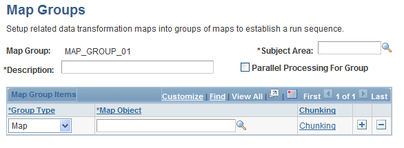

Use the Map Groups page (EOEW_GRP_DFN) to create map groups.
Image: Map Groups page
This example illustrates the fields and controls on the Map Groups page. You can find definitions for the fields and controls later on this page.
Map Groups page
Field or Control
Definition
Subject Area
Select a subject area.
For new maps groups, the subject area will be set to the default as defined on the Subject Area page.
Parallel Processing For Group
Select to run the process in parallel mode, which runs the processes simultaneously. Clear to run it in serial mode, which runs each process in the map group sequentially.
Group Type and Map Object
Select the maps and/or map groups that you want in the order in which you want them to run.
Note: Map object prompts are restricted by subject area. Only objects that are in the map group's current subject area and those in the default subject area appear.
(Optional) Chunking
Click to access the Map Group Filter page to define chunking criteria for the associated map.
See Map Group Filter Page.
Note: The Chunking link is only available for Group Types of Map. If you want to chunk a group, you need to go to that group's definition to define the criteria.

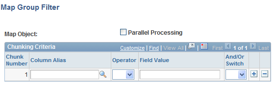

Use the Map Group Filter page (EOEW_GRP_FLTR) to define chunking criteria for maps.
Image: Map Group Filter page
This example illustrates the fields and controls on the Map Group Filter page. You can find definitions for the fields and controls later on this page.
Chunking is a mechanism that makes large amounts of processing easier through the use of multiple small parallel processes. By enabling chunking, multiple jobs are spawned from one job stream. These jobs run in parallel or serial to process data efficiently. It is an optional mechanism to help with performance. The user is responsible to define chunks that include all of the source data without duplicating any rows. The system will not verify this. The map group is still the unit of work. The group job is not complete until all of the chunks are also complete.
Field or Control
Definition
Parallel Processing
Select to run the process in parallel mode, which runs the processes simultaneously. Clear to run it in serial mode, which runs each process in the chunk sequentially.
Column Alias
Select a column alias. Available values are derived from the source data object for the map you are currently chunking.
Operator
Select an operator to define the chunking condition.
Field Value
Enter the field value that completes criteria for the chunk number.
And/Or Switch
Select And or Or to compound multiple sets of criteria.
Note: The chunks you define must be configured to capture all of the source data without duplicating rows.
