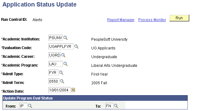

Access the Application Status Update page (select Student Admissions, then select Processing Applications, then select Update Applications, then select Application Status Update).
Image: Application Status Update page
This example illustrates the fields and controls on the Application Status Update page. You can find definitions for the fields and controls later on this page.
Field or Control
Definition
Evaluation Code
Enter an evaluation code. The process only processes the applications that have the evaluation code that you select. Define evaluation codes on the Evaluation Table page.
Academic Career
Enter an academic career. The process only processes the applications that have the academic career that you select. This is the academic career to which that the applicant is applying.
Academic Program
Enter an academic program. The process only processes the applications that have the academic program that you select.
Admit Type
Enter an admit type. The process only processes applications that have the admit type that you select. Define admit types on the Admit Type Table.
Admit Term
Enter an admit term. The process only processes the applications that have the admit term that you select. Define admit terms on the Term Values Table page.
Action Date
The default for the action date is your system date. Edit this date to reflect the date you want to appear as the action date on the Application Program Data page.
From
The process only process applications that have the evaluation status you select.
To
Enter the program evaluation status that you want the process to add to the applications on the Application Program Data page.
Click the Run button to run the Program Stack Update process at user-defined intervals.
To view the results of this application program evaluation status update process, you can use the Applicant Progression page, or you can go to an individual's Application Program Data page in the Application Maintenance component.

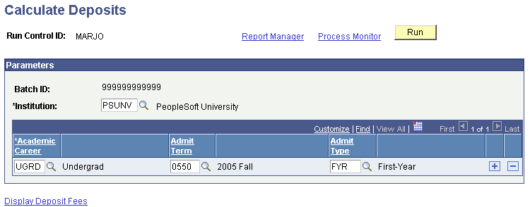

Access the Calculate Deposits page (select Student Admissions, then select Application Fees and Deposits, then select App Deposit Fees Process).
Image: Calculate Deposits page
This example illustrates the fields and controls on the Calculate Deposits page. You can find definitions for the fields and controls later on this page.
Field or Control
Definition
Academic Career
Enter an academic career. The process only calculates enrollment deposits for applications that have the academic career that you select.
Admit Term
Enter an admit term. The process only calculates enrollment deposits for applications that have the admit term that you select. Define admit terms on the Term Values Table page.
Admit Type
Enter an admit type. The process only calculates enrollment deposits for applications that have the admit type that you select. Define admit types on the Admit Type Table page.
You can add additional rows as needed for selecting additional careers, admit terms etc. to calculate deposits for multiple groups of applicants. Click the Run button to run the Deposit Fees Calc (Batch) [deposit fees calculation (batch)] process at user-defined intervals.
To view the results of the Deposit Fees Calc (Batch) process for applicants, use the Display Deposit Fees link on the Run Control page or the Review Batch Deposit Fees page.

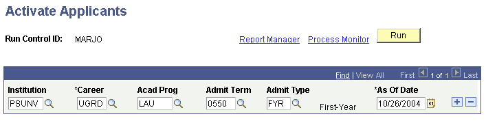

Access the Activate Application page (select Student Admissions, then select Processing Applications, then select Update Applications, then select Activate Applicants).
Image: Activate Applicants page
This example illustrates the fields and controls on the Activate Applicants page. You can find definitions for the fields and controls later on this page.
Note: Admissions application records use the Last Admit Term to determine if the program, plan, or subplan should appear in the prompt. If the Last Admit Term is populated on the Academic Program Table (ACAD_PROG_TBL), Academic Plan Table (ACAD_PLAN_TBL), or Academic SubPlan Table (ACAD_SBPLN_TBL) and the term is less than or equal to the term selected for the ID, the system does not display the value in the prompt.
Field or Control
Definition
Career
Enter an academic career. The process only matriculates applicants who have the academic career that you select.
Acad Program (academic program)
Enter an academic program. The process only matriculates applicants who have the academic program that you select.
Admit Term
Enter an admit term. The process only matriculates applicants who have the admit term that you select. Define admit terms on the Term Values Table page.
Admit Type
Enter an admit type. The process only matriculates applicants who have the admit type that you select. Define admit types on the Admit Type Table page.
As of Date
The default for the as of date is your system date. This is the date you ran this process.
Add additional rows as needed to define additional selection criteria. Click the Run button to run the Activate Applications process at user-defined intervals.
