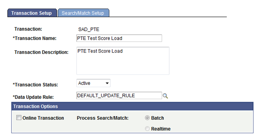

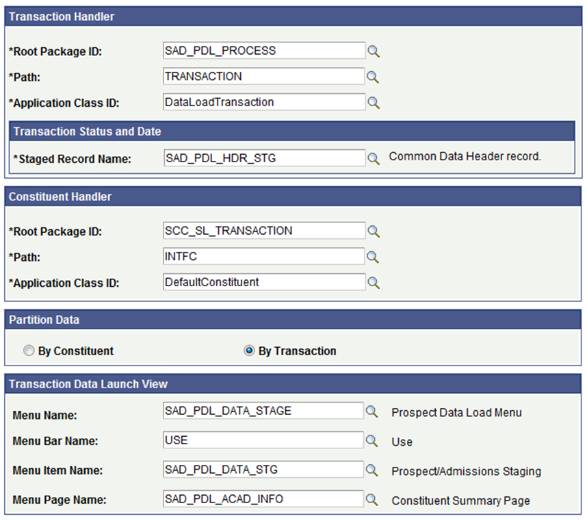

You must define a transaction for each PDL transaction you will be loading. For each prospect or test score template Oracle delivers, transaction codes are also delivered.
Image: Sample Transaction Setup for Prospect/Admissions Data Load (1 of 2)
This is an example of a delivered transaction code (1 of 2).
Image: Sample Transaction Setup for Prospect/Admissions Data Load (2 of 2)
This is an example of a delivered transaction code (2 of 2).
All PDL transactions should be set up with the Online Transaction check box cleared which sets the Process Search/Match option to Batch automatically.
The following table lists the delivered transaction handler values for Prospect/Admissions Data Load transactions. Use these values when defining a transaction handler for any new PDL transaction you may define.
Root Package ID
Path
Application Class ID
SAD_PDL_PROCESS
TRANSACTION
DataLoadTransaction
The staging record name for PDL Transaction Status and Date should be set to SAD_PDL_HDR_STG. This record stores the transaction status and transaction status date value for PDL transactions. You should always use this value when defining any new PDL transaction.
The following table lists the delivered transaction handler values for processing the constituent data that is loaded with your PDL transaction. Use these values when defining a constituent handler for any new PDL transaction you define.
Root Package ID
Path
SCC_SL_TRANSACTION
INTFC
DefaultConstituent
All PDL transactions should be set to Partition by Transaction which creates one transaction record for each constituent record.
The following table lists the delivered transaction data launch view settings for PDL transactions. You should always use these values when defining the transaction data launch view settings for any new PDL transaction you may create.
Menu Name
Menu Bar Name
Menu Item Name
Menu Page Name
SAD_PDL_DATA_STAGE
USE
SAD_PDL_DATA_STG
SAD_PDL_ACAD_INFO

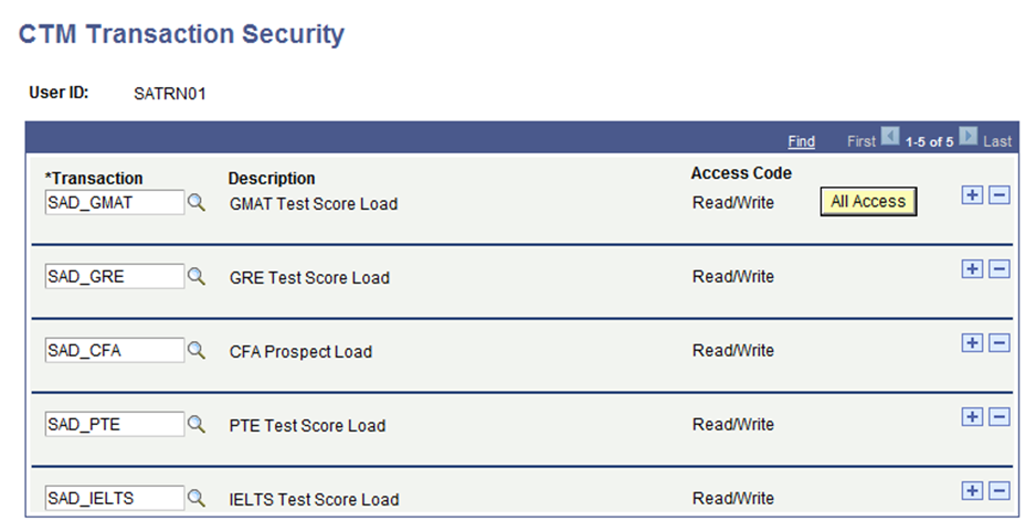

Access the CTM Transaction Security page (select Set Up SACR, then select Security, then select Secure Student Administration, then select User ID, then select CTM Transaction Security).
Image: CTM Transaction Security page
This example illustrates the fields and controls on the CTM Transaction Security page.
CTM (Constituent Transaction Management) Transaction Security page for PDL (Prospect/Admissions Data Load)
The CTM Transaction Security page controls access to the Prospect/Admissions Staging and Constituent Staging components under the Student Recruiting, Prospect/Admissions Data Mgmt menu.
For more information about the CTM Transaction Security page:
See Setting Up CTM Transaction Security

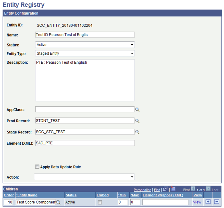

The system automatically creates an entity for a new test ID that you add through the Test Tables component.
This is an example of the entity registry record that the system creates for the PTE test:
Image: Entity Registry Example for PTE
This image illustrates an Entity Registry example for PTE.
Entity Registry Example for PTE (Pearson Test of English)
The system will assign a unique entity ID to each test ID that you set up. The Test Tables page will also display this entity ID. The name assigned for each Test ID Entity will use the following name convention <Test ID> <Description from Test Table>. The Description for each Test ID Entity will use the following naming convention <Value entered for Test ID>: <Description from Test Table>.

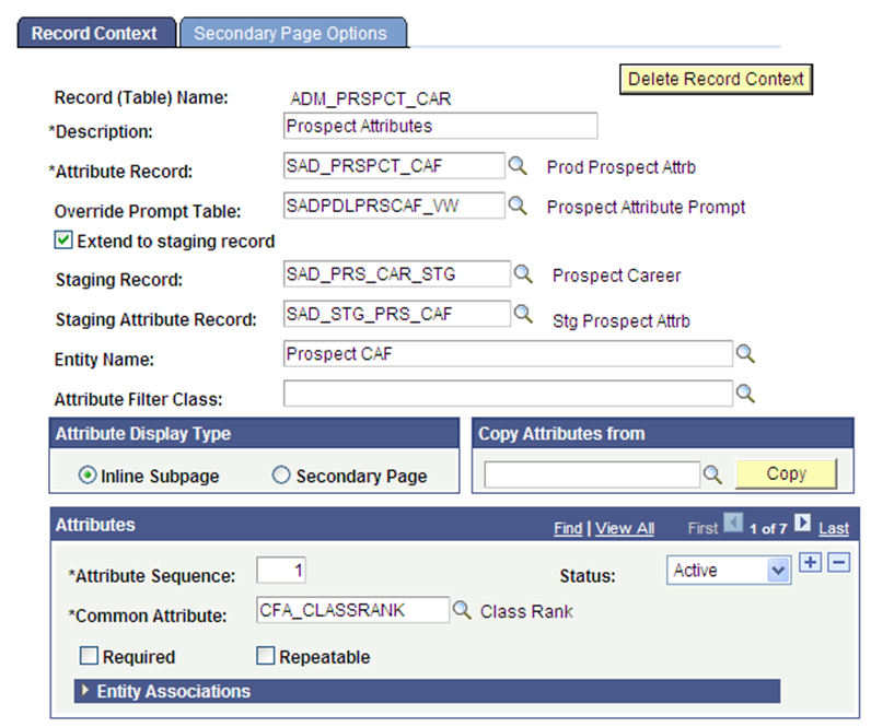

PDL is leveraging the Common Attribute Framework to enable you to store additional data loaded from external data sources for test scores and prospects. Examples have been delivered but you may choose to add additional attributes for the data you are loading.
For extending prospect career data, a record context has been delivered for ADM_PRSPCT_CAR and its corresponding staging record SAD_PRS_CAR_STG.
Image: Record Context for Prospect Career
This example illustrates the record context for prospect career.
For additional data you want to store for your prospect, define a common attribute and add it to the ADM_PRSPCT_CAR record context.
To add common attributes to the ADM_PRSPCT_CAR record context:
  1. Access the Record Context search page (select Set Up SACR, then select Common Definitions, then select Common Attributes Setup, then select Record Context).
  2. Enter Record (Table) Name = ADM_PRSPCT_CAR.
  3. Click Search.
  4. In the Attributes section, add a row and populate the Common Attribute field for each common attribute. Add a new row for each common attribute.
  5. Click Save.
Note: The “Delivered PDL Templates” section lists the common attributes delivered for each template. The CFA attributes have already been added to ADM_PRSPCT_CAR. Add the remaining attributes to ADM_PRSPCT_CAR for the templates you are planning to use.
See Delivered PDL Templates

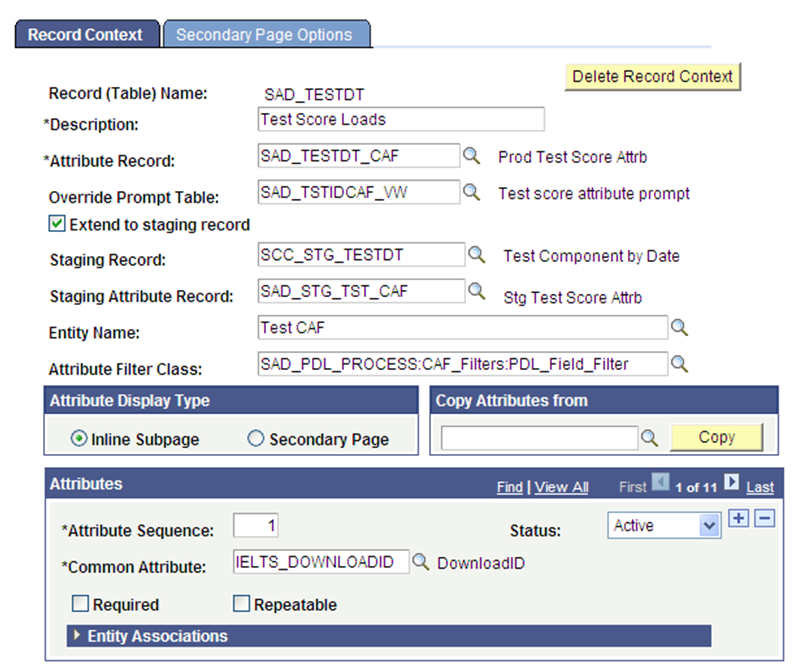

To allow you to store additional test score data by test date, a record context has been delivered for SAD_TESTDT and its corresponding staging record SCC_STG_TESTDT.
Image: Record Context for Test Date
This example illustrates the record context for test date.
For additional data you want to store for your specific test, define a common attribute and add it to the SAD_TESTDT record context. To add common attributes to the SAD_TESTDT record context:
2. Enter Record (Table) Name = SAD_TESTDT.
3. Click Search.
5. Click Save.
Note: The “Delivered PDL Templates” section lists the common attributes delivered for each template. The IELTS and PTE attributes have already been added to SAD_TESTDT. Add the remaining attributes to SAD_TESTDT for the templates you are planning to use.

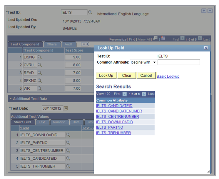

For each of the attributes you have added to the record context for SAD_TESTDT, you need to add the Test ID that corresponds to the attribute. Doing so will then filter those attributes in the field search results for that Test ID in the:
  • Test Results group box of the Prospect/Admissions Staging - Academic Information page.
  • Test Results pages.
This is an example of the Test Results group box when the user clicks the lookup button for Field in Additional Test Values:
Image: Example of filtering based on Test ID in the Academic Information page
This image illustrates an example of filtering based on Test ID in the Academic Information page.

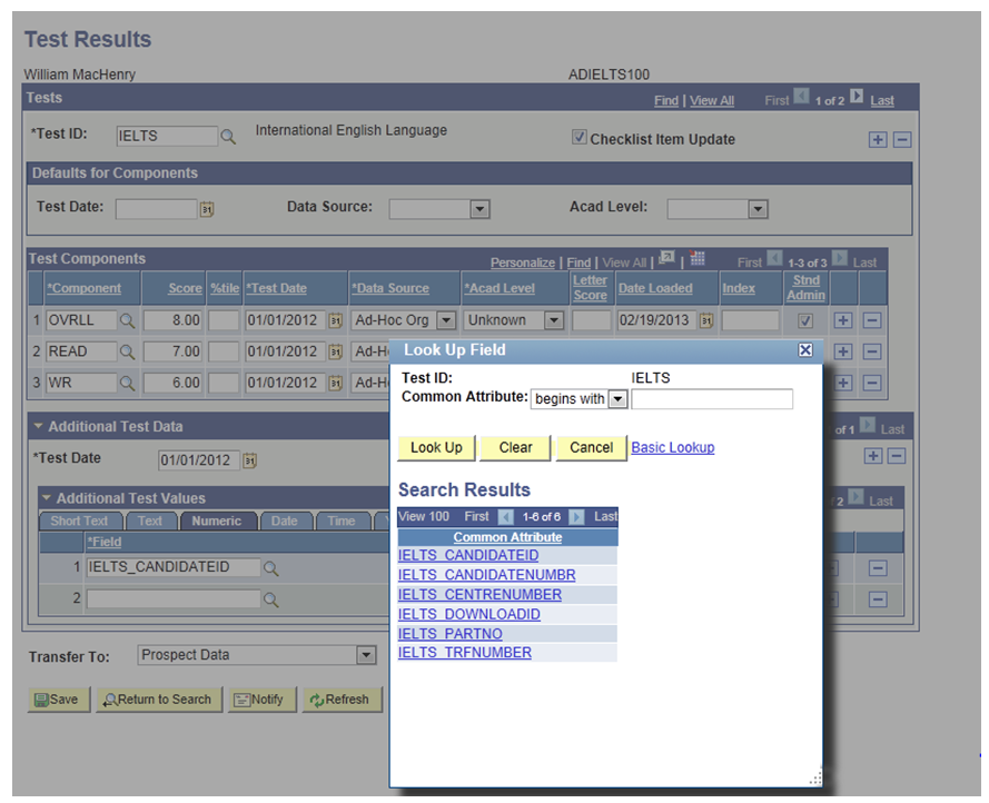

This is an example of the Test Results page when the user clicks the lookup button for Field in Additional Test Values:
Image: Example of filtering based on Test ID in the Test Results page
This image illustrates an example of filtering based on Test ID in the Test Results page.

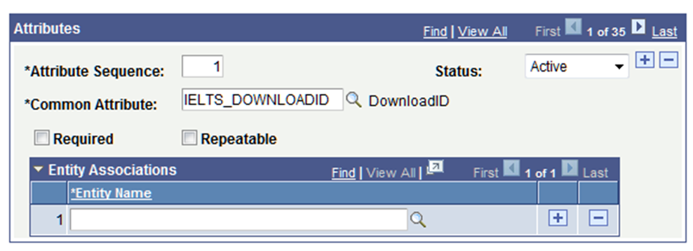

  5. Expand the Entity Associations group box. The group box should look like this:
    Image: Entity Associations group box
    This example illustrates the Entity Associations group box.
    Entity Associations

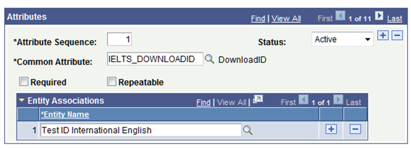

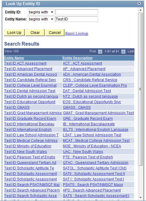

  6. For each of the Attributes defined to the record SAD_TESTDT, add the Entity Name that corresponds to the value in the Common Attribute field. Entering Test ID in the Entity Name field and clicking the lookup icon displays the results as shown in the following graphic:
    Image: Lookup results for the Entity Name field
    This example illustrates the Lookup results for the Entity Name field.
  7. For all those attributes prefaced with IELTS, add the Entity Name Test ID International English:
    Image: Entity Name for IELTS
    This example illustrates the Entity Name for IELTS.
    Entity Name for IELTS (International English Language Testing System)
  8. Repeat the above step for the remaining attributes.
    Note: Remember to use the correct Entity Name that corresponds to those common attributes.

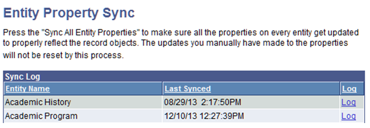

  9. Save your changes. When you save the changes, the system displays this message:
    Please run Entity Property Sync process to update corresponding Entity Registry definitions. (14097, 56)
    The record context data has changed. To keep corresponding Entity Registry definitions in sync please run the Entity Property Sync process (Home > Setup SACR > System Administration > Entity > Entity Property Sync)
  10. In order for these changes to take full effect, you must complete the next steps and run both the Entity Registry Sync and Cache Wipe processes.

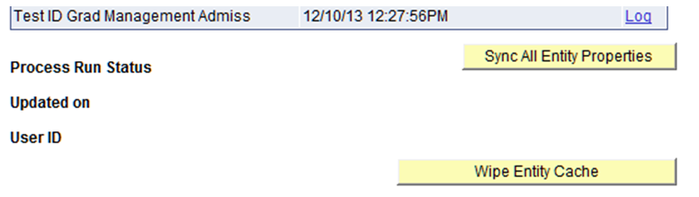

  11. Navigate to the Entity Property Sync component (select Set Up SACR, then select System Administration, then select Entity, then select Entity Property Sync).
    Image: Entity Property Sync component (1 of 2)
    This example illustrates the Entity Property Sync component (1 of 2).
    Entity Property Sync page (1 of 2) - Prospect/Admissions Data Load example
    Image: Entity Property Sync component (2 of 2)
    This example illustrates the Entity Property Sync component (2 of 2).
    Entity Property Sync page (2 of 2) - Prospect/Admissions Data Load example
  12. Click the Sync All Entity Properties button.
  13. Clicking this button will initiate an Application Engine process that should take 5 - 10 minutes to complete. Clicking the Refresh button will update the status of the Application Engine process (that is, Queued, Processing, Success).

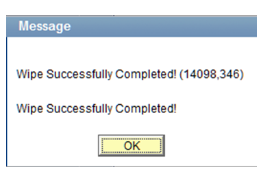

  14. Once the process has completed successfully, click the Wipe Entity Cache button. This should take between 3 - 5 minutes to complete. Upon completion, you should see the following message:
    Image: Confirmation message for Wipe Entity Cache process
    This example illustrates the confirmation message for Wipe Entity Cache process.
    Confirmation for Wipe Entity Cache process
  15. When the Wipe Entity Cache process has completed, you have successfully completed updating the common attributes for test scores.
Note: If common attributes are changed, added or deleted, run the Entity Property Sync process (select Set Up SACR, then select System Administration, then select Entity, then select Entity Property Sync) to keep the corresponding Entity Registry definitions in sync.
