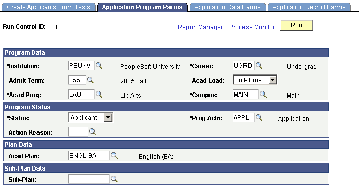

Access the Application Program Parms (application program parameters) page (select Student Admissions, then select External Test Score Processing, then select Create Applicants from Tests, then select Application Program Parms).
Image: Application Program Parms page
This example illustrates the fields and controls on the Application Program Parms page. You can find definitions for the fields and controls later on this page.
Note: Some of the fields on this page might populate automatically according to your user defaults. You can edit those fields as needed.
Field or Control
Definition
Admit Term
Enter the admit term for these applicants. Define admit terms on the Term Values Table page.
Acad Load (academic load)
Select the academic load for these applicants. Values for this field are delivered with your system as translate values. You can modify these translate values.
Acad Program (academic program)
Enter the academic program for these applicants. Only the academic programs for the chosen career appear in the prompt list. Define academic programs on the Academic Program Table page.
Campus
Enter the campus being applied to within your institution. Define campuses on the Campus Table page.
Status
Select the person's program status. This value is entered on the application. Values for this field are delivered with your system as translate values. Field values are delivered with your system as translate values. Do not modify these values in any way. Any modifications to these values require a substantial programming effort.
Prog Actn (program action)
Enter the program action that you want entered regarding the program on these applications. Because the intent of this process is to create applications, not all program actions are available when you prompt on this field. Program actions are stored on the Program Action Table page.
Action Reason
If there are action reasons associated with the program action that you selected, you can enter the appropriate reason value. Define action reasons on the Action Reason Table page.
Acad Plan (academic plan)
Enter an academic plan for these applications. Define academic plans on the Academic Plan Table page.
Sub-Plan
Enter a subplan for these applications. Define academic subplans on the Academic Sub-Plan Table page.

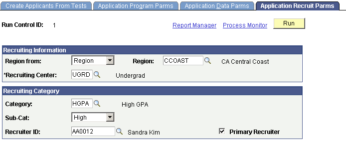

Access the Application Recruit Parms (application recruit parameters) page (select Student Admissions, then select External Test Score Processing, then select Create Applicants from Tests, then select Application Recruit Parms).
Image: Application Recruit Parms page
This example illustrates the fields and controls on the Application Recruit Parms page. You can find definitions for the fields and controls later on this page.
Application Recruit Parms (parameters) page
Field or Control
Definition
Region from
Select how you would like the region to be assigned to these applications. Values are School, Address, and Region.
School: Not a valid choice. You will get an error message if you enter this value.
Address: Select this value if you want the system to automatically assign a region to these applications according to the applicant's home address.
If you select Address, the Region field is not available because the system will assign the region based on the person's home address or the address of the last school attended.
Region: Select this value if you prefer to choose a region here to be entered on all applications.
Region
Enter a region to be entered on these applications. This field is available only when you enter Region in the Region from field. It is automatically assigned when Address is entered. Define regions on the Region Tree page.
Recruiting Center
If you have indicated in your installation setup that you want prospect records to be created for applications that come in without existing matching prospect records, you must enter a recruiting center here to be added to the new prospect record. Define recruiting centers on the Recruiting Center Table page.
Category
Enter a recruiting category If you want a recruiting category entered on these applications. The recruiting categories available are based on the academic career that you selected.
Sub-Category
Select a recruiting subcategory for these applications (optional). Subcategories indicate your level of interest in the applicant. Values for this field are delivered with your system as translate values. You can modify these translate values. Values are High,Low, and Medium.
Recruiter ID
If you have entered a recruiting category and you want a recruiter assigned to these applications under the chosen category, enter the recruiter identification number in this field. Only recruiters assigned to this academic career are available.
Primary Recruiter
Select this check box if you want the recruiter that you selected to be the primary recruiter for these applications.
