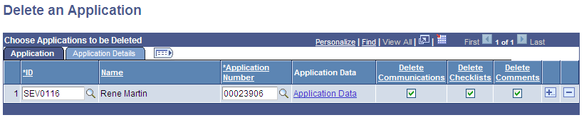

Access the Delete an Application page (select Student Admissions, then select Application Delete, then select Delete an Application).
Image: Delete an Application page: Application tab
This example illustrates the fields and controls on the Delete an Application page: Application tab. You can find definitions for the fields and controls later on this page.
Field or Control
Definition
ID
Enter the ID of the person for whom you want to delete an application.
Application Number
After you enter the ID, select the application that you want to delete.
Application Data
Click this link to access the Maintain Applications component in a new window.
Delete Communications Delete Checklists and Delete Comments
For each application, select the 3Cs, if any, that you want to delete.
Application Details

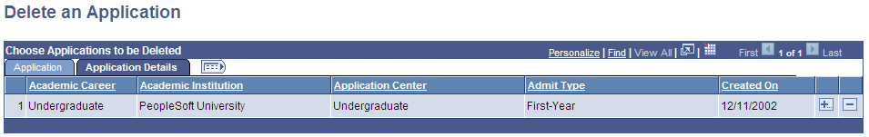

Select the Application Details tab.
Image: Delete an Application page: Application Details tab
This example illustrates the fields and controls on the Delete an Application page: Application Details tab. You can find definitions for the fields and controls later on this page.
View further information about the records that you have selected.
When you save the page, the selected records are inserted into the Application Delete Holding table, where they are stored until you run the Application Delete process. If you enter an ID and Application Number for an application for which a record already exists in the holding table, you will receive an error message and you will not be able to add the application.

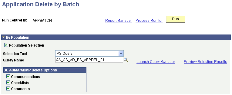

Access the Application Delete by Batch page (select Student Admissions, then select Application Delete, then select Application Delete by Batch).
Image: Application Delete by Batch page
This example illustrates the fields and controls on the Application Delete by Batch page. You can find definitions for the fields and controls later on this page.
3C ADMA/ADMP Delete Options
Select the 3Cs, if any, that you want to delete. Your selection will apply to all application records in the group. You can update 3C information for individual records in the group by accessing the Application Delete Holding table after you run the process.
Running the Process
Click Run to run the Application Delete by Batch Application Engine (SAD_APP_DEL) process using the PeopleSoft Process Scheduler. This process inserts all the selected records into the Application Delete Holding table if they do not already exist there.
Once the process runs successfully, view the message log to confirm how many records were selected (SAD_APP_DEL_TGT ) and how many records were inserted into the holding table (ADM_APP_DELC).

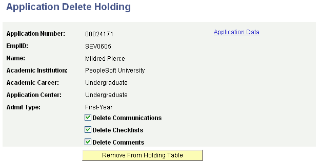

Access the Application Delete Holding page (select Student Admissions, then select Application Delete, then select Application Delete Holding).
Image: Application Delete Holding page
This example illustrates the fields and controls on the Application Delete Holding page. You can find definitions for the fields and controls later on this page.
The Application Delete Holding table contains all the records that you have selected for deletion, whether individually or in a group. Review these records before you run the Application Delete process.
You can:
  • Use the check boxes to select different 3C options for an application.
  • Click the Remove From Holding Table button to remove a record from the holding table if you no longer want to delete that record.
Click the Application Data link to access the Maintain Applications component, where you can view additional applicant information and determine whether to remove a record from the holding table.
