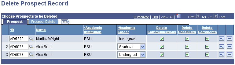

Access the Delete Prospect Record page (select Student Recruiting, then select Delete Prospects, then select Delete Prospect Record).
Image: Delete Prospect Record page: Prospect tab
This example illustrates the fields and controls on the Delete Prospect Record page: Prospect tab. You can find definitions for the fields and controls later on this page.
Enter a value in the ID field. If only one prospect record exists, the institution and career will appear automatically. If a prospect has multiple institution or career records, you must enter a row for each record that you want to delete.
For each prospect record, select the 3Cs, if any, that you want to delete.

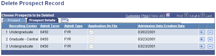

Select the Prospect Details tab.
Image: Delete Prospect Record page: Prospect Details tab
This example illustrates the fields and controls on the Delete Prospect Record page: Prospect Details tab. You can find definitions for the fields and controls later on this page.
View additional information about the records that you have selected on this page.
When you save this page, the selected records are inserted into the Prospect Delete Holding table, where they are stored until you run the Prospect Delete process. If you enter an ID for a prospect for which a record already exists in the holding table, you will receive an error message and will not be able to add the prospect.

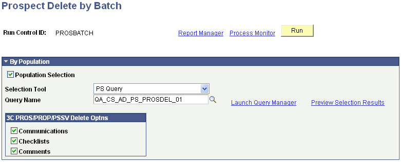

Access the Prospect Delete by Batch page (select Student Recruiting, then select Delete Prospects, then select Prospect Delete by Batch).
Image: Prospect Delete by Batch page
This example illustrates the fields and controls on the Prospect Delete by Batch page. You can find definitions for the fields and controls later on this page.
3C PROS/PROP/PSSV Delete Optns (3C PROS/PROP/PSSV delete options)
Select the 3Cs, if any, that you want to delete. Your selection will apply to all prospect records in the group. You can update the 3C information for individual records in the group by accessing the Prospect Delete Holding table after you run the process.
Running the Process
Click Run to run the Prospect Delete by Batch Application Engine (SAD_PRS_DEL) process using the PeopleSoft Process Scheduler. This process inserts all the selected records into the Prospect Delete Holding table if they do not already exist there.
Once the process runs successfully, view the message log to confirm how many records were selected (SAD_PRS_DEL_TGT) and how many records were inserted into the holding table (ADM_PRS_DELC).

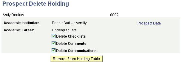

Access the Prospect Delete Holding page (select Student Recruiting, then select Delete Prospects, then select Prospect Delete Holding).
Image: Prospect Delete Holding page
This example illustrates the fields and controls on the Prospect Delete Holding page. You can find definitions for the fields and controls later on this page.
The Prospect Delete Holding table contains all the records that you have selected for deletion, whether individually or in a group. Review these records before you run the Prospect Delete process.
You can:
  • Use the check boxes to select different 3C options for a prospect.
  • Click the Remove From Holding Table button to remove a record from the holding table if you no longer want to delete that record.
Click the Prospect Data link to access the Create/Update Prospects component, where you can view additional prospect information and determine whether to remove a record from the holding table.
