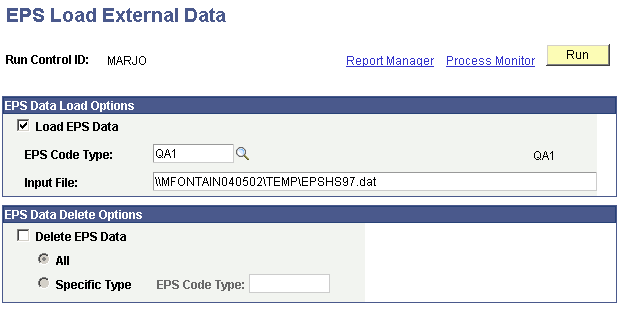

Access the EPS Load External Data page (select Campus Community, then select Organization, then select Organizations Data Load, then select EPS Load External Data).
Image: EPS Load External Data page
This example illustrates the fields and controls on the EPS Load External Data page. You can find definitions for the fields and controls later on this page.
EPS Data Load Options
Field or Control
Definition
Load EPS Data
Select to add EPS data to your system. You must select either the Load EPS Data check box or the Delete EPS Data check box.
EPS Code Type
Select the EPS code type that you want to load. Only EPS code types that you defined on the Ext Org Code Type Table page are available for selection.
Input File
Enter the drive, directory, and filename path where the EPS market code external data resides.
EPS Data Delete Options
Field or Control
Definition
Delete EPS Data
Select if you want to delete EPS data. You might perform this action, for example, if you want to remove the previous year's version of the EPS data.
All
Select to remove all EPS data.
Specific Type and EPS Code Type
Select Specific Type to delete a specific EPS data type. Then choose an EPS Code Type.
Click the Run button to run the EPS External Load process at user-defined intervals. The process name is CCEPSLOD and the process type is SQR Report.
