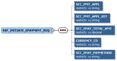

Input Message: SSF_INITIATE_EPAYMENT_REQ
Image: SSF_INITIATE_EPAYMENT_REQ Message Parameters
This image shows the input parameters that the SSF_INITIATE_EPAYMENT service operation receives from an online application.
Required data that the online application must supply to the service operation:

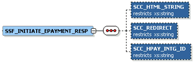

Output Message: SSF_INITIATE_EPAYMENT_RESP
When the Integration Broker receives the SSF_INITIATE_EPAYMENT_REQ message, it responds with the SSF_INITIATE_EPAYMENT_RESP message.
Image: SSF_INITIATE_EPAYMENT_RESP Message Parameters
This image shows the output parameters that the SSF_INITIATE_EPAYMENT service operation passes to the online application.
The following is an example of the SSF_INITIATE_EPAYMENT_RESP message that the SSF_INITIATE_EPAYMENT service operation transmits to the online application:

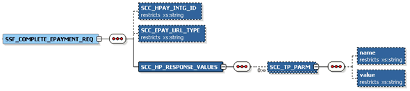

Input Message: SSF_COMPLETE_EPAYMENT_REQ
Image: SSF_COMPLETE_EPAYMENT_REQ Message Parameters
This image shows the input parameters that the SSF_COMPLETE_EPAYMENT service operation receives from an online application.
  • Hosted Payment Adapter ID.
  • Return URL Type (Success, Cancelled, Error).

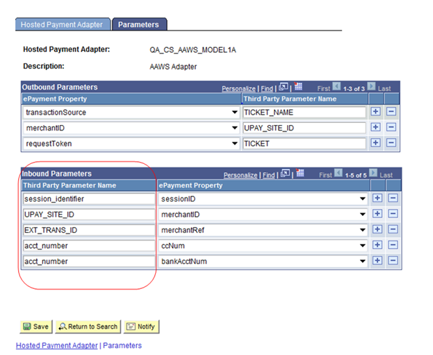

  • Hosted Payment Response Values (Name/Value pairs returned from third party). These values are expected to correspond to the values under the Third Party Parameter Name of Inbound Parameters grid of Hosted Payment Adapter Setting. For example:
    Image: Hosted Payment Adapter Setting Example
    This example illustrates a Hosted Payment Adapter setting.

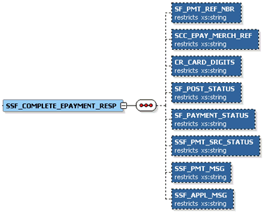

Output Message: SSF_COMPLETE_EPAYMENT_RESP
When the Integration Broker receives the SSF_COMPLETE_EPAYMENT_REQ message, it responds with the SSF_COMPLETE_EPAYMENT_RESP message.
Image: SSF_COMPLETE_EPAYMENT_RESP Message Parameters
This image shows the output parameters that the SSF_COMPLETE_EPAYMENT service operation passes to the online application.
The following is an example of the SSF_COMPLETE_EPAYMENT_RESP message that the SSF_COMPLETE_EPAYMENT service operation transmits to the online application:
