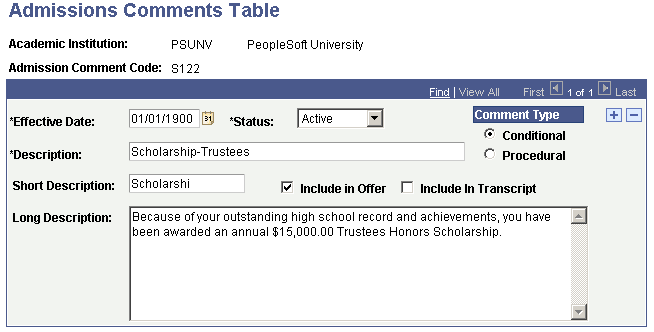

Access the Admissions Comments Table page (select Set Up SACR, then select Product Related, then select Recruiting and Admissions, then select Application Evaluation, then select Admissions Comments Table).
Image: Admissions Comments Table page
This example illustrates the fields and controls on the Admissions Comments Table page. You can find definitions for the fields and controls later on this page.
Field or Control
Definition
Comment Type
Indicates the type of comment that you are entering. Select Conditional if the comment is a condition for admission, and Procedural if the comment is for procedure only. (informational only)
Include In Offer
Select this check box to include the code, description, short description, and long description on the applicant's admission offer letter. When you select this check box, the system automatically selects the Include in Offer check box on the Admission Comments page.
Include In Transcript
Select this check box to include the code and long description on the student's transcript. When you select this check box, the system automatically selects the Include in Transcript check box on the Admission Comments page.
Long Description
Enter the full text of the comment for this admission comment code. The long description appears by default on the Admission Comment page after you assign this code to the applicant.

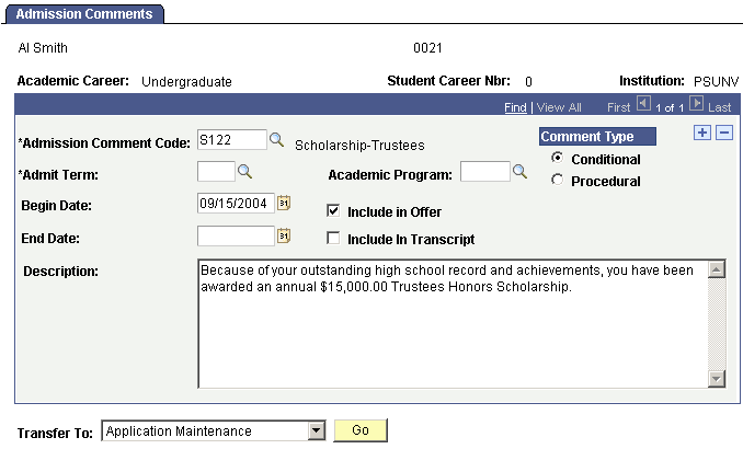

Access the Admission Comments page (select Student Admissions, then select Application Evaluations, then select Application Decisions, then select Admission Comments).
Image: Admission Comments page
This example illustrates the fields and controls on the Admission Comments page. You can find definitions for the fields and controls later on this page.
Field or Control
Definition
Admission Comment Code
Enter a code. Define comment codes on the Admission Comment Table page.
Admit Term
Enter an admit term. If an applicant was admitted to more than one academic program, he or she can have multiple admit terms.
Academic Program
Enter an academic program. Applicants can be admitted to multiple academic programs. (optional)
Comment Type
Begin Date
The default for the begin date is your system date.
End Date
Enter the date from which you want this comment to be no longer valid. If you run the offer letter after this date it will not appear even if you have selected the Include in Offer check box.
Include in Offer
Select this check box to include the code, description, short description, and long description on the applicant's admission offer letter. The system automatically selects this check box if the Include in Offer field on the Admission Comment Table page is selected. You can change the setting for this applicant here.
Select this check box to include the code and long description on the student's transcript. The system automatically selects this check box if the Include in Transcript field on the Admission Comment Table page is selected. You can change the setting for this applicant here.
Long Description
The long description appears from the Admission Comment Table page. You can change the long description for this applicant here.
